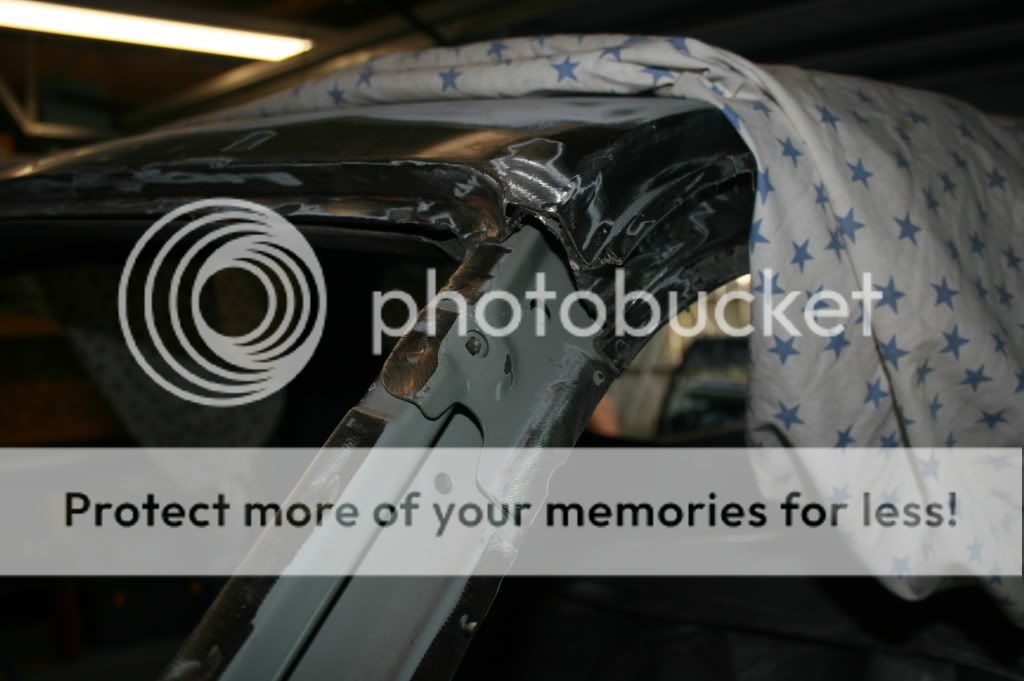

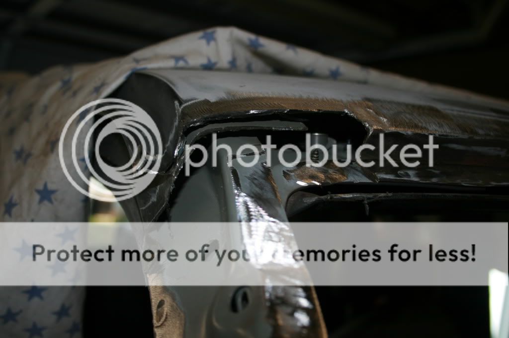

Last time I left off, we were waiting for the glass guy to come take the windshield out. He kept dicking Josh around, but another dude finally came and got it done.

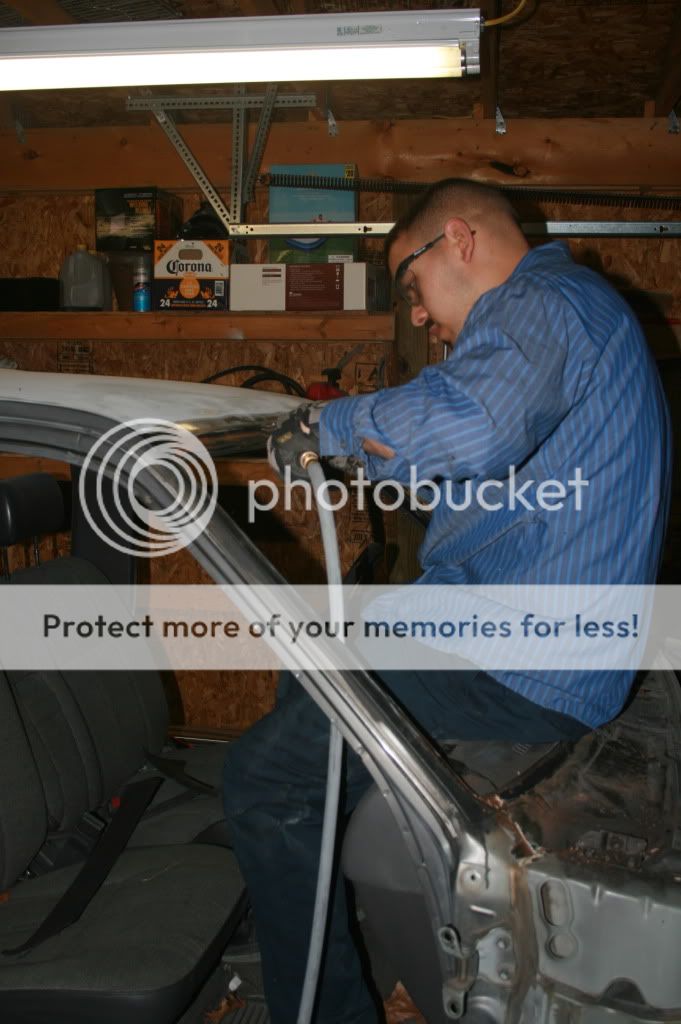

Josh, prepping the surface

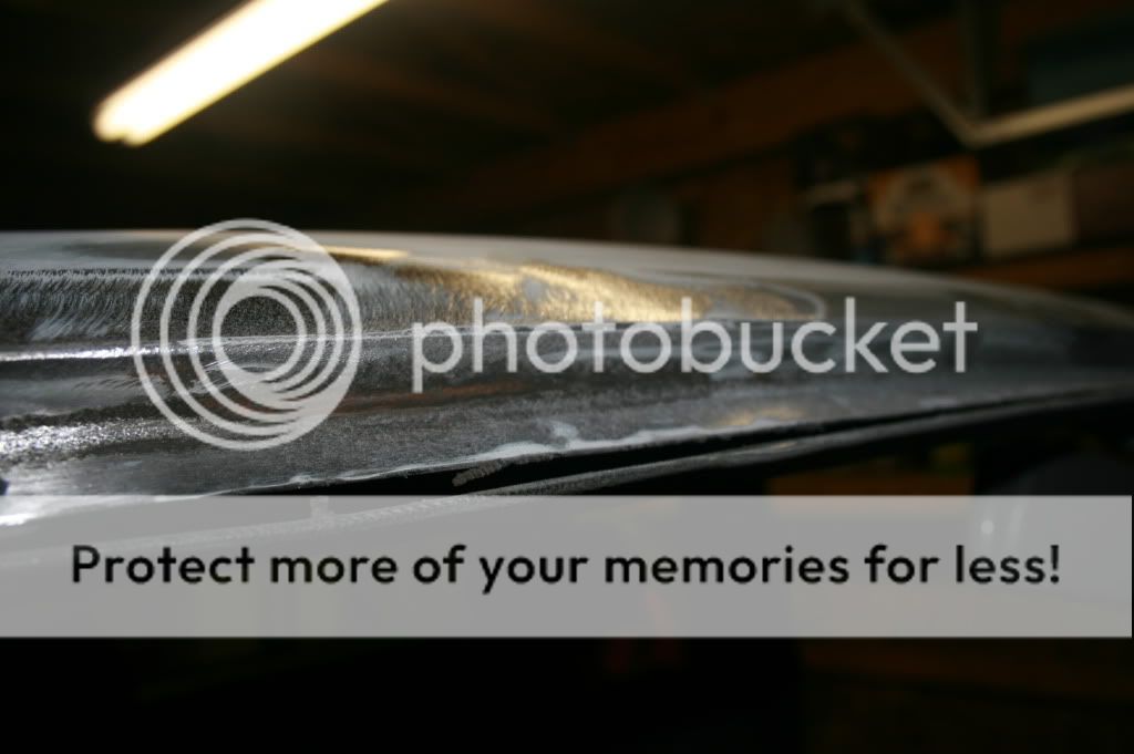

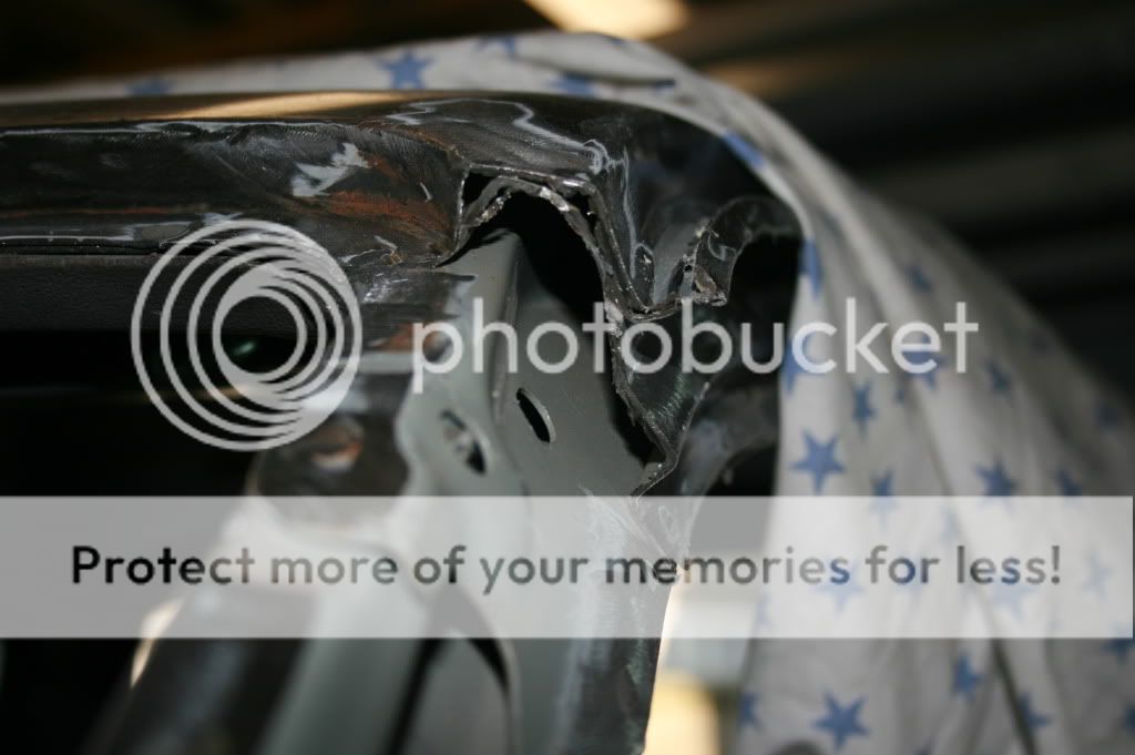

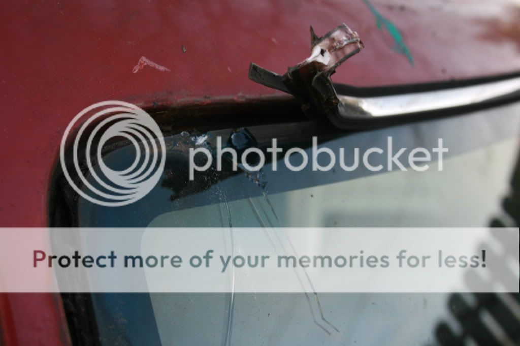

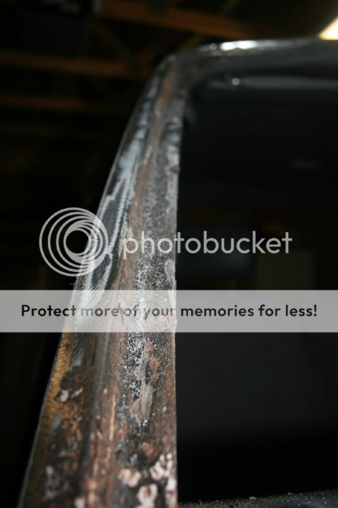

Yeah.. not looking so good. The windshield was replaced at one point, and the guy who did it obviously scratched the metal while scraping the old urethane off. He didn't bother to cover the raw metal (probably a case of, "you only paid to have the windshield replaced, not to have it done right"), as clearly that's not his problem, so rust and time had their way with the window surround.
Not good either (passenger side)
At least the top and bottom were in good shape.

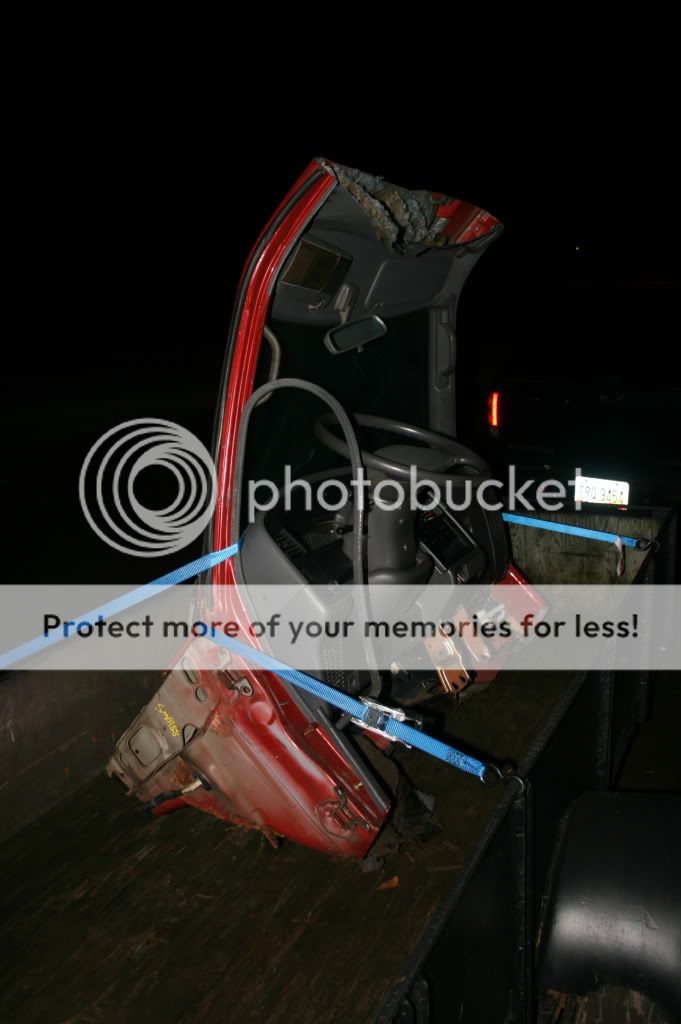

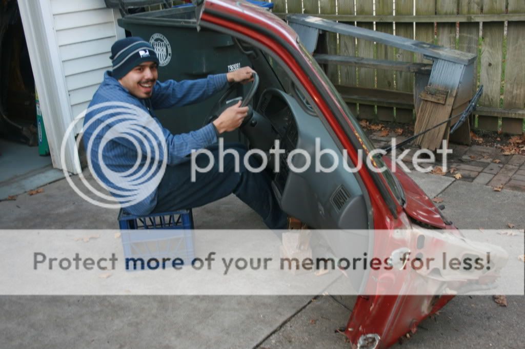

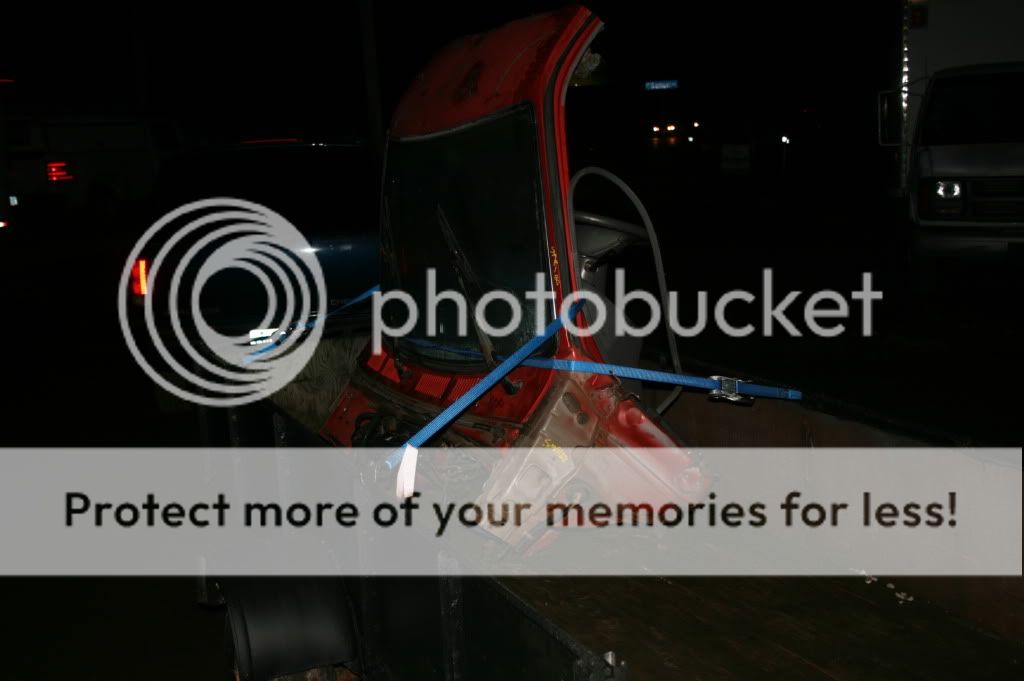

That left us waiting to get some new A pillars off a truck from the junkyard. It ended up being the same one I got the door from. The guys were helpful, and quoted me for just the pillars. I asked how much for the dash, and it was going to be another 100$, so I said forget it.

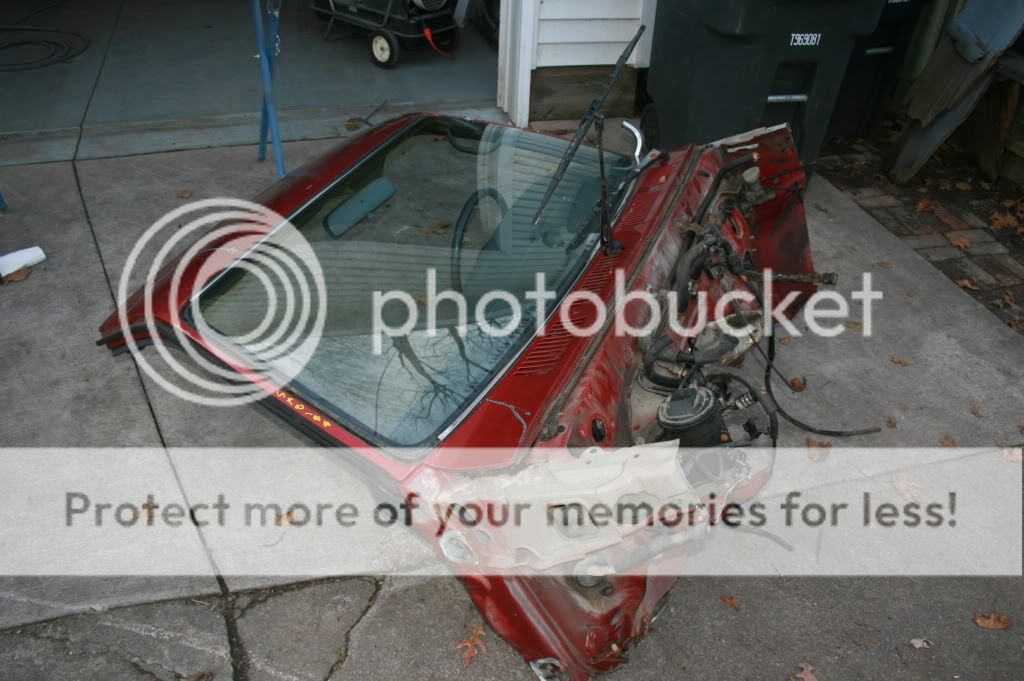

I went to the yard to pick up the pillars in the 626. I figured they would be cut out and ready to go. The guy's like "so you got a truck to load this in?" and I'm like, "A trunk?" being optimistic, lol. He showed me what they did.
It was going to take too long for him to hack through the dash, so he just whacked out the whole firewall and gave that to me for the quoted price. I ended up getting the dash and a lot of other goodies too! :D I love good surprises, even though it wouldn't fit in my car!

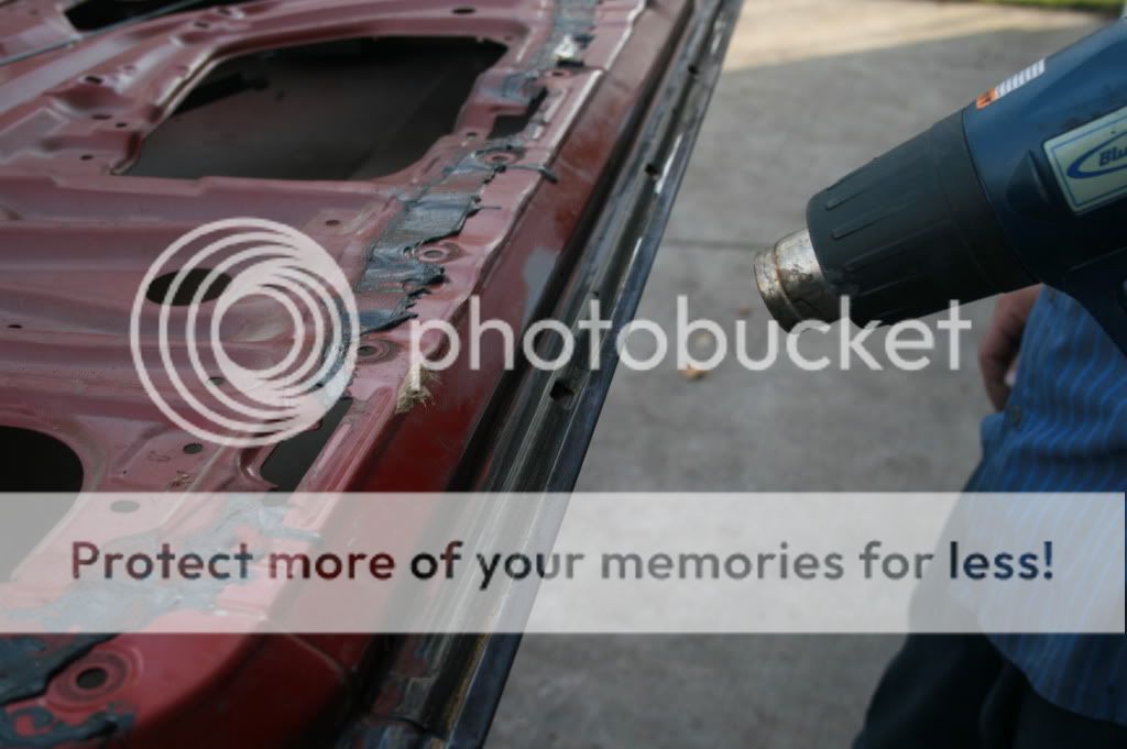

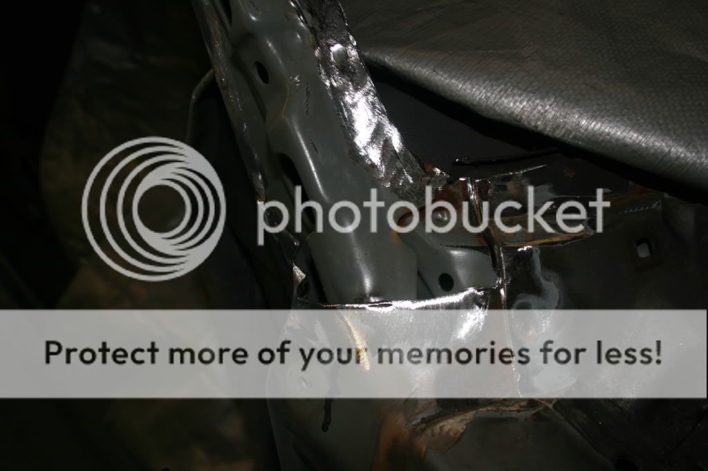

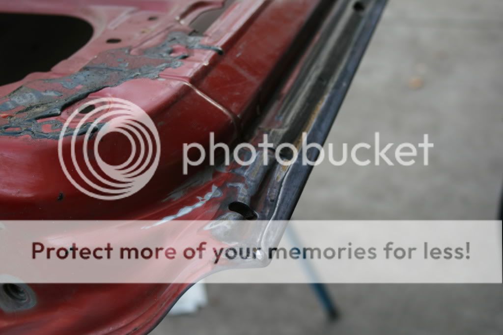

Some surface rust on the new door ground down and coated with a product that chemically converts the rust into an inert form.
Drying it with the heat gun that can do 1200*F

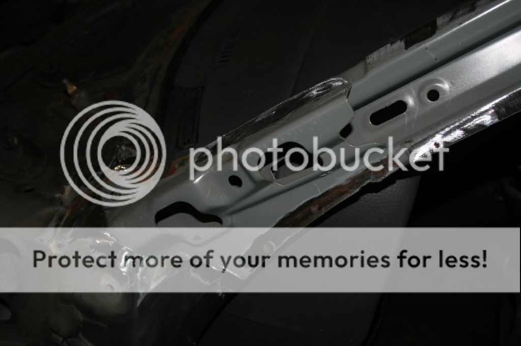

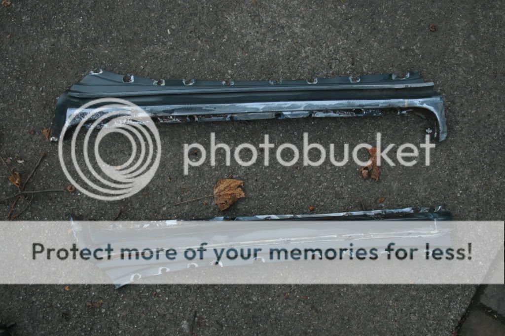

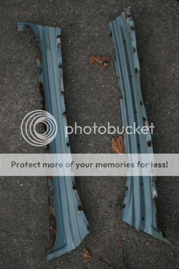

Old A pillars, all cut out
The insides and structure inside are coated with some kind of awesome battleship paint that seems to be pretty robust and good for resisting rust. I'm really surprised they didn't look much worse than this. Usually the insides are 10x worse than the surface.
Only the structural part of the pillar was left on, Josh cut the skins off.
Lots of layers
Bottom of the driver's side
Bottom of the passenger's side
Top passenger's side

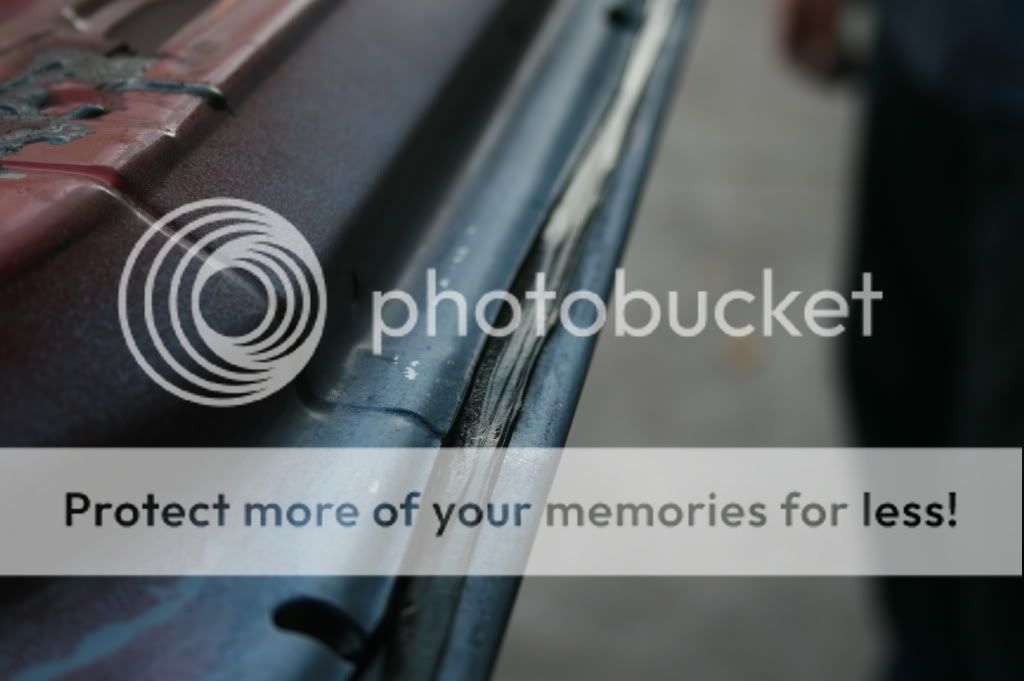

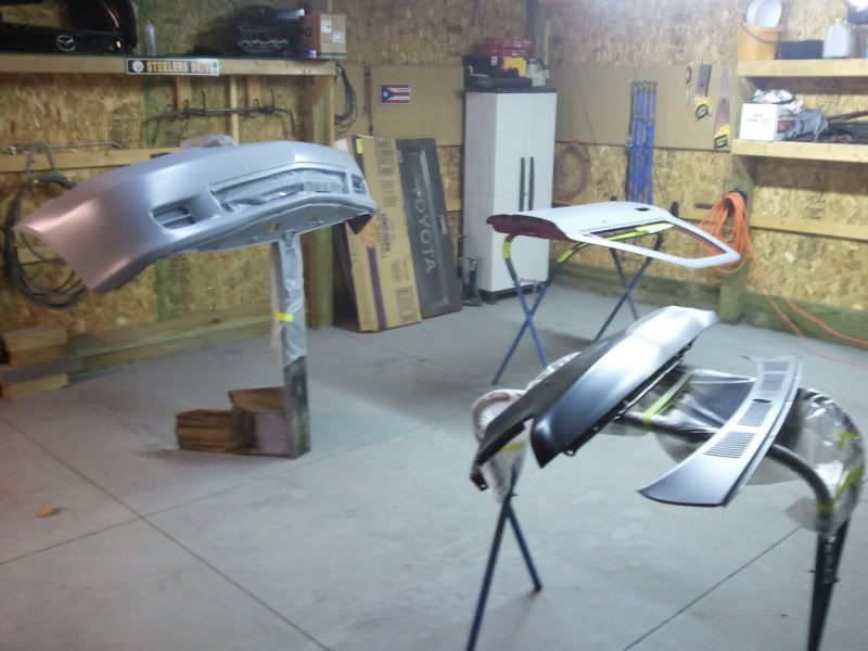

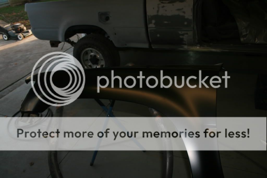

Fender, ready to be sanded

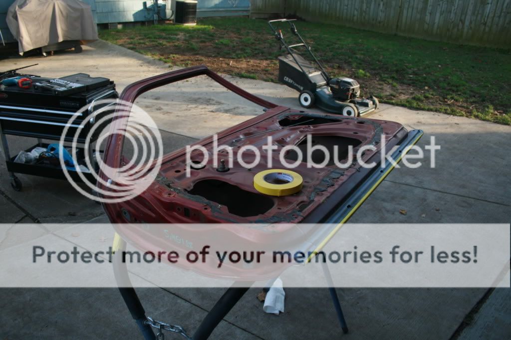

Door, awaiting seam sealer

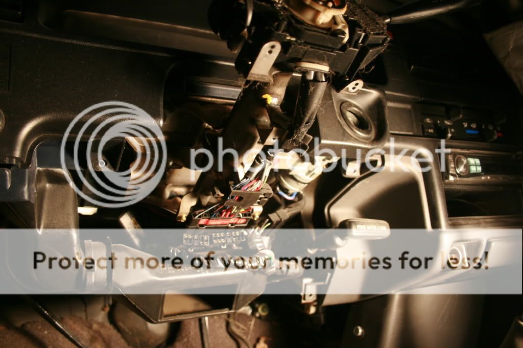

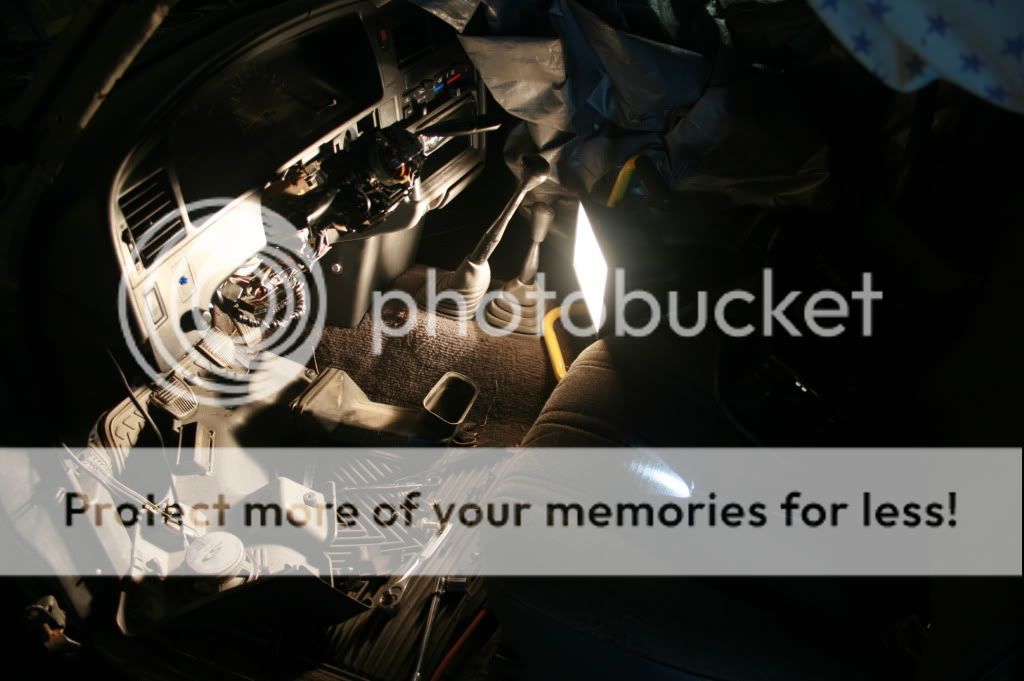

Some of the goodies that came on the new clip were the fact that that truck had a tilt steering column and an intermittent wiper switch. I sorely missed both features, but didn't even know they were available, and couldn't justify spending the money to get them at the yard. But since I got them for Free.99 (my favorite price), it was swaparoo time!

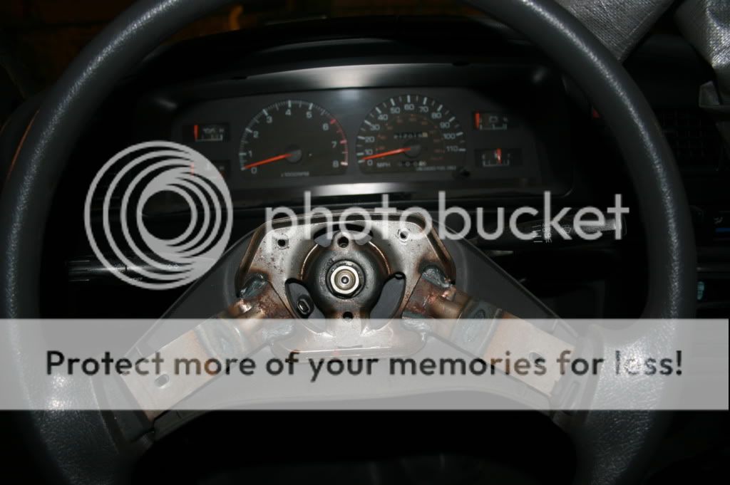

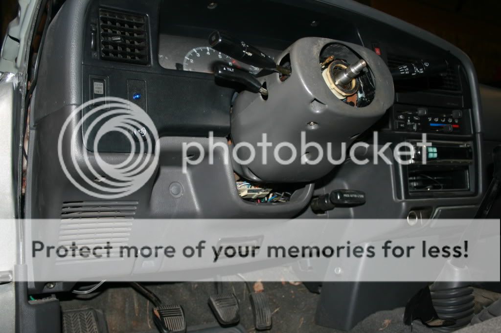

Steering wheel apart

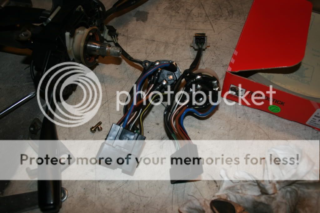

Harness to the wheel (responsible for the horn, lights, wipers)
All da junk danglin in da breeze
New tilt column!

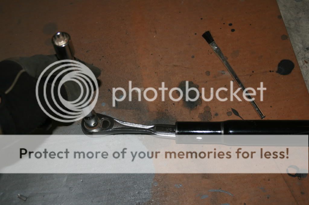

Po' man's breaker bar. It's the handle off the jack, one of my favorite tricks
The work lights get so hot, it was friggin cooking the seat, so I had 20's years of butt sweat being baked out of it right into my face. Not my favorite smell…

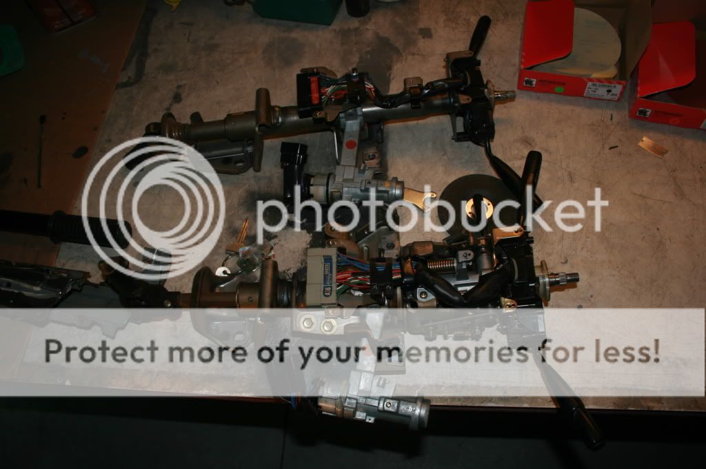

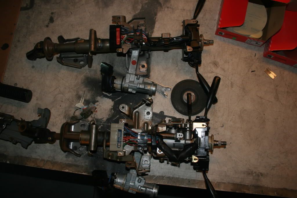

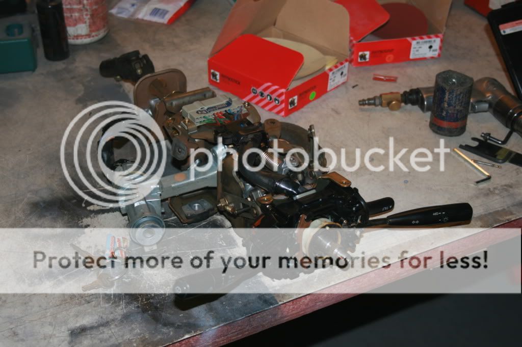

Columns next to each other. Tilt is the bottom one. You can see all the extra junk it has on it compared to the other one.
Another view

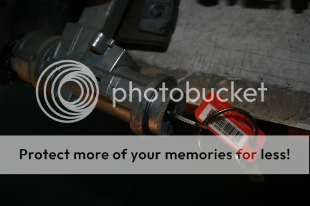

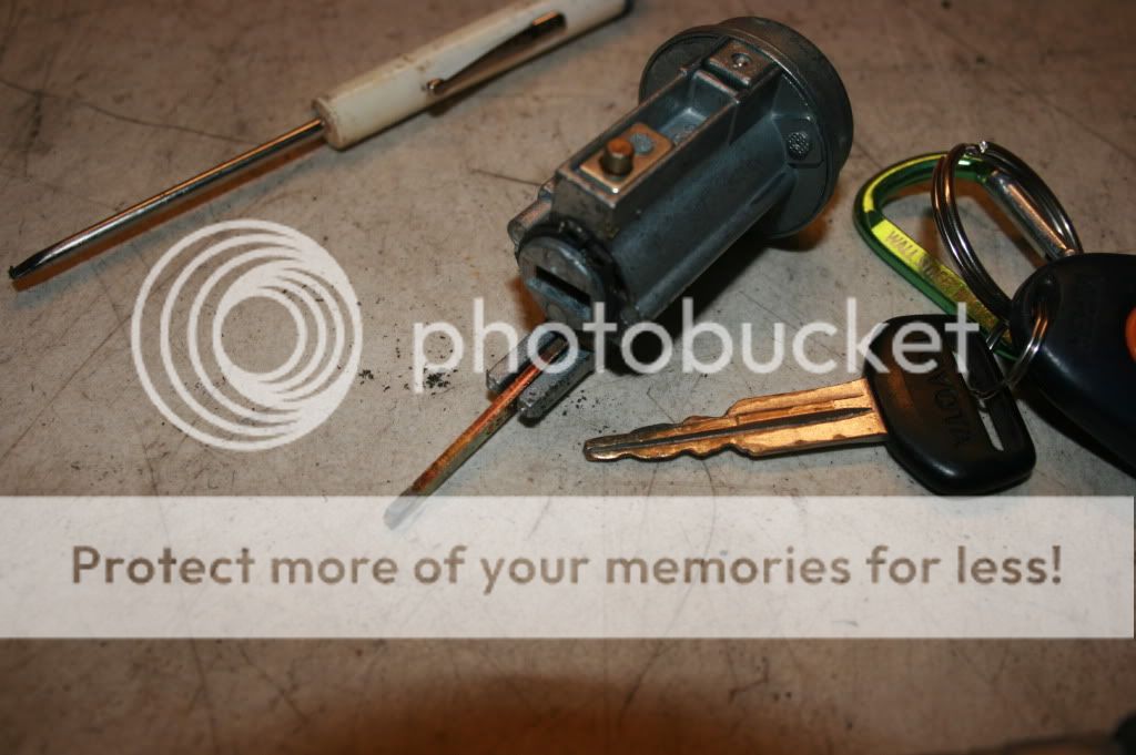

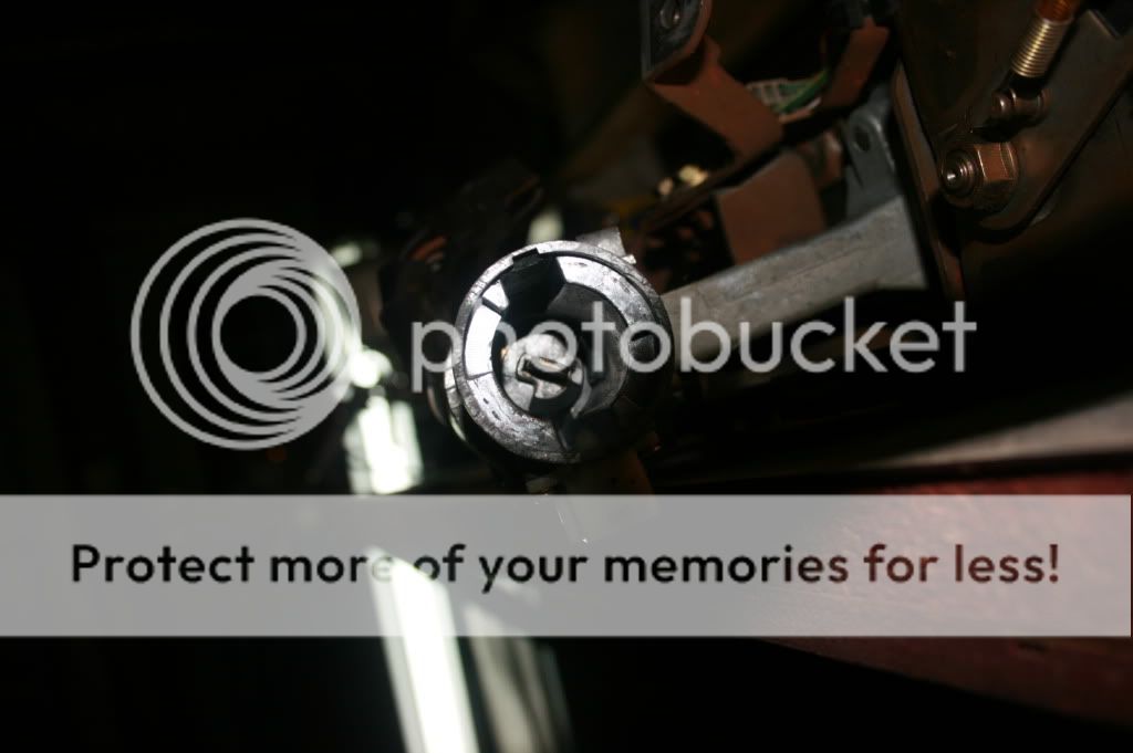

Baller trick Josh showed me. We had to swap the key switch since I didn't want to have to carry two keys (one for the locks and the other for the ignition)
Turn the key to accessory
With a thin screw driver or a nail or something, push on the little button in the middle and pull the key housing out
So simple! I love 80's tech!

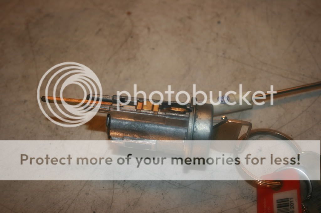

I was trying to show the key dust here, since you might be able to see how worn down my key is in the picture, but I accidentally bumped it and knocked the dust onto the table, so it's hard to see. Kind of weird, I'm not sure if Toyota makes their tumblers diamond lined or what, but key wear seems to be a common issue.

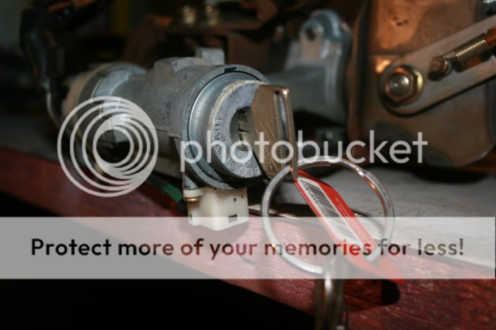

This is inside where the key switch goes
All empty. Notice the little V thing that hangs down from the metal mount above

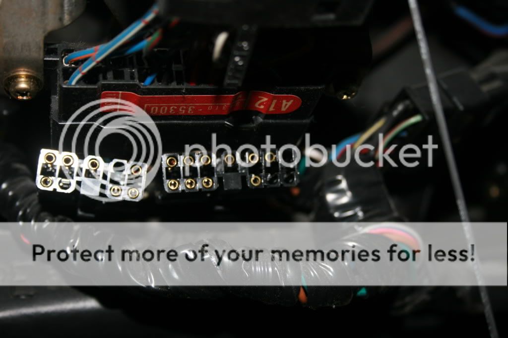

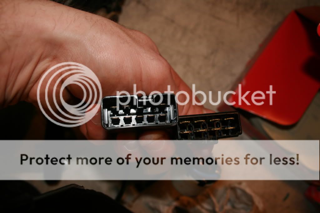

Another hang up. Josh patiently waited while I noobed my way around. I installed the column no less than 4 times, and once was when I realized that the harness coming from the back of the key switch was different! I panicked!
Not to worry, it's just held on by screws, and they're a direct swap.

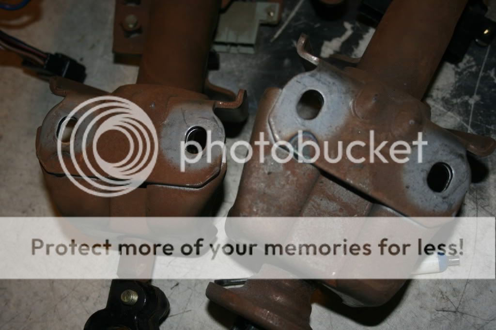

Another time when I installed the column, I couldn't figure out why it wouldn't bolt down all the way. I finally noticed that this thing was getting in the way, and decided I'd have to cut it. I about cut 4-5 different things, but Josh was the voice of reason and would point out that whatever I was about to buzz off was held on with bolts that I'd overlooked in my frenzy to use power tools
I looked at the two different mounting plates, found the centers of the holes, drew a line between them, and what do you know, they're the same size. I thought I'd have to notch the tilt one to fit (figured it was bigger for whatever reason), but it turns out that it hooks over the V thingy and sits on it. It helps hold it in place. I was getting weak from installing it so many times, and fooled with it for several minutes, trying to get the spline shaft to line up, the V thing to hook over, and the other bolts to fit in the holes, all with no success. Josh comes over and does it first try. Show off.
There are subtle differences between the knee plastic trim piece, mainly the bulge under the column that covers up the junk. I'm not super worried about it since I don't plan to spend any time under there looking at it.
