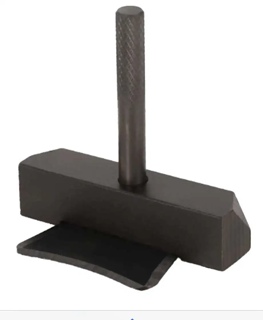

3. Probably not. If sealant was used instead of a silicone gasket, you’ll have to work your way around the perimeter of the pan to break the RTV seal. I used an oil pan separator tool. If a silicone gasket was used the pan will come off with the bolts.

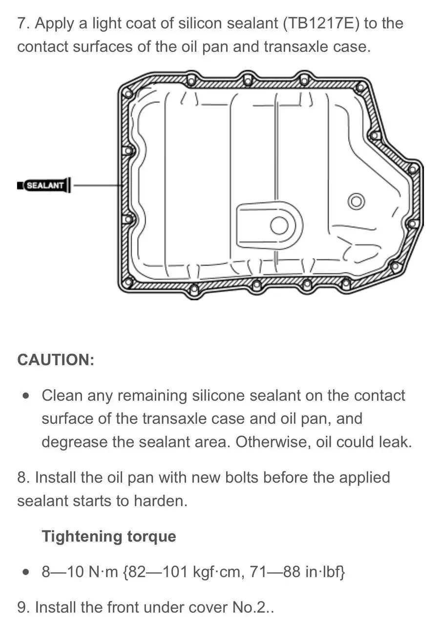

Guide ATF Drain/Fill
Based on Mazda Workshop Manual, we should apply RTV on both sides of mating surfaces, but I doubt anyone has done that way so far:

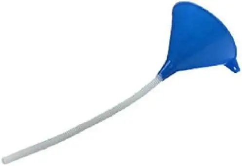

In addition to the funnel mentioned by @madar above, @Kedis82ZE8 suggested this small funnels with a long tube:
ATF...Change or not?
You can also get an oil pan separator tool like this:
Guide 2016~2021 CX-9 DIY Transmission Fluid Drain and Fill + Filter Change

^that just about sums everything up, lol! The funnel recommended by Kedis is the one I’d use if I didn’t want to remove the air box. Like blooms suggested, I remove the airbox to do the work. I didn’t use an extension for the dipstick bolt. I used a long socket.
