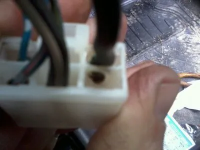

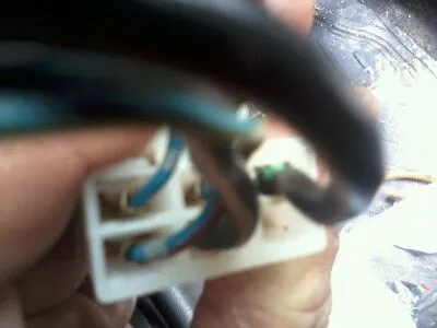

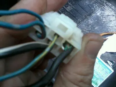

I have attached pics from what is the white connector that plugs into the the fan sped control switch. Not to be confused with the black harness I did the follow-to with. I posted these switch pictures to show the damage done on the harness and was wondering if this by chance is the real problem with MY VEHICLE.

sorry if it is hard to see but from what I can tell, the thick black wire(GND) has melted off some of the protective sheathing and also started a bit of green colored corrosion on the bare copper wire. Also it has melted a hole through the white plastic harness connector, if you look real close...you can see that two of the copper strands have actually broken . This i am sure is causing a resistance issue. Don't know what I'm going to do to repair it yet. maybe i'll see if I can get a better looking harness down at the bone-yard and solder it in maybe. not sure yet.
That plastic connector itself isn't very important. You could remove the individual terminals from the plastic holder,... clean them all up,... replace the terminal end on the fat black wire (trimming an inch or so off the end of the wire) and just plug them onto their respective terminals on the back of the switch.
There really is no danger of any kind of short within the connector itself,... if they do touch each other, the fan just turns on. The fat black wire should never touch ground though because that is B+ from the battery and you will blow a fuse.
OK black is B+ I should known that, well...I should have at the very least checked it out for my self to determine what it is instead of assuming. Thanks
