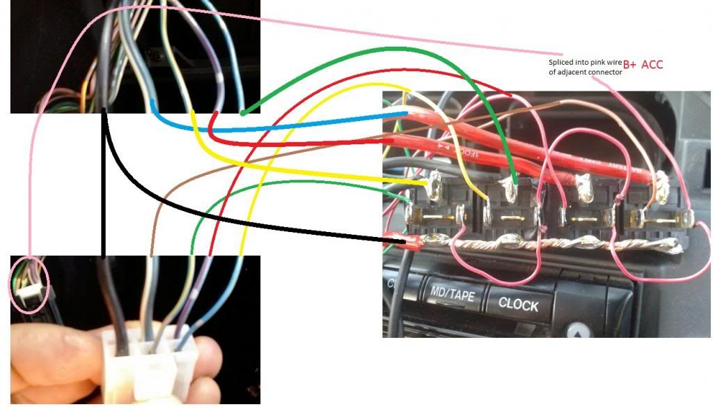

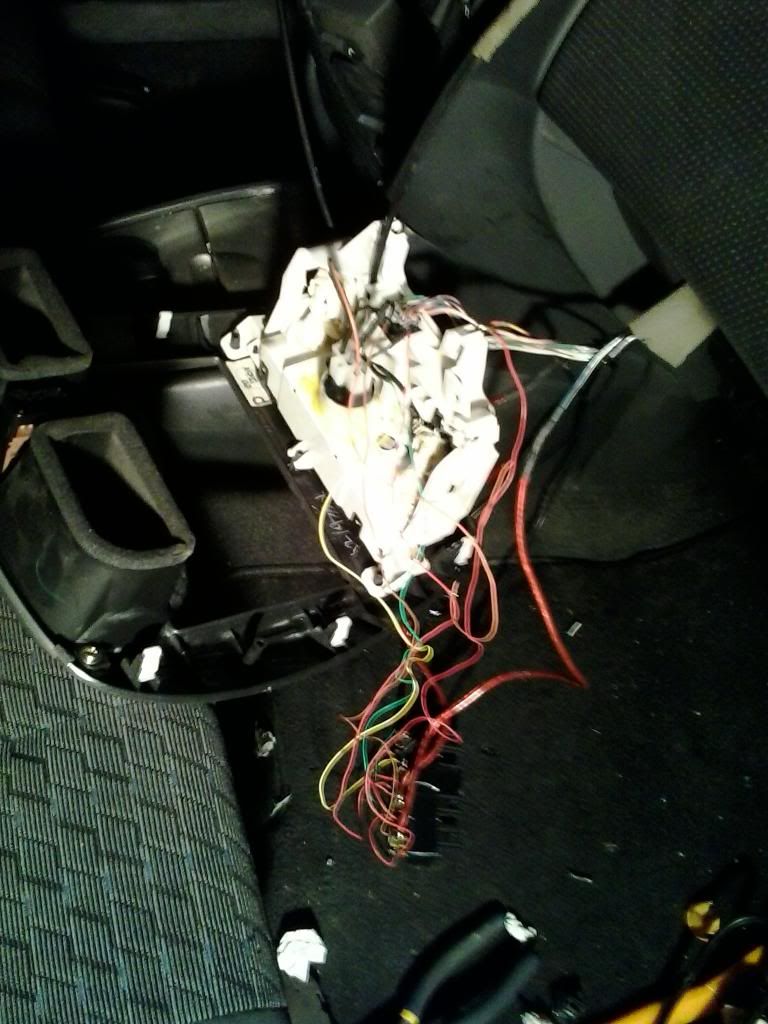

That's why I did this,...
My fan switch only controls the relays,... there's no power through it.
Interesting idea - with the switch just shifting current to relays the switch should never carry a significant load and so it shouldn't ever burn up.
That looks like one substantial ground wire!
The picture is a little out of focus so hard to tell. Does that reuse the existing wires from the resistor pack to the load side of the relays, and new wires from the console switch to the control side?
Where did you mount the relays? Hopefully some place where nothing conducting can touch any of that wiring. If your switch is set to off so that the load sides of the relays are open there will be 12V between the ground and the wires that run to the resistor pack. The wire for position #4 has only the internal resistance of the blower to limit the current. I don't recall what the maximum current through the blower is exactly, but it is on the order of 10A, so there might be quite a show if anything ever shorted the #4 wire lead to the ground wire or any bare metal nearby. In the factory harness all the conducting parts are inside the plastic connectors so that that sort of short cannot occur.
Does that reuse the existing wires from the resistor pack to the load side of the relays, and new wires from the console switch to the control side ?
Here's a picture that shows the wiring,...
I didn't bother mounting the relays,... I just rolled everything up and stuffed them under the dash,... It doesn't matter,... If anything shorts out the fan starts blowing,... Its not a dead short the switching is done in the ground wire after the load.
The only positive wire is used to power the relays and I stole that from a pink wire from under the dash,... if that one shorts out, it blows one of the dash fuses,...I forget which one.
