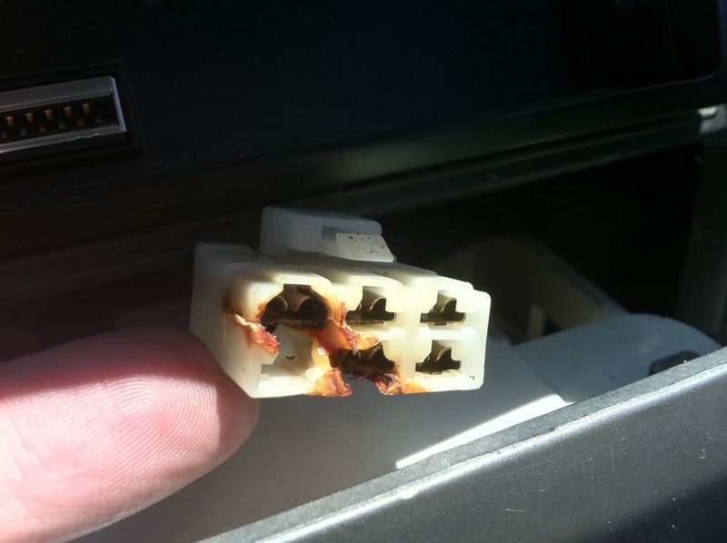

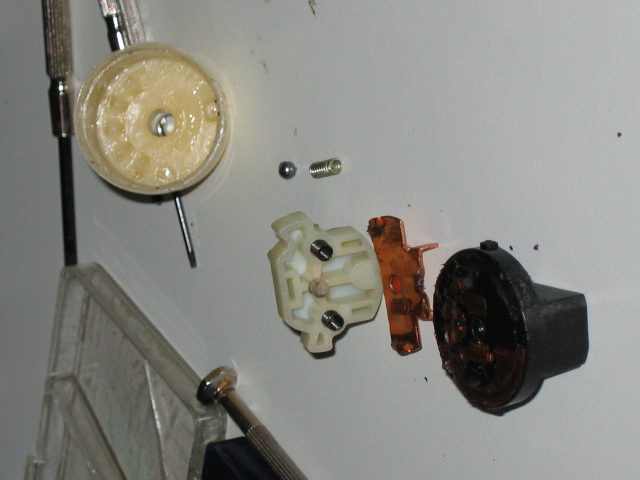

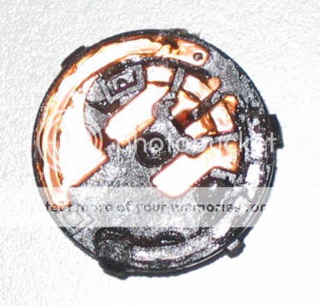

I have a bit of an issue with this fix,... I don't see the sense wire as the root cause of the AC problem. I see the fan switch as the root.
I'm sure that everybody's flickering light would be fixed with a brand new fan switch because there is no resistance across the new switch to trip up the sense wire. I think the flickering light should be more of a warning that there is a dirty, worn or bad connection in the fan switch or connector at the back of it. That switch is far too flimsy to handle the 12+ amps that run through it.
As soon as there is a bit of resistance across the connections in the switch, it creates huge amounts of heat that can liquefy the switch and connector at the back of it.
If all you do is "trick" the sense wire then you are probably still cooking your fan switch.
I would suggest taking apart the switch, cleaning and sanding it and checking the connector as well as doing this resistor fix.

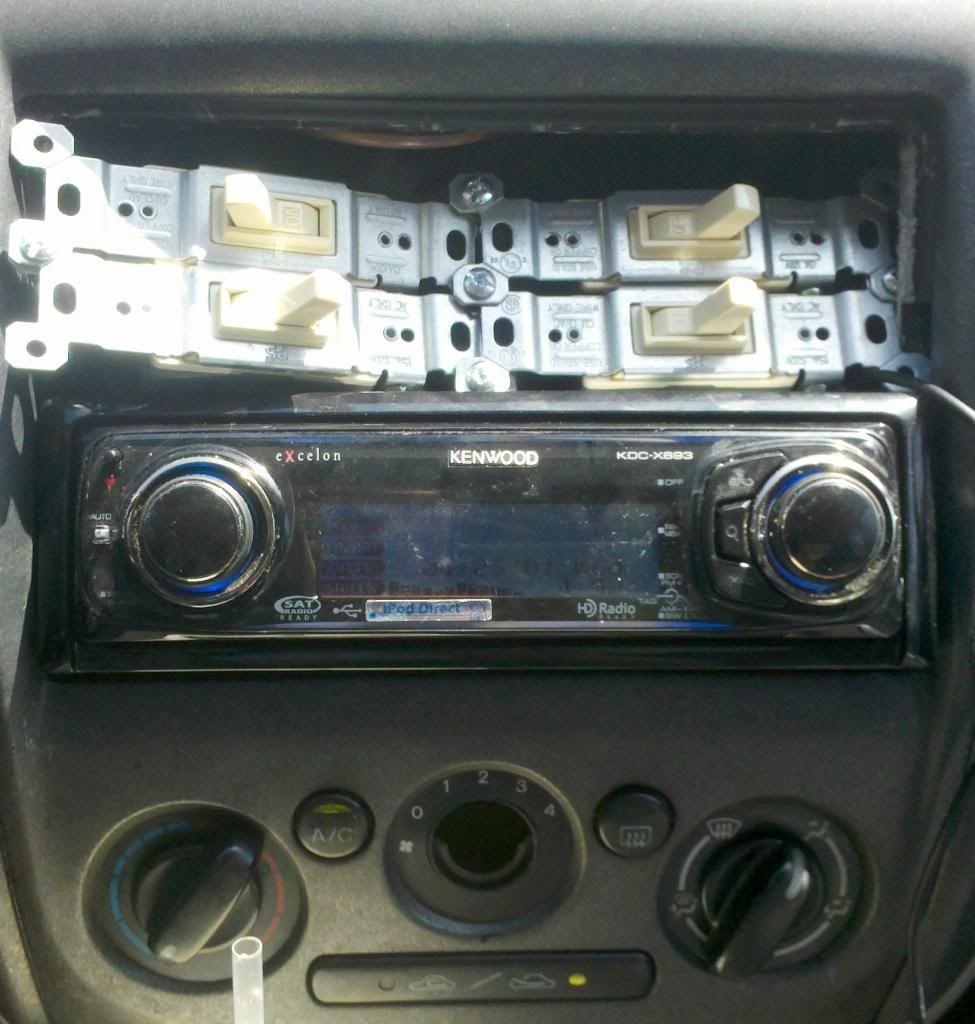

There is only one true fix for this issue and I love it:
Now these switches are rated for a good 15 amps:
I disagree, the switch is definitely part of the of problem but the system as a whole is under-engineered. Have you read my analysis?
This is a very good suggestion, especially if your fan switch connector is starting to melt. That being said, this fix doesn't put any extra current through fan switch, it just lets you get your A/C back. My fan switch connector looked absolutely fine, there wasn't even any visible corrosion.
This is the most ghetto thing I've ever seen on this forum ... I love it :D
OK,.. I read your analysis and it makes complete sense. (I am reasonably proficient with electronics) However my main concern is still the same. If the internal resistance of the switch (which is where I believe most of the resistance is coming from followed by the connector at the back of it) is enough to produce a 1.1 volt drop, that is 1.1 V x 6.35 amps equals 6.985 watts of heat in the switch for fan speed 2. For fan speed three, 1.1 V x 8.8 amps is 9.68 watts of heat and 1.1 V x 11.75 amps is 12.925 watts for fan speed four.
That is plenty enough heat to start melting things.
http://www.mazdas247.com/forum/show...amp-relay-STILL-NO-AIR!&p=6121332#post6121332
If you crank up the cutoff voltage to 3 v then the heat in watts goes to 19.05 W, 26.4 W, and 35.25 W before the light would start to flicker. That's enough to cook a burrito on the fan switch. (consider how hot a 25 watt brake light bulb gets)
My AC light started to flicker last summer for the first time. I took apart my switch, cleaned and sanded the contacts and all the pins and connectors on the connector plug. That fixed everything and I got to it before the big meltdown. I kinda like the fact that the light flickers at 1.1 volts because it gives me enough warning to clean the switch and contacts again before everything liquefies.
I also noticed that the connector plate inside the switch is kinda spring loaded so I stretched the springs a bit and bent things a bit to help provide more pressure on the contact. I also put a bit of white grease in it.
Let me know if my math is right ,... I know that not all the resistance is in the switch, some is at other connections and some in the wire itself.
