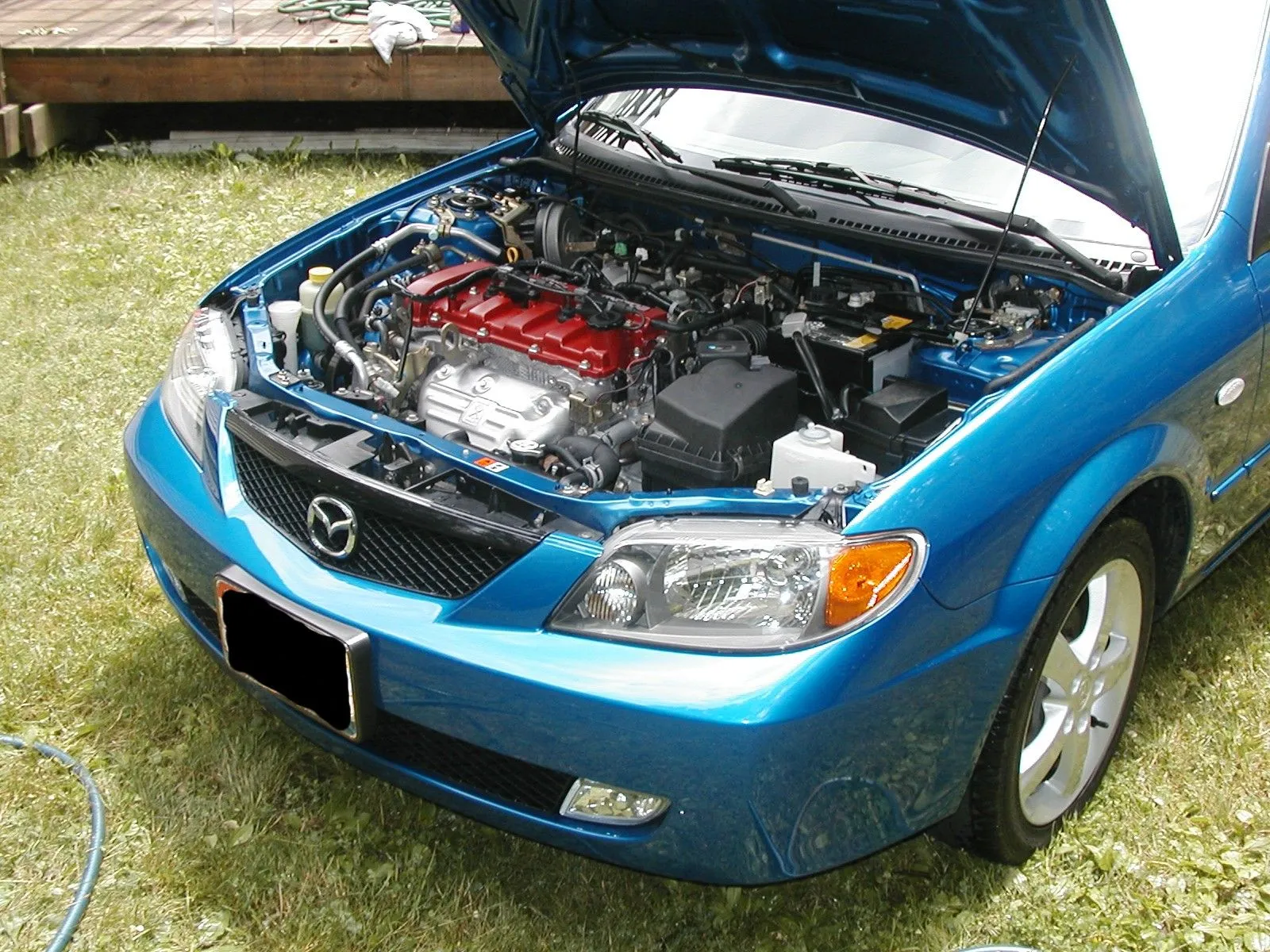

Painted my Valve cover
that's a good deep red...i wish i could find some paint that color to do my calipers!
i'm going to paint my valve cover like that hopefully this weekend...along with my wheels...and install my sways...anyone wanna help? lol.
the valve cover looks great!!
topher, who would want to help YOU?..........................................jk!
24hr's it was plenty dry enough to install use your own judgement yours may dry quicker. I also used a new gasket and make sure there is no oil on the vc or head where the gasket goes. I wiped the head down with thinner after i got the oil off and the valve cover was alrdy squeeky clean from cleaning it soo much. You also have to put rtv in the corners of the cam caps.
Yeh well sorry I have a life and didnt have time to polish mine (boom03) . lol im j/k but this is my daily driver needed it done asap. Im not quite the polishing pro yet either need some more attachments.
Is that the one from the mazdaspeed miata? Let me know how it goes. Mines is leaking too since the first day i got it.
Laser03pro said:
Well I ordered me a Mazda speed oil cap hopefully that helps.
Yup its the miata one. I might try and sand the surface really smooth noticed its not real smooth wish i would of done that before I installed it tho, thought it would seal but the stock cap sucks.
If you are carefull you can polish/sand the raised lettering to make them silver/polished/brushed depending on how much time you have.
If you look at the first post I had my letters polished but then I sandblasted the whole valve cover to redo it so ill have to redo them again.

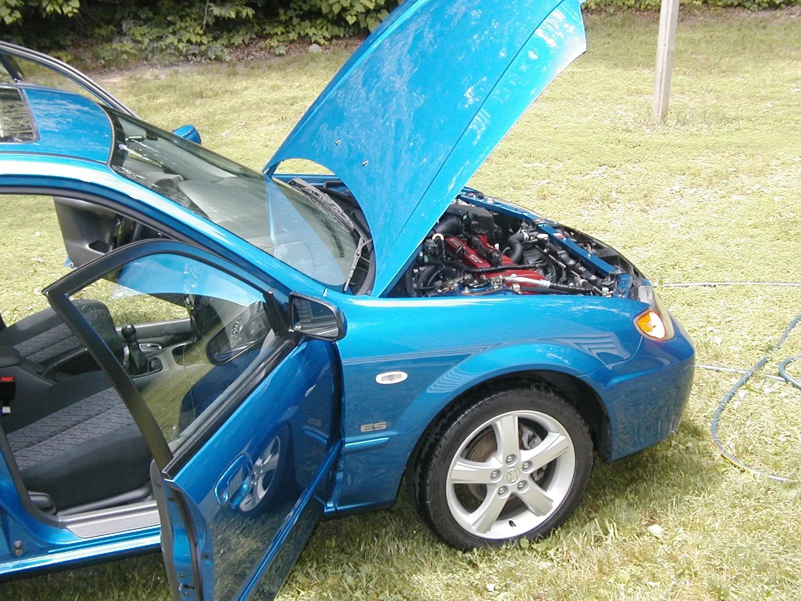

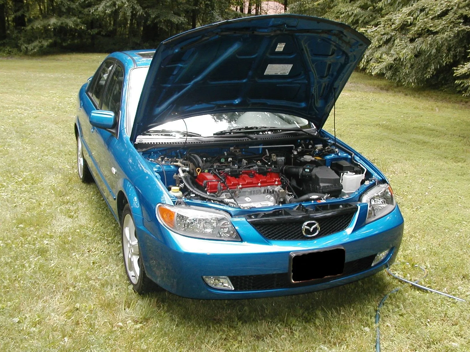

Here you go got a nice day and a little free time. Still waiting on my oil cap and cai though.
The more i mess with this car the more i want to upgrade it was tryin to save the money for my other car. I guess cause the mazda is running and together makes me want to mod it more. Im kinda thinkin of a msp conversion possibly if i get really bored.
