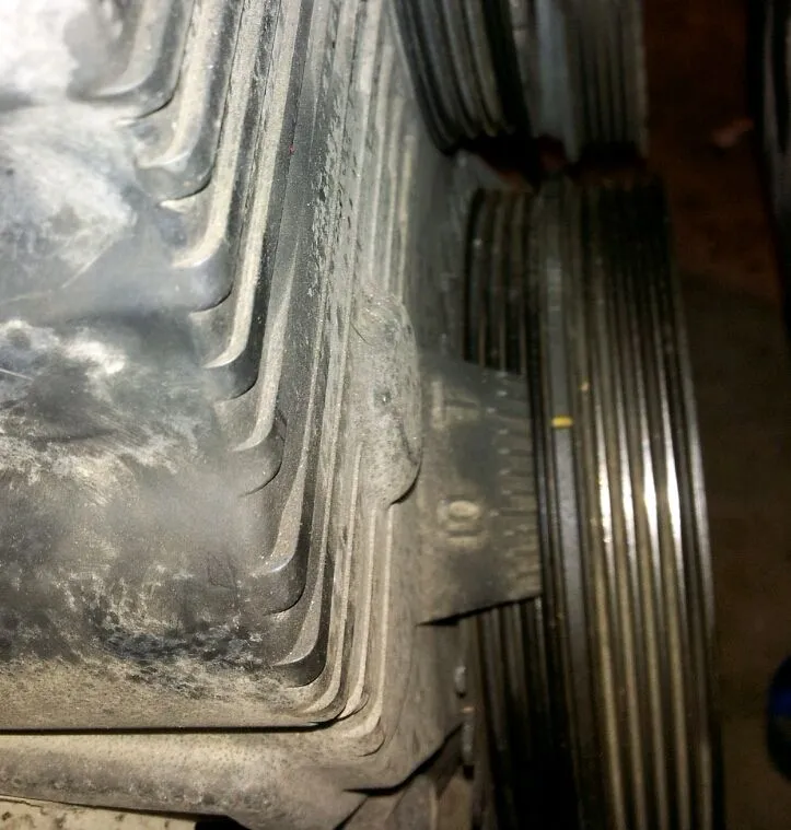

Check that the yellow crank mark is still at "T" on the timing cover

where as my yellow crank mark is on 4. meaning 4 degrees advanced or retarded

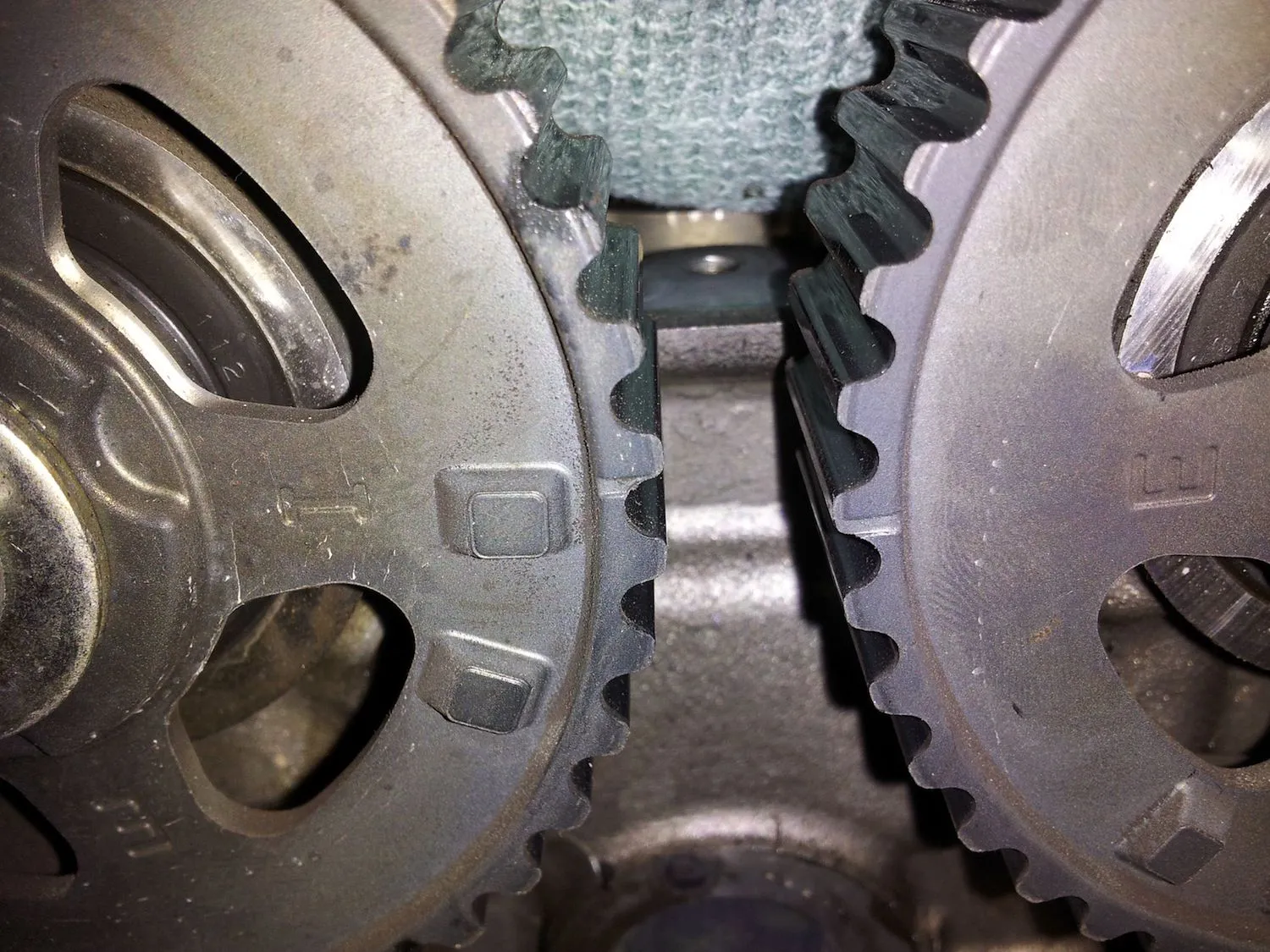

Did you do the wrench and vise grips trick on the cams to keep them from moving while you installed the belt? Post a pic of the cam gears already! I always set the timing without the Crank pulley installed and use the notch on the crank. 220whp may be a little high of an estimate but it should be somewhat close to that.

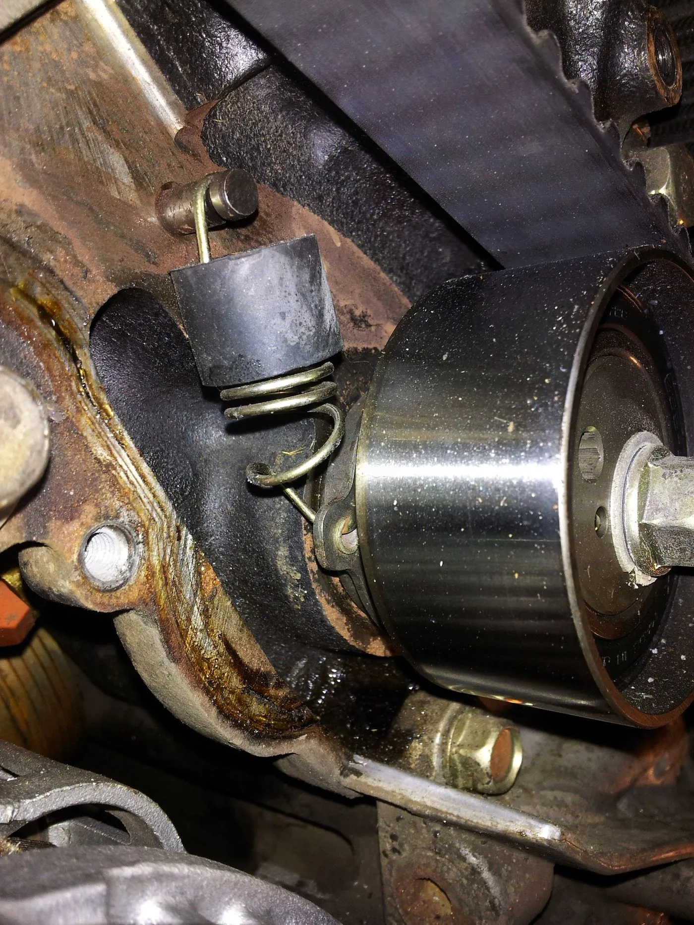

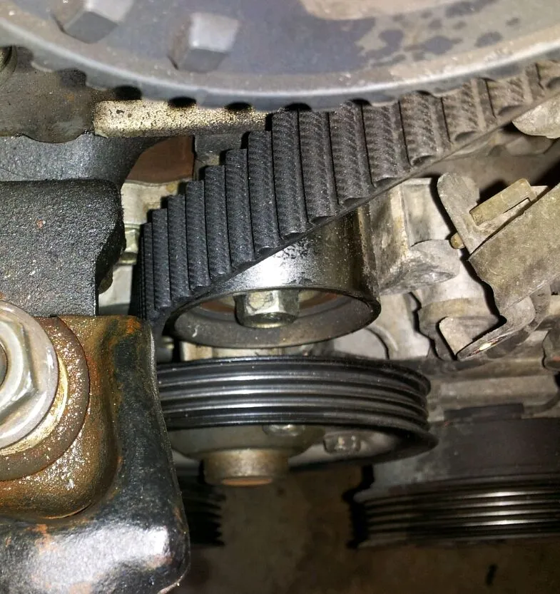

here are some better pictures, i moved my cam gears around and now it looks like it might be fine... arg. i am still going to re do it tomorrow myself just to make sure and im going to go by the mark on the block not the cover marks.
how would i tell if my tensioner is shot? how tight should the timing belt be when all said and done.

The tensioner pic you posted is actually the idler pulley, the tensioner is next to that closer to the firewall.
The belt will be pretty tight, it's hard to slip the belt on even with the tensioner twisted out of the way. And the spring for the tensioner that sets the tension needs to be replaced to ensure proper timing, it's about $8 at the dealer.

hey man just wondering if you could tell me how to tighten my timing belt. i just re adjusted my timing belt to where it should be after the guy i paid to do it ****** it up. sooo i replaced my stretched out tensioner spring and put all my parks to where they should be, then rotated my crank pulley 4 times to make make sure the marks still lined up. they were slightly off (cam gear marks) which i then relized it was because there was a tiny bit of slack in the belt so when i tighten the belt it does line up very nicely. sooo how would i get the belt nice and tight now that everything is on?? the tensioner is on but the bolt still needs to be tightened. pls help
Ok, This is not a problem.
You can tighten both bolts down on the Idler and Adjuster.
There is an allen key hole in the adjuster, Use that to take up the slack before adding the spring. Once the new spring is on and has not been stretched, you should be able to move the crank clockwise, as it is supposed to turn without messing up the spring.
if you turn the engine the wrong way, you (may) damage the spring because it is only designed to take the tension from the back of the belt, as soon as you spin the engine backwards, the spring will be stretched and never work properly. (Not Like the Alternator Bracket which is not spring held)
A small level of slack is normal, it should not pop a tooth unless it is spun the wrong way. (Or The Belt is Effed and defective from the factory)
