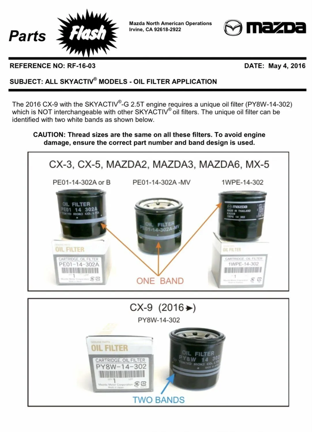

REFERENCE NO: RF-16-03 ALL SKYACTIV® MODELS - OIL FILTER APPLICATION
Yes, Tokyo Roki PE01-14-302B is factory installed oil filter on gen-2 CX-5 2.5L, but it’s never been available as the OEM oil filter in the US by MNAO.
Thank you for confirming 🙂. If anybody wants the Japan made filters for either the 2.5 NA or 2.5T engines, you can get them from partsouq.com. They are in Dubai but ship worldwide. I just ordered 20 filters for both my 2.5 and 2.5T and should be here Thursday. Total with 3 day air shipping was $200 so $10 a piece for oem Japan made filters. If you change every 5k then buy bulk and save

The difference is they got Japanese Tokyo Roki oil filters used by Mazda plant during engine assembly from partsouq.com on eBay, but we got Thai made Denso oil filters from US Mazda dealers.

Did you compare the orginal Tokyo Roki PY8W-14-302 with the ones from partsouq.com to see if they were actually genuine? I wonder how their return is if the wrong/damaged part was sent?

Yes, genuine goods! Each filter has a plastic seal on top to protect it and is inside a Mazda box which is also sealed. No issues whatsoever and packaged well.

Tokyo Roki PY8W-14-302 filters are not available in US, but the rest are.
For myself, I believe the Denso made 1WPY-14-302 from Thailand should work just as good.

I have changed oil before in my 2016.5 CX-5.
I used Wix filters but today I've tried Wix 57002, STP per Autozone then a Mobil-One 1-108. None of these will fit. The threads are too small. Am I losing my mind?
wrong... it was still available as late as 2015... it's been 1WPE since then in the US.... I imported a case of PE01 filters in 2016 from Japan... they're still sold there
Is the DENSO 1502002 a one size fits all filter?
Yes. It has an anti-drain back valve that is not present on the OEM filters. It’s funny you asked this as I’m considering buying some myself. I’ve been using Mobil1 M1-108 and Bosch Premium on my ‘13 CX-5 and my mother in laws ‘18 CX-5, but my Bosch stash is dwindling.
