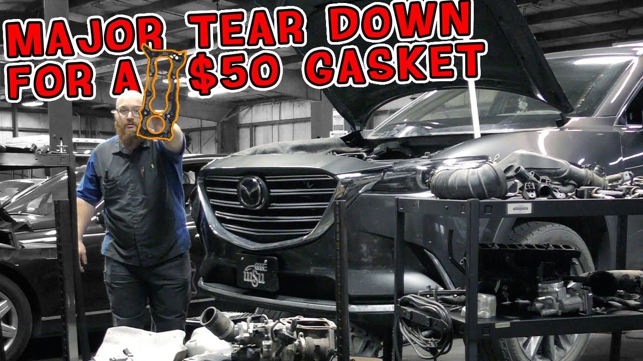

I don't know if this video has been posted here, but since this is a current topic I found this CX-9 head gasket replacement video interesting. I wasn't aware of any 'coolant plugs' that could leak and how they are covered up and the mechanic goes on to say they should be addressed while apart or it may have to come apart again. It's interesting how Mazda incorporated the exhaust manifold into the head, also this is shown towards the end of the video. It's also amazing the amount of parts removed to replace the head gasket. As always, check out the viewer comments.
Yes, it’s been posted here before in CX-9 forum:
Poll 2.5T Coolant Leak/Engine Replacement
