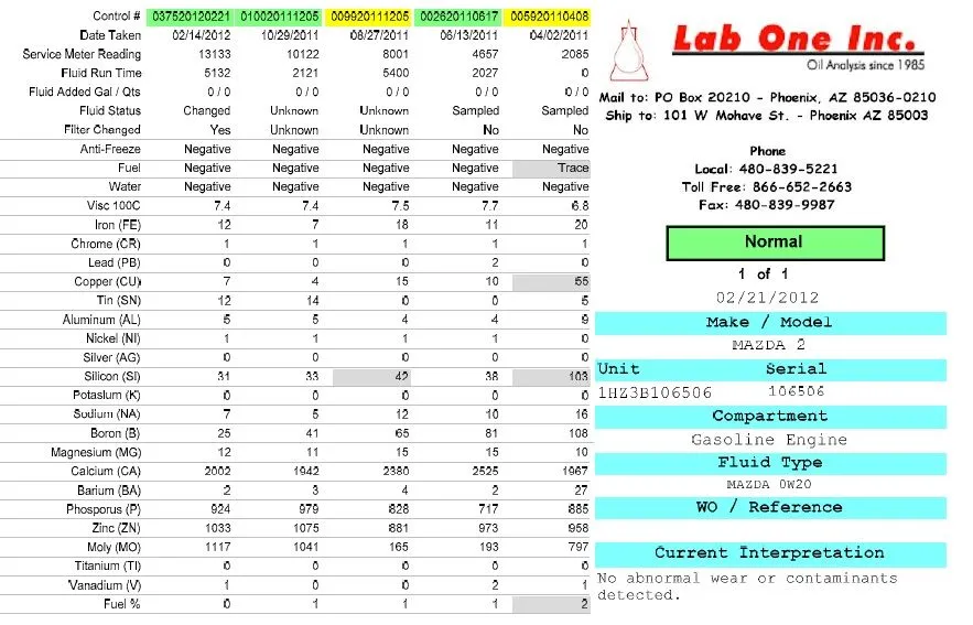

Question on this Oil Analysis?
After 14K miles here we are:
  • Read from Right to Left;
  • I sample at Oil change (Oil has about 5K miles on it) and 2K after Oil Change
  • OEM Oil was sampled first and replaced with Mobil 1 0W-20
  • Next oil change had the Mazda 0W-20 Synthetic used
  • Mazda OEM filters and crush washers;
  • I will sample tranny at 25K;

The first sample at a bit over 2,000 miles showed some fuel dilution and addition to sand from casting and bearing materials from breaking-in. Nothing alarming, just lots of things in there that needed to be removed. So a few hundred miles later I change the oil and use Mobil 1 0W-20 (All that was available at Mazda dealership for these cars). 2000 miles later (second column from right) I sample and it looks OK. So I stay on schedule and when that oil has about 5000 miles on it I replace it and take a sample again, just to see if the 5K interval is OK. This is the third column from the right. A few metals are a bit high and Silicone (damn sand and damn dirt) a bit high also. So now I used Mazda 0W-20 synthetic and sample after 2000 and again at next due change (last two columns on left-second and then first). I also used Mazda 0W-20 synthetic this go-around and have 4 qts left from the case I bought. Things are looking cleaner and it seems that 5,000 miles is a reasonable interval on this synthetic oil. I do some stop and go as well as American Autocross so Severe Duty Cycle applies.
My drained oil is used as make up oil for a fleet of tow trucks. Old days style recycling. One of the trucks I think uses 17 quarts of oil, so it gets about 10 new and 7 from my donors (the Mazda2 and the Miata).
