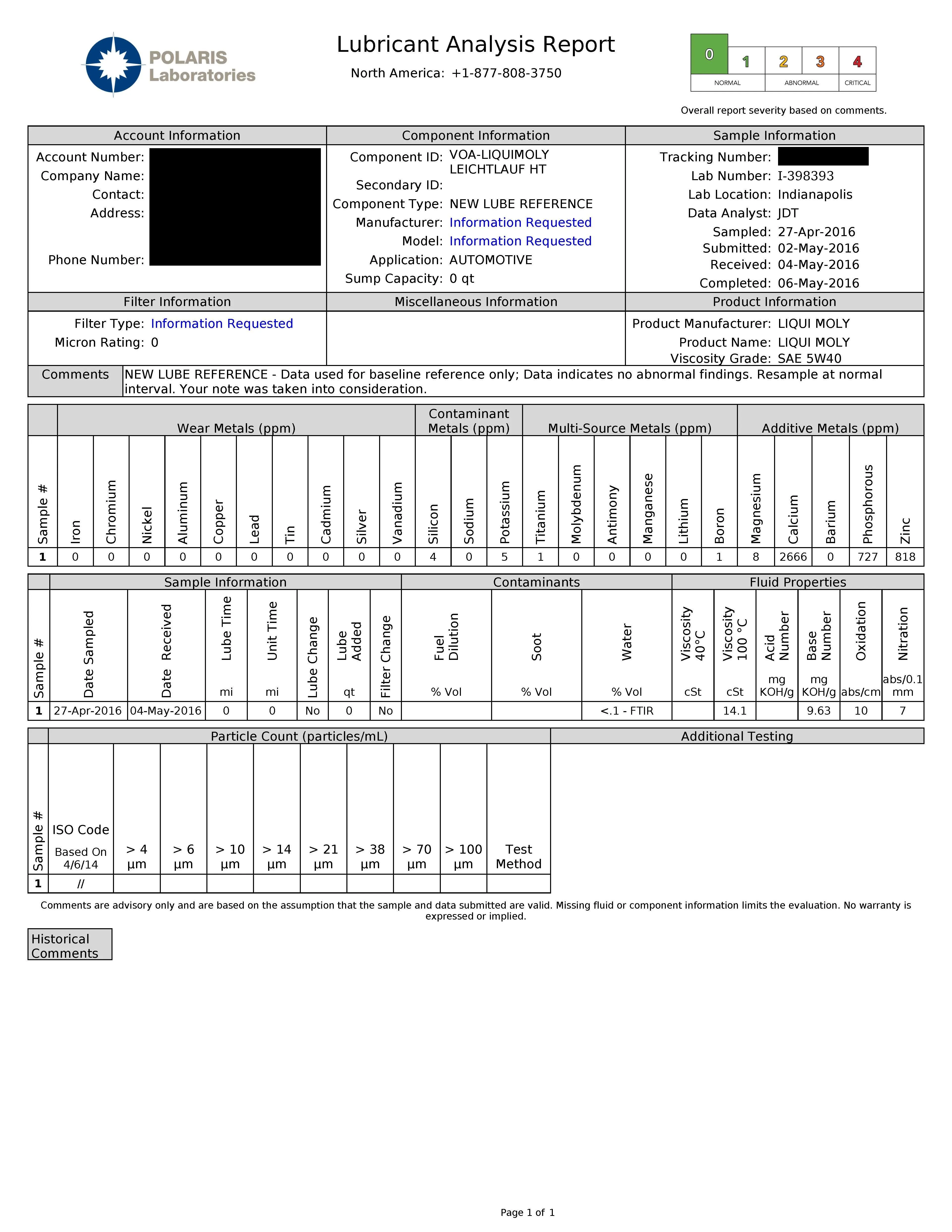

Doesn't mean it has moly. You'd have to perform or find a VOA. Rotella has moly in it and it's not listed anywhere on the carton. Liqui moly says "moly" and doesn't even have moly in all of it's oils (mis leading). Look up liqui moly VOAs some of them have impurities which means lower quality base oil. They (LM) actually sell a moly additive that you add to oil. Also it basically lost to amazon basic oil in a test lol.
