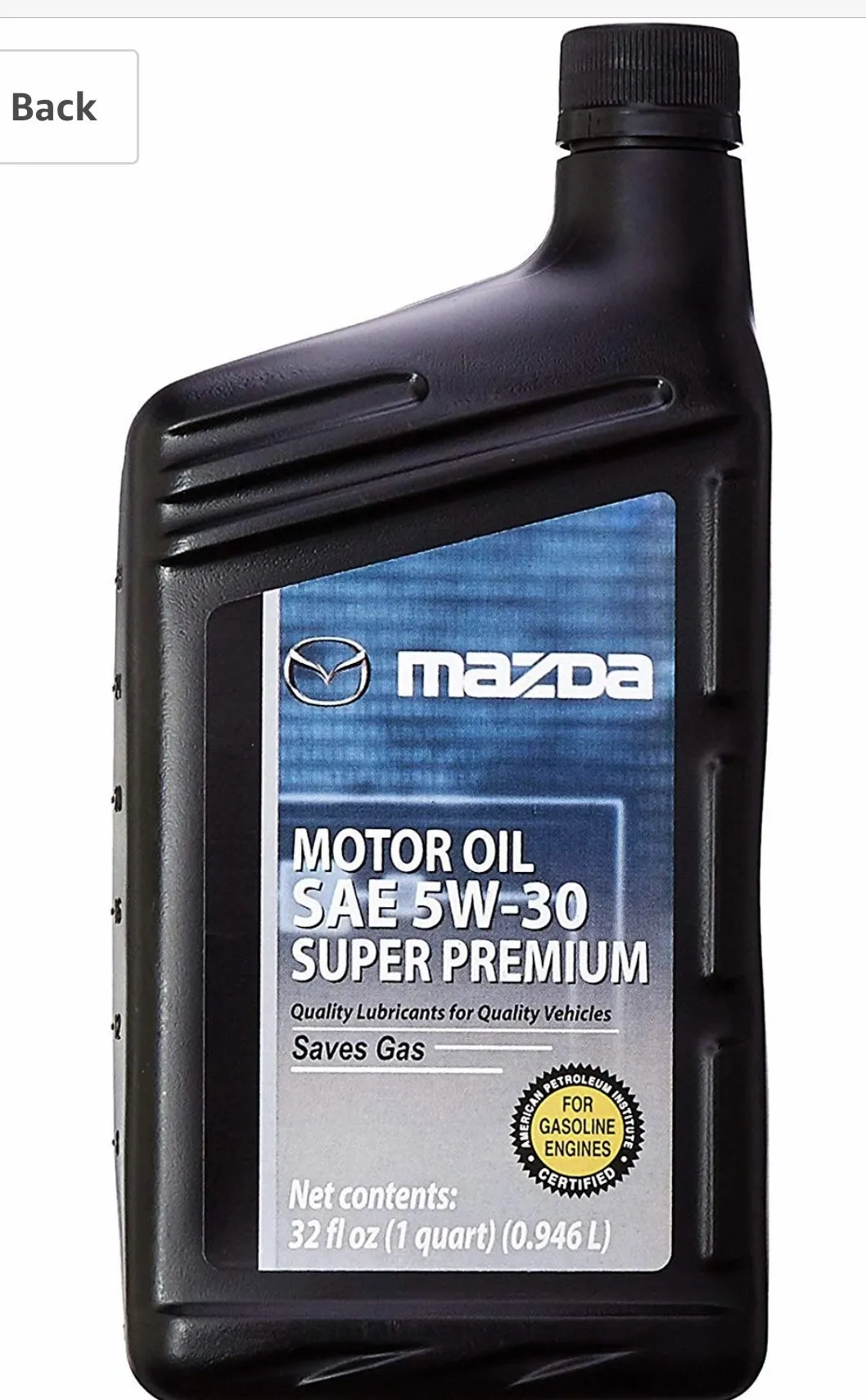

First complimentary oil change (4700) miles.I ask no less than three times,full synthetic please,do you have/use FULL synthetic?Yes sir,full syn it is.Pick up car,go home look at invoice,6 qts. PN 0000-77-5w30-QT SAE 5w-30 SUP PR. Do a little digging on these forums and Mazda sites,no where can I find oil is identified as synthetic.Call my dealer,kindly state i Believe this oil is rebranded castrol gtx conventional oil.He says he will check with parts..comes back and tells me I am right it is a semi-syn,which I still doubt...So the non turbo gets full synthetic,turbo gets at best semi syn.Makes no sense...They are draining and refilling with my supplied Castrol full Syn. Comments welcome.

Yep, this Mazda Genuine SAE 5W-30 Super Premium Motor Oil with part number 0000-77-5W30-QT is indeed a re-branded Castrol GTX conventional oil which has been around for at least 40 years. I’ve been using the GTX since that long for all of my vehicles except my recent vehicles including a 1998 Honda CR-V with 187K miles which is still in service for me.
In fact, some early gen-2 CX-9 owners had found this conventional oil was used in their 2.5T by their Mazda dealer and posted complaint about it in CX-9 forum.

When I started this thread my intent was to #1Vent #2 Let us reserve and signature owners know the recommended oil,Mazda PN#0000-77 5W30 is not synthetic or semi syn.In fact it is most likely rebranded Castrol GTX conventional.I have never seen a semi or full syn.not labeled as such.#3 Our dealers are fed corporate bulls*** to keep us happy....To those that may ask why use synthetic oil,the only question should be why not.I may add in both my 168k 30 year old BMW and 194k 14 year old Saab turbo,Mobil one 15w50 and 10w40 has kept them burn and leak free running like new. Great forum we have here,respectful and knowledgeable enthusiasts!
