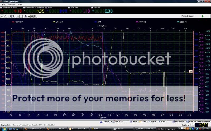

For you and Chris: I have one simple question the answer to which will help a lot of us. Why not hook up a Dash Hawk to your MS3, data log and post the results here?
After all, as soon as you sell one of these to some member here that regularly used this forum and is serious about these type of products, that's exactly what we'll be doing, just as we have with the other ECU modification products, whether flash devices or piggy back.
So, could you please just hook up a DH, monitor the values we think are important to make us comfortable under varying engine rpm and load conditions and let us see for ourselves whether this programmer is going to be a good choice for us?
Please do not tell us that DH read data logs are "proprietary." That's not like posting your tuning maps. Verified DH logs, especially showing boost and AFR's with LTFT data, please, and thank you.
That should either ramp us sales or lead to some very constructive feedback on adjustments that might improve the product.
LOL! But I'm serious. Showing my age by saying this but I'm like the detective Joe Friday in the old Dragnet TV series I watches as a kid: "Just the facts, ma'm or sir. Just the facts."
I hope we do get to see those logs. We'll be seeing them one way or the other, anyway. They might just have a very good general 90% there tuning solution that might be better than Cobb's off the shelf tunes, or at least competitive with them.

I am looking into getting a dashhawk to do this. I am broke at the moment from buying an M4 lol.

Dash Hawk came in today.

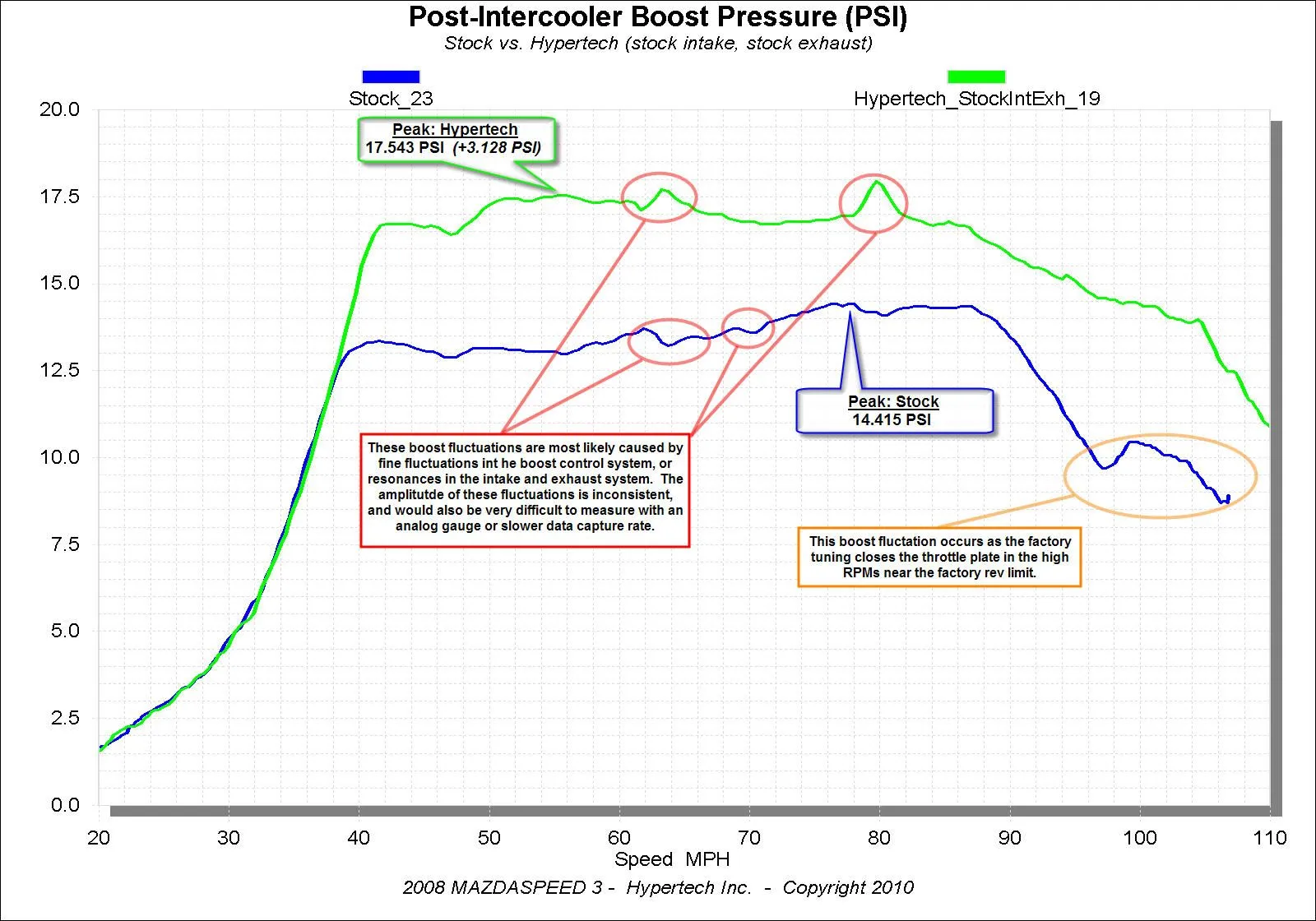

On a stock car, we measured a peak of about 17.5psi with the Hypertech tune, while the stock tune peaks at about 14.5psi. This was measured in 4th gear on our AWD Superflow dyno.

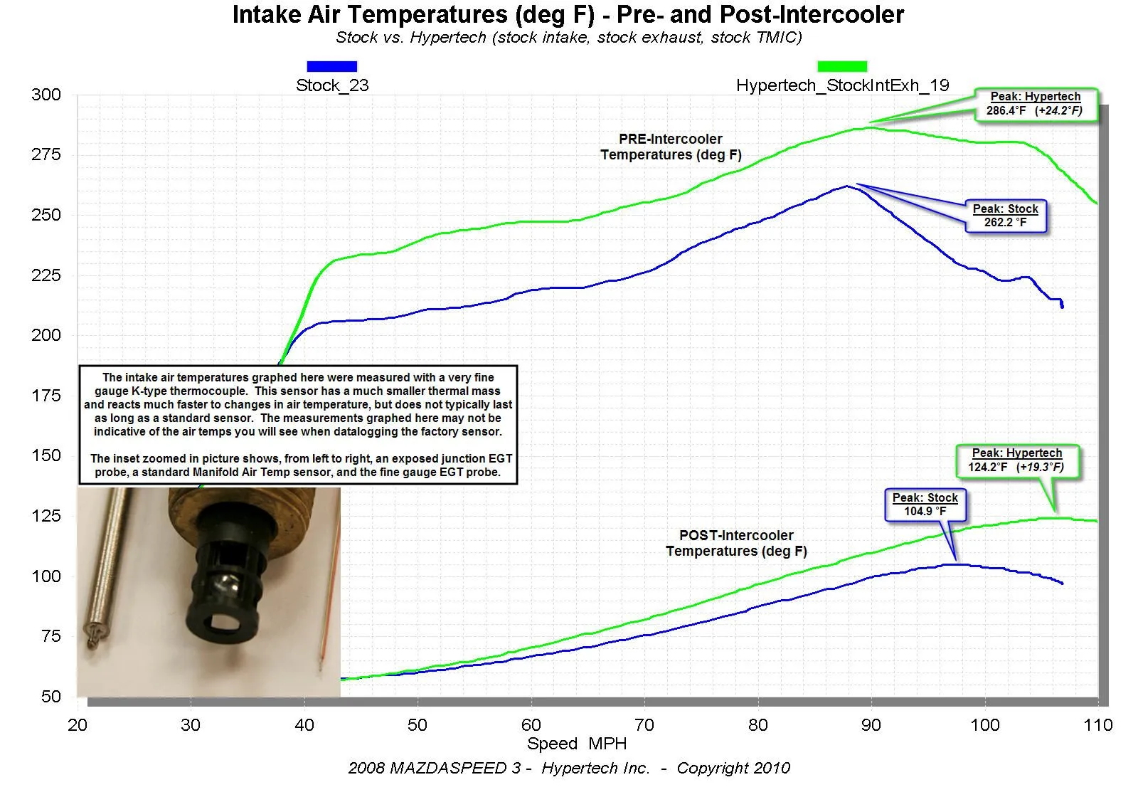

During the same dyno pulls, we measured a peak-to-peak increase of about +24F pre-intercooler, and about +19F peak-to-peak after the intercooler. These temperatures were measured with a fine gauge thermocouple that reacts much faster than a typical intake air temp sensor, so dont be surprised if these numbers are slightly different than what you measure with a datalogger. Our readings should be worse, if anything, during a similar test. This JPG does have an inset picture of the sensor we use, but it is still hard to tell that the sensor consists of two hair sized wires.

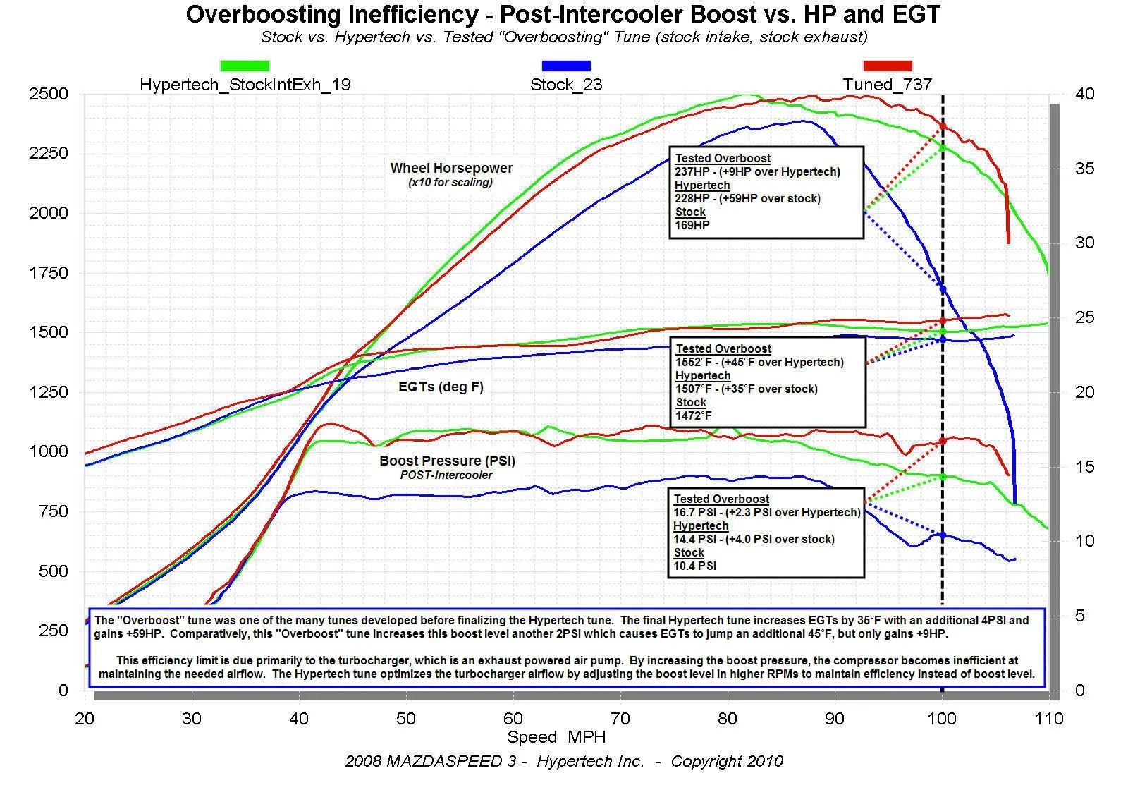

The boost curve the Hypertech tune was developed through extensive testing, and during some of that testing we tested a tune that maintained the boost pressure all the way to redline rather than dropping off in the higher RPMs. The overboost tune pushes boost up another 2psi and the result is about +50F and only +9HP. The final Hypertech tune increases boost 4psi over stock at the same point and only bumps EGTs +35F and makes +59HP. That additional 2psi just isnt worth it. Theres a lot of info on this JPG explaining what we measured.

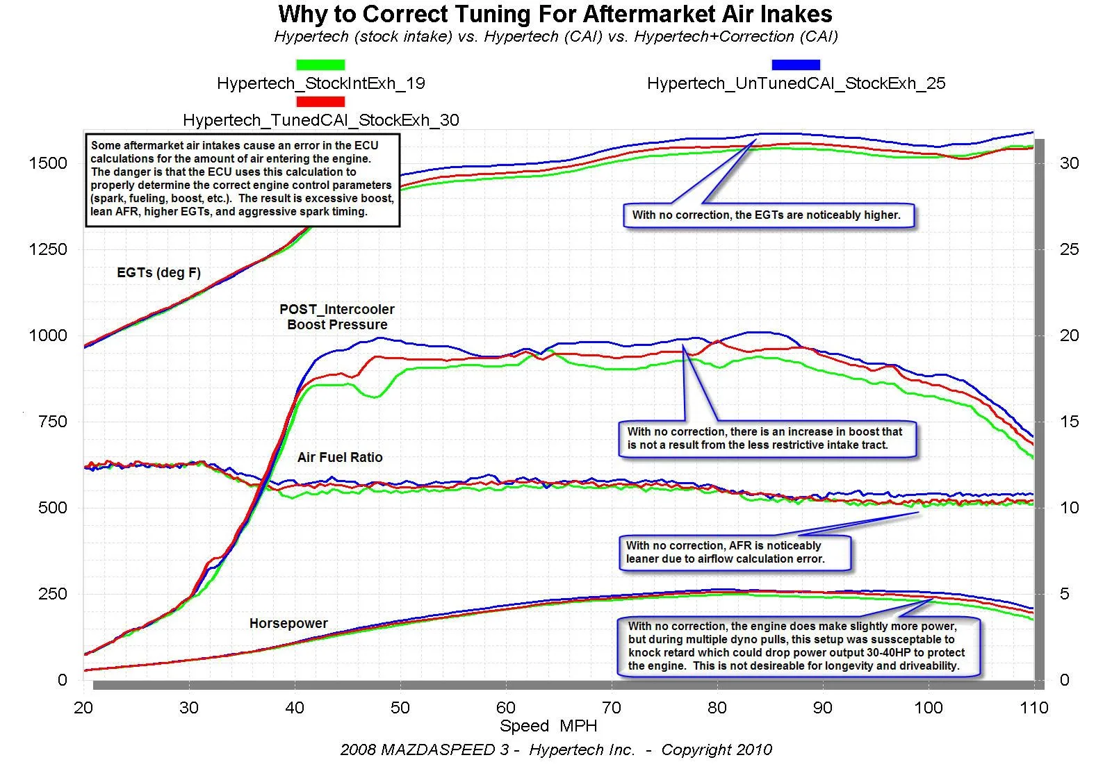

We have developed tunes for several aftermarket air intakes, and are currently adding those to the Sport. These will show up as a new feature. The new feature will ask if you have an aftermarket air intake installed, and then show you a list to choose from. This feature will be a free update for anyone who already has a Sport. It should be available by Wednesday or so next week. Ill keep you guys posted on that.
If you install an aftermarket air intake on the car, the changes to the intake tract can cause errors in the ECU calculations for the quantity of air entering the engine. The ECU uses this calculation to control many aspects of the engine, so a small error here can compound itself quickly. With no changes to the tune to account for these errors the EGTs will get hotter, boost will go too high, and AFR will lean out. By correcting these errors, the ECU will properly control the engine. The JPG goes into much more detail.

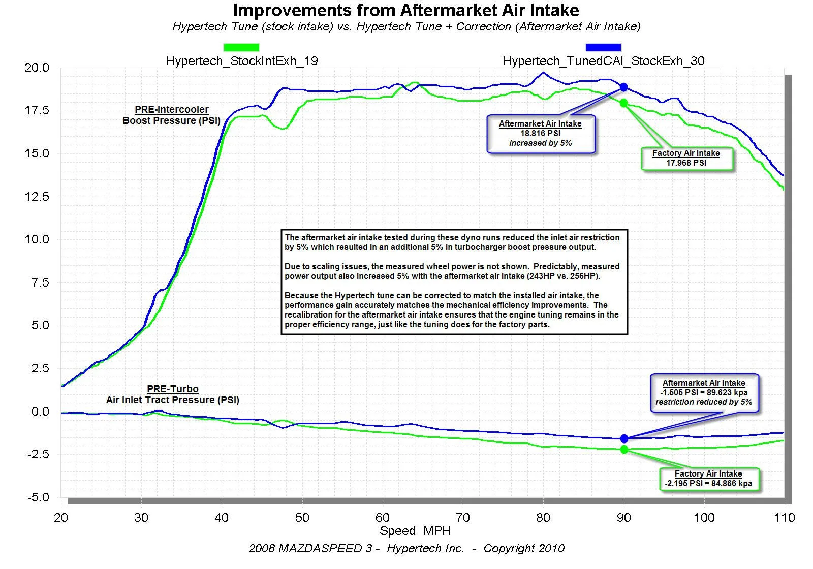

Obviously cold air intakes are popular mods because they make good power, but have you ever wondered why? We did. So, while we were testing we measured the pressure in the intake tract before the turbo with the stock intake and an aftermarket intake to see what happens. It turns out that an aftermarket air intake can reduce the inlet restriction by 5%, and because thats a direct restriction to the turbo, the output boost jumps up by that same 5%. And with more air comes more power. The Hypertech tune provides that same 5% increase in power youd expect when an air intake is added on. The tune is absolutely set to respond to additional mods.
