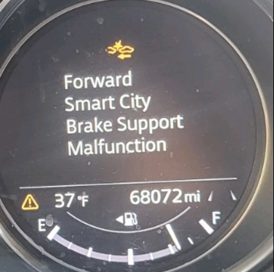

Once in a while my 2018 cx5 touring showing "smart brake system malfunction" and "forward smart city brake support malfunction" error messages.
So I went to AutoZone and done the scan.
Code c0023-62 (Stop Lamp Control-Signal compare failure) came up.
Sounds like my car needs a new brake light switch
My question is:
After replacing the switch,, Do I need to reprogram my car's computer?
Thanks!
Update:
It's been a week since I replaced the brake light switch. Error codes are gone. Problem solved!
