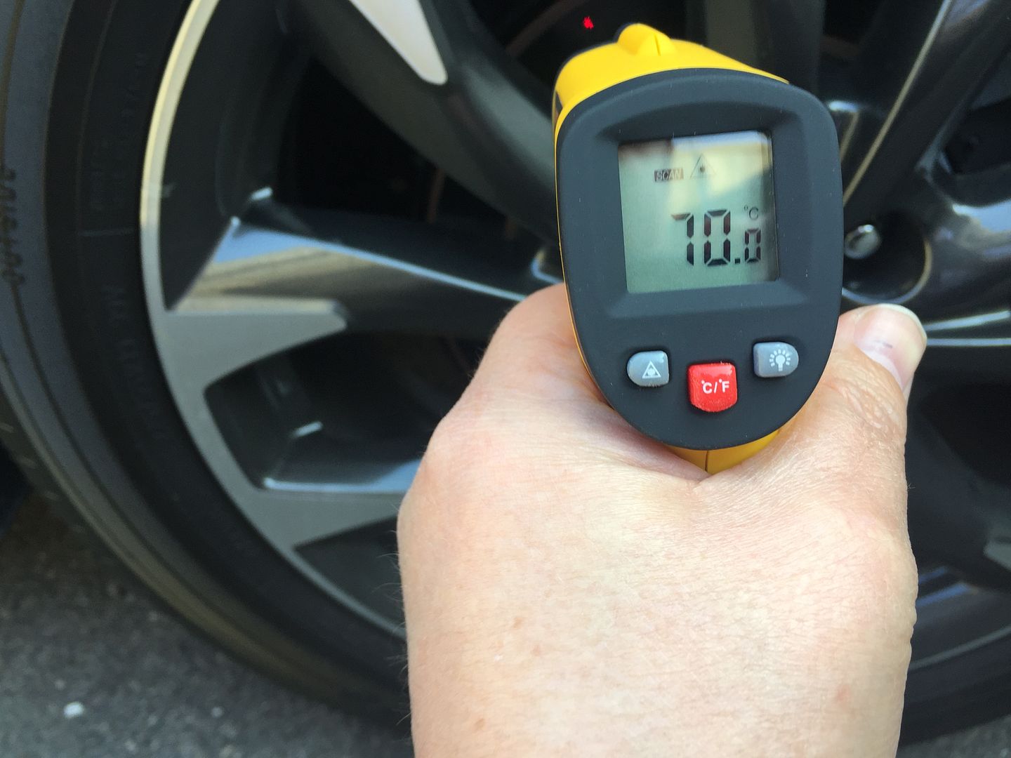

The control module is no longer part of the TSB, they found changing it was not effective. I had one rear brake getting hot. I couldn't feel it but I could see the discoloration of the disc so might be worth checking. They did both calipers, the discoloured disc and a new set of pads all under warranty.

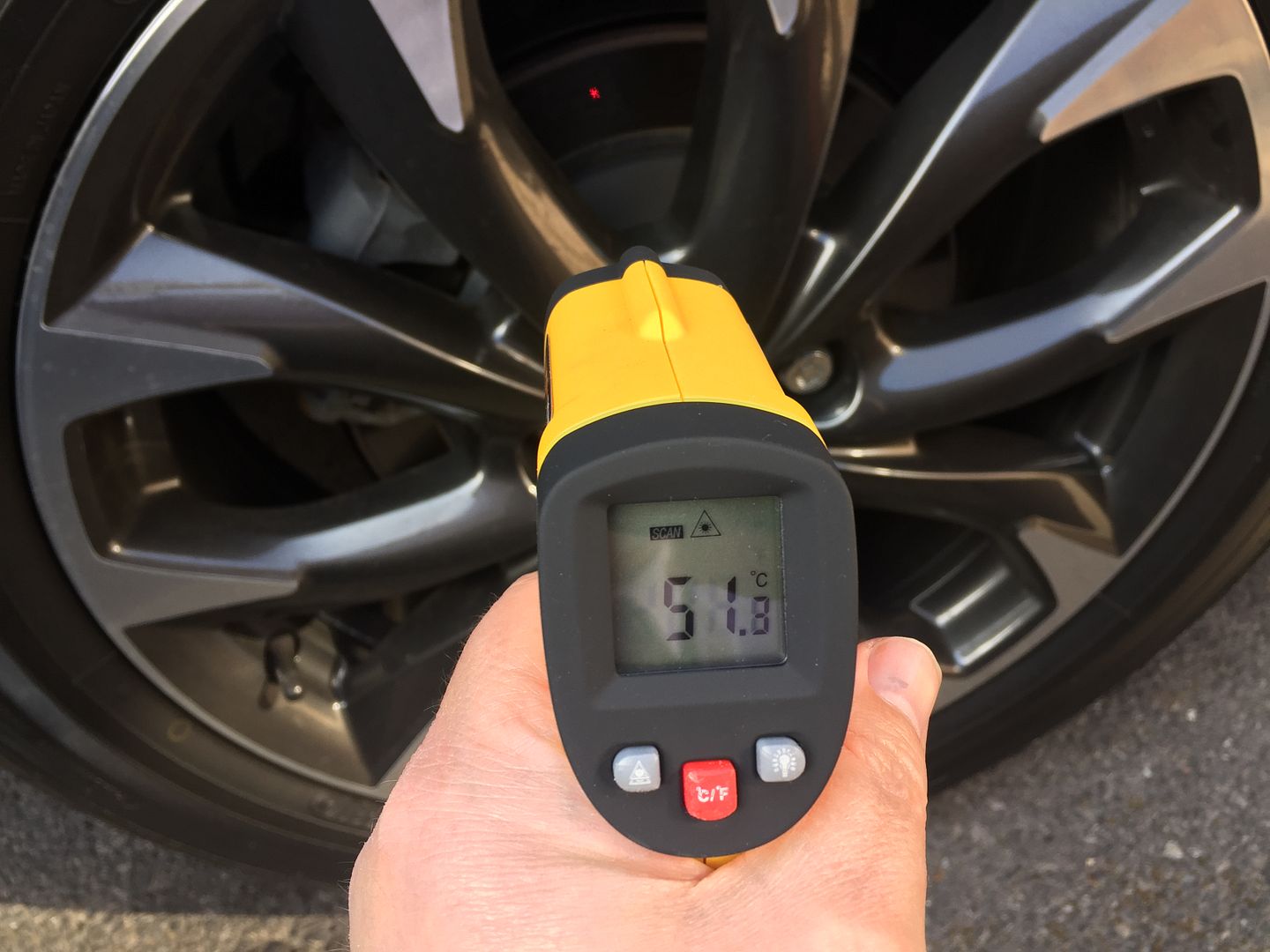

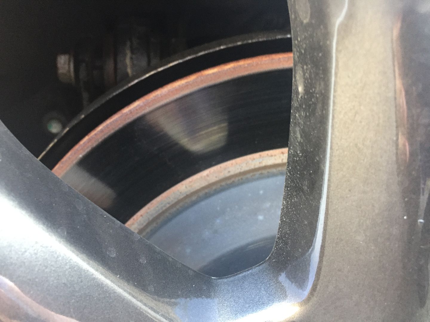

It's perhaps worth mentioning that I couldn't actually feel mine dragging but I did notice the discolouration of the disc. I then paid attention and noticed it smelling one day so I always prepare a case ready for any situation and collected some evidence which I've shown here in photos. There are the two different temperatures and the discolouration. As it was the dealer fully accepted my explanation and changed both calipers, one disc and fitted a new set of pads. Advice then is go and look and if you see anything, get straight on to the dealer.
Interestingly, I couldn't feel any dragging. I was about 1 mile from home from a long journey when the TPMS light and beep started, so I assumed I had a puncture. When I got out the car it was obvious something was wrong as there was a lot of banging and metallic pinging noises coming from the rear nearside wheel as though it was cooking. The heat was intense as i could feel it 2 to 3 feet away. I couldn't touch the tyre as it was so hot. When Mazda Assist came later the wheel had cooled down. We went out again for approx 2 miles with no evidence of dragging and when measured the offending side was already at 55 degrees centigrade and the others were about 40 degrees.

I have the same type of IR gun, guess I'll keep it with me. My car's build date is 8/16, a month before the TSB came out.

Thanks for the tips. Never thought about getting an IR gun for any use but now I think I need one to check the temperature on rear disks. My warranty is getting close to expire and I hope I can find some early evidence to get this TSB performed. It seems dragging always happens to the right rear?

Just had a look. Calipers are late 2015 build. (My car was also a late 2015 build). Discs look fine, I cant see any discolouration.

3. No discolouration of rear discs as previousy noted
