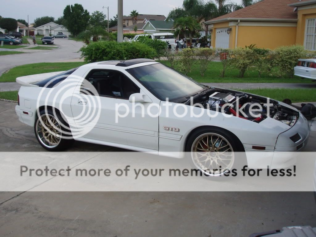

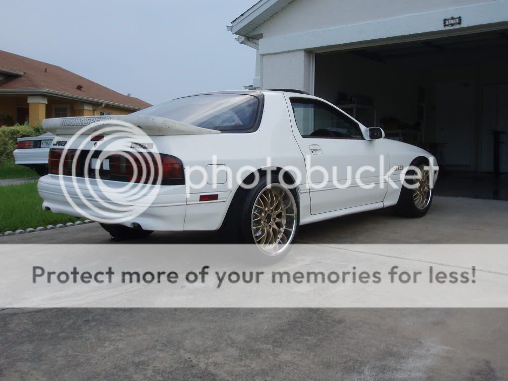

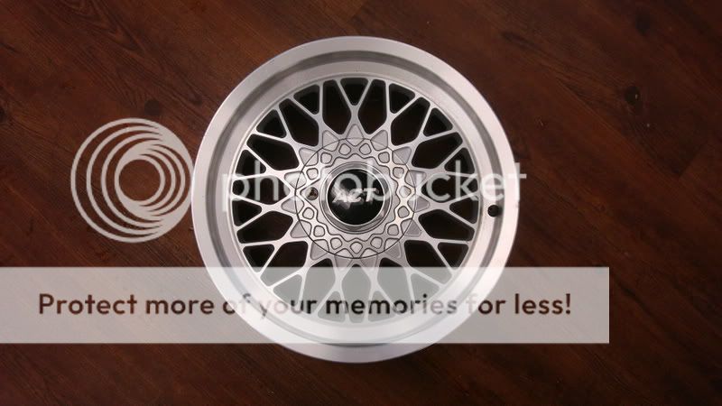

my 7 has ACT 16x8 meshies
on my old vert
on the current car (not a great pic sry)
