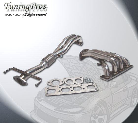

Something more like this? Jimmy you may want to look into this.
And only $79
And only $79
Looks just like mine. I have issues regarding using a flex-tube versus a walnut gasket... but heck, the flex-tube keeps your muffler from vibrating to bits. Good blast of torque, could have a little more up-top "oomph".
