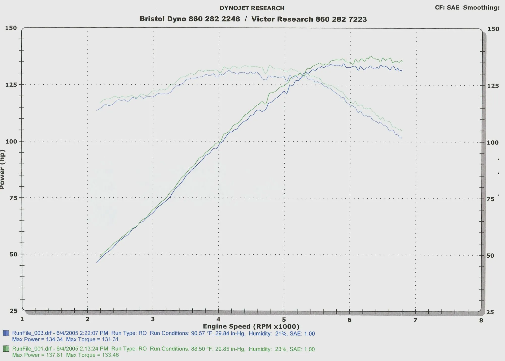

wierd i don't have that dip in the 5krpm range from my first dyno...the only thing that comes to mind is that this was after i did my audio so i only have 1 wire going to chasis ground from the neg terminal and it is 0awg... that and i have the simota sri but either way there isn't a dip in the 5k range.. ???
Thanks for the dyno, tsunami. That much power at 90 degrees, very good! :) May I ask a copy of your run file?
Your graph is very smooth because it's started at at ~2k, so the throttle was requesting the VVT be put to full load right away.
that BCC graph is actually a more accurate interpretation of real-world benefits tell you why in a sec. Imagine cruising at 3K rpm, then all of a sudden, you want to race, and you WOT. The VVT's still in "medium load" until about 5k, where it switches to "full load". Would you really race someone by letting off the throttle until 2k then WOTing to request full load from the VVT right off the bat? No, as the guy you're racing against will probably be gone by then.
Dynos that start at 2k (like my other dynos) are only good to show peak power since you're requesting full load right away.

I can't completely verify this, but think I'm pretty close. According to the Service Highlights Manual, the "medium load" operation ends for the VVT at almost 5K, then switches to "full load" (what happens during that time will be the fuel mixture calculations or A/F map loading, VIS opening, etc). The condenser eliminates that gap, and smoothens the powerband. So downshifting from 4th to 3rd and WOT-ing for example, will yield a smoother acceleration
You should be able to tell what mods are in the filename.
Started at 3K after the advanced timing mod (for stage 2) vs the Buddy Club kit.
After telling the operator to start at 2k instead, we get this.
See the difference? :)
sadly i don't have an electronic copy its just scanned in from my hard copy.. i can send you that if you like???
thanks for clearing that up a little bit the map from the service manual was a bit much to take in at first but after staring at it for a bit and reading what you said it makes sense now, and the different "dips" make sense as well, i have another dyno scheduled for the begining of the month i will be sure to ask for one done @2k and one @3k... good info bean!!!
