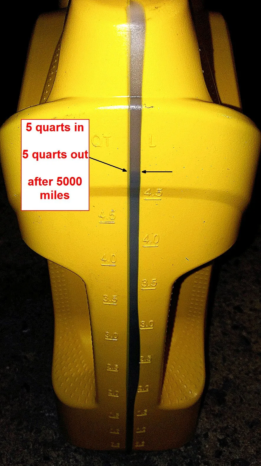

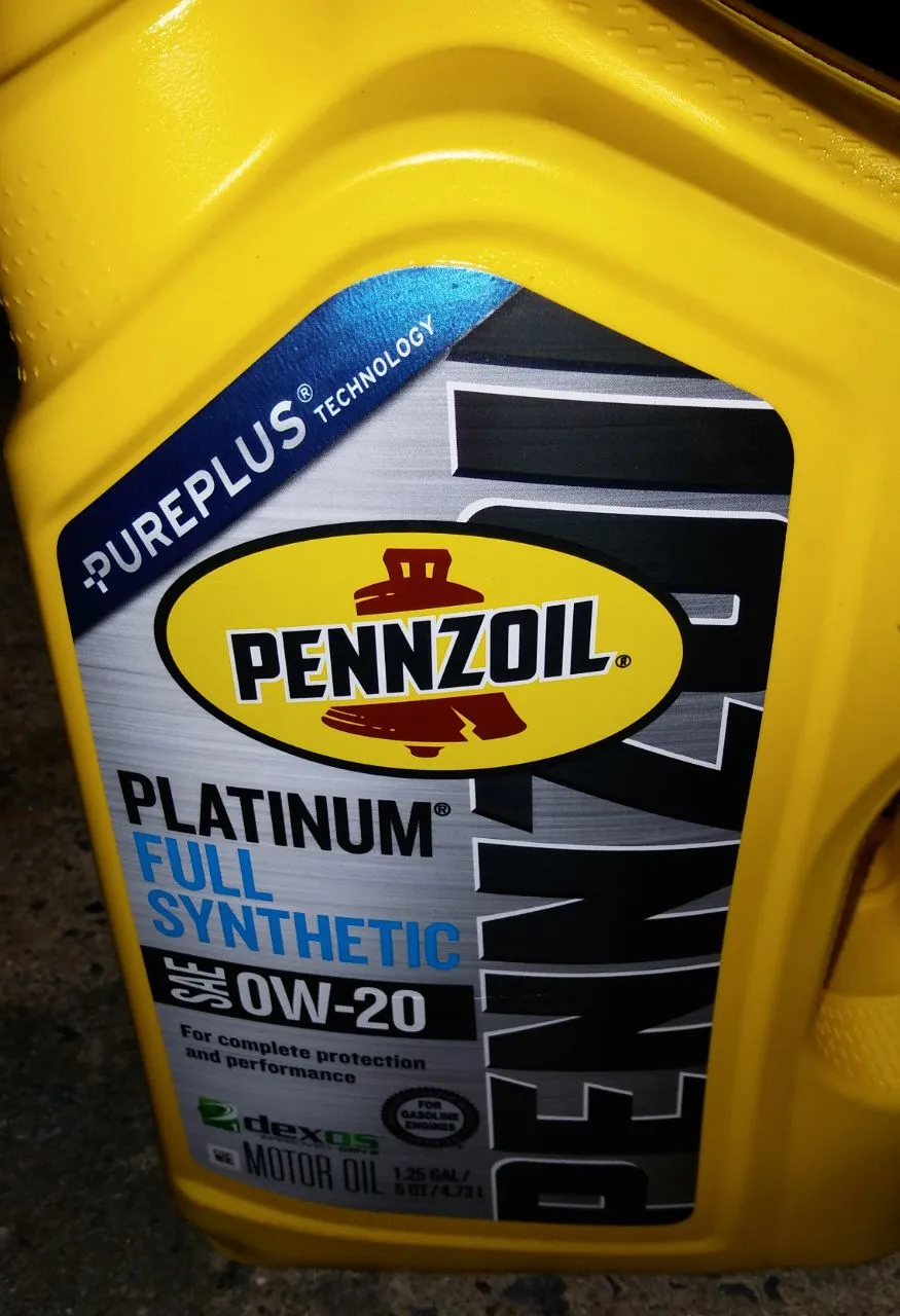

I carefully measured my CX5 2.5L engine oil consumption for the last 5,955 (6,000 miles) when I did my oil change. My engine consumed 6 oz (0.1875 Quarts) of 0w20 PP oil in ~ 6,000 miles. This for an easy driver in a small city. Ed
my measurement is not as accurate as yours but it's close enough for me,
Pennzoil Pure Platinum w/ K&N HP-1008 oil filter (US made)
after 5,000 miles :
5 quarts in ~ 5 quarts out, no evidence of oil consumption , just sharing, your mileage may vary.....

Our 2014 CX-5 2 liter has always burned about 1 quart of oil per 5000 miles using Mazda super-molly oil. When I started using Mobil 1, same weight (0-20w) the consumption dropped to nothing at all. At 7500 miles it is still right where I filled it.
I can confirm this, I've always used the Mazda OEM moly oil, when re-filling the 5 empty bottles with old oil, I always run out of used oil after the 4th bottle. See my above post after I switched to Pennzoil Platinum, not saying the Mazda moly oil is bad, just sharing that I see the same thing as you with Mazda moly oil (1 quart loss after 5,000 miles).
Moly always burned for me as well, more like a quarter quart per 6000 miles. Pennzoil didn't burn at all.
