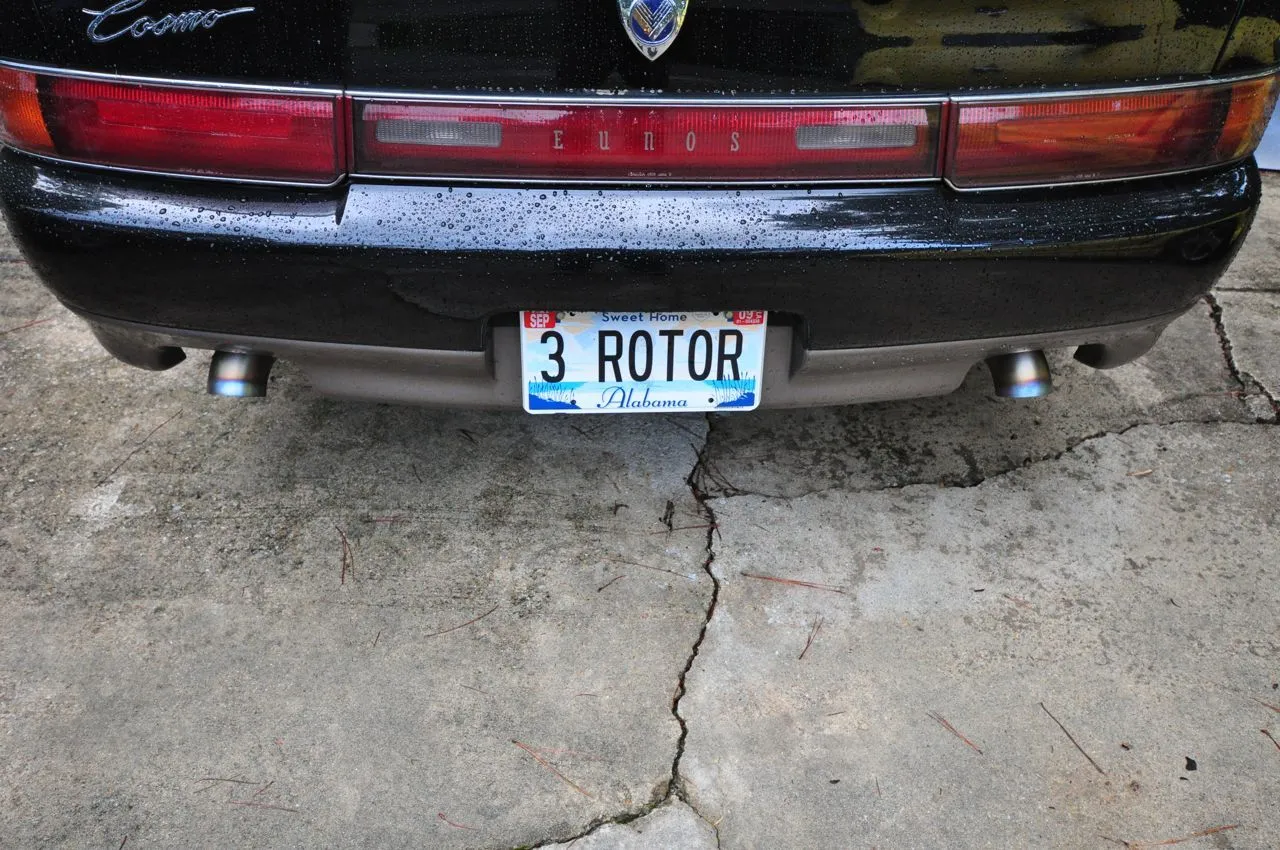

Update..
Description: Eliminated pre-cat x 1, main cat x 2, silencer x 2, muffler x 2.
All stainless steel 2.5 inch stock DP to 3 inch all the way back and straight. 1 x 1 to 2 out larger SS Magnaflow muffler to 2 x 3 inch SS Magnaflow mufflers.. Custom SS Dolphin exhaust tip.
Car spools so much better and it has a deep throaty tone. It also feels like I gained about 25-40 HP.. But that's with my butt dyno. The stock exhaust was all rusted and was falling apart...

Just goes to show how restrictive the stock exhaust is...That's quite a few canisters to go through!
I'm not surprised your experiencing a very noticeable difference with the new system...From bone stock to a custom 3" system with a 2.5" DP...That's got to be like a "night & day" difference!
How about your local state laws/emissions rules? How are you able to run sans cats etc on a car that's not pre-'73?
As for the tips...I've seen those before...While I dig straight tips...Those dolphin tips do provide an interesting look! (thumb)
The beauty of living in Alabama... No emissions :) But I'm going to keep my stock cats just in case in the future.
Yeah, it was a hard call.. At first I wanted to look much like stock exhaust system.. but then I remember RE-A dolphin tips and thought, why not!! Lets go JDM :) The blue tip was my fabricator's thing.. And I think it turned out great!

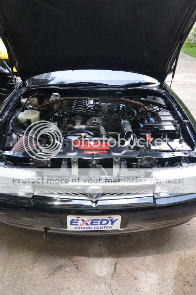

Update...
I took the UIM and IC pipings off to put on my black powder coated stuff.. During my swap, I've took the cooling line to/from TB and bypassed it.. So far, everything looks great!! I'll snap some pics once I get the rest of the powder coated stuff on.

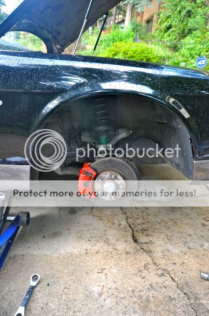

Updated pics... Installed my Tein Coilovers, powder coated goodies, etc..
Coilover..
Engine bay with some powdercoated goodies..

Looking very nice. What spring rates did you end up using in your coil-overs?
Berty, I'm not sure.. I did talked to the guys at Tein about them and I think they are 500-600 front and 4-500 rear.. But I can't recall but I don't think they are beyond those. Another good thing about these are that they are rebuildable by Tein and here in the states vs. sending them off to another country.
