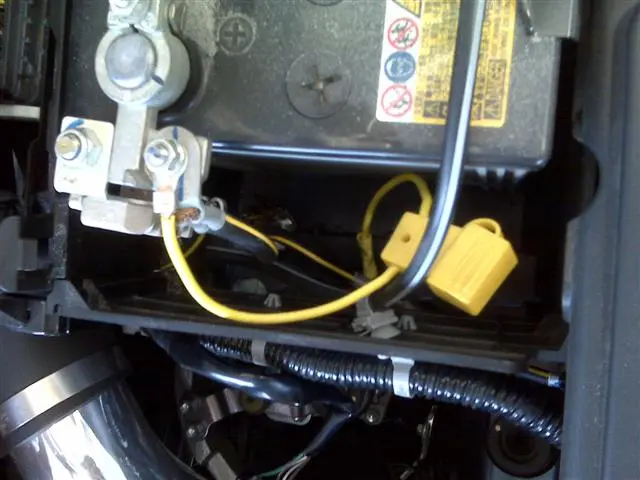

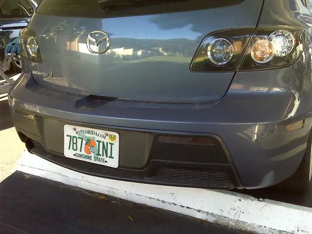

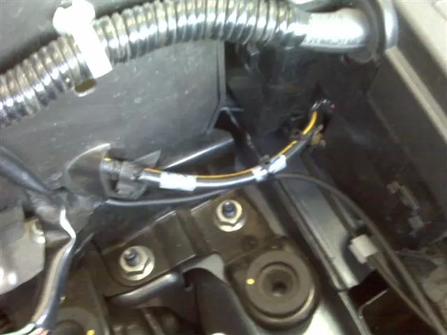

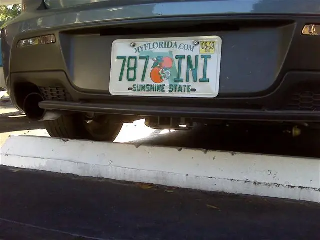

Pics? I am especially curious how they did the wiring...
I will have to take some with my camera phone or something and post them up. Honestly, I haven't even looked at how they rigged it. I can see it when I bend down and I was satisfied with just knowing it was there.
As for the wiring, I have the light hookup dangling in the trunk. So if you open the hatch and look down, the wiring is coming out from under the board that covers the spare tire. You can pull more wire if you want or tuck it under to hide it. I just plug it into the trailer and then close the hatch. It didn't do any damage to the wiring.
Oh, and they mentioned that they had to connect it directly to the battery on this car. I really need to take a better look.
Interested in the pic.
Tks
I didn't take a pic last night but I will when I get home after work today. I'll take one of the trailer/bike and then the hitch underneath the car and how the cables look in the trunk. I haven't looked at the battery yet so if it's shows anything, I will snag a pic of that too.
Ok, so in these pics, you will see how the hitch looks on the car, what the trailer looks like and what I was towing. I also added pics of the battery wiring and the rear light hookup. Yeah, I know, my car is dirty but really, I haven't even been driving it that much since the riding weather has been absoutely perfect around here.

I just looked on the Uhaul website, went to the hitch section and put in the data for my car. Got the part number and called them to ask how much it would all be. A couple of days later, it was installed on my car with wiring and everything was cool. I didn't take a pic of it but the wiring was done directly to my battery and then run along the bottom of the car on the outside where it goes back into the trunk.
They had to drop the rear suspension (I was told) in order for them to be able to get this hitch installed. Said it was harder than most. Just a heads up in case you DIY.
I love mine and never notice it when I drive to work and stuff. Actually, I have yet to see it unless I bend down and look under the rear bumper which is never.

Anyone know of a wiring kit for towing that doesn't require me to run all the way to the Battery? Something I can just hook up in back? I'm about to order the Curt 11384 which seems to be everyone's favorite, correct?
Thanks in Advance, I cant believe how long ago I started this thread..LOL
Tom
11384 is what I ordered and was recommended. I haven't hooked it up yet, but what you could do is get a small battery and somehow set it up so when you need to use the wiring kit, just put the battery in your trunk. Obviously you'd have to make it nice, maybe a small enclosure so it doesn't move around, etc. And you'd have to charge it each time before you use it.
Just a thought... I had a winch on my car-trailer, I basically did the same thing with that setup.
i wonder if you could just get a marine type of set up for something like that maybe like one you would use for a trolling motor
Yeah and mount it to the trailer. Theres no Constant 12volt source in the back of our cars? Why do we need to go to battery?
Running all the lights on the trailer from the small wiring that goes to the little light in the trunk wouldn't be safe. Not to mention the trunk light only comes on when the trunk is open. You want the trailer lights to come on when the headlights are on and when the turn signals are on and when braking. It's a matter of splicing into several wires going to the tail lights. Its complicated. If someone comes up with a DIY I wanna see it.
