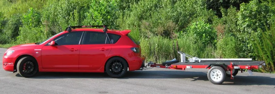

I also have a harbor freight setup:
e-trailer item # 119130
Total cost to build was around $500
I use plywood instead of aluminum..since it was way cheaper and only going to use the trailer for trackdays (~ 8 a year)
I get around 29mpg...highway - doing the speed limit.
