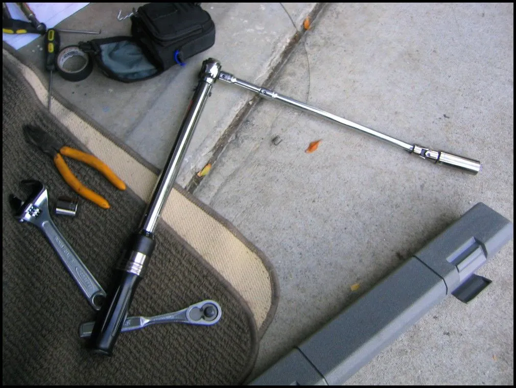

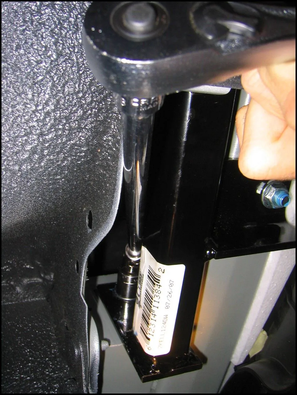

What method did you use to tighten the upper nuts? My tool collection appears to be lacking...
For those that installed the Curt hitch:
Ratchet with a wobble extension...
Good luck; I love the Curt hitch.
-N

1)
I'd remove the bumper, it doesn't take too long
and then I'd go at it with a torque wrench and torque to 65-70 ft lbts with red loctite.
If you installed without bumper removal...then remove it one weekend and torque with loctite....just my 2 cen ts
