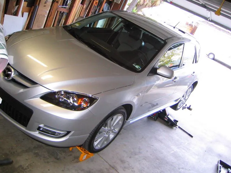

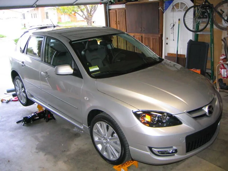

Just got my curt hitch delivered. Did you guys jack-up the rear end of your speed3s to install? Or did you somehow magically install it while the car was on the ground? I can barely get a drill under there (while on the ground) to widen the required holes. (shrug)
Yep, jacked up the rear...
