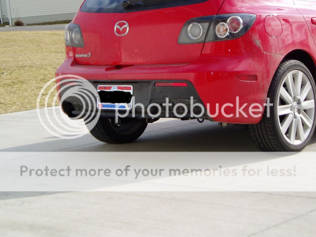

Installed:

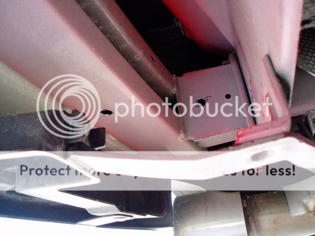

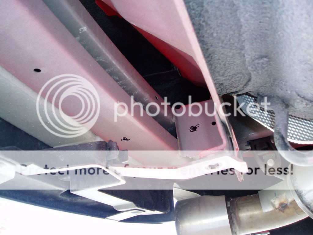

Marking the 4 holes (2 shown):
Drilled to 1/2'':

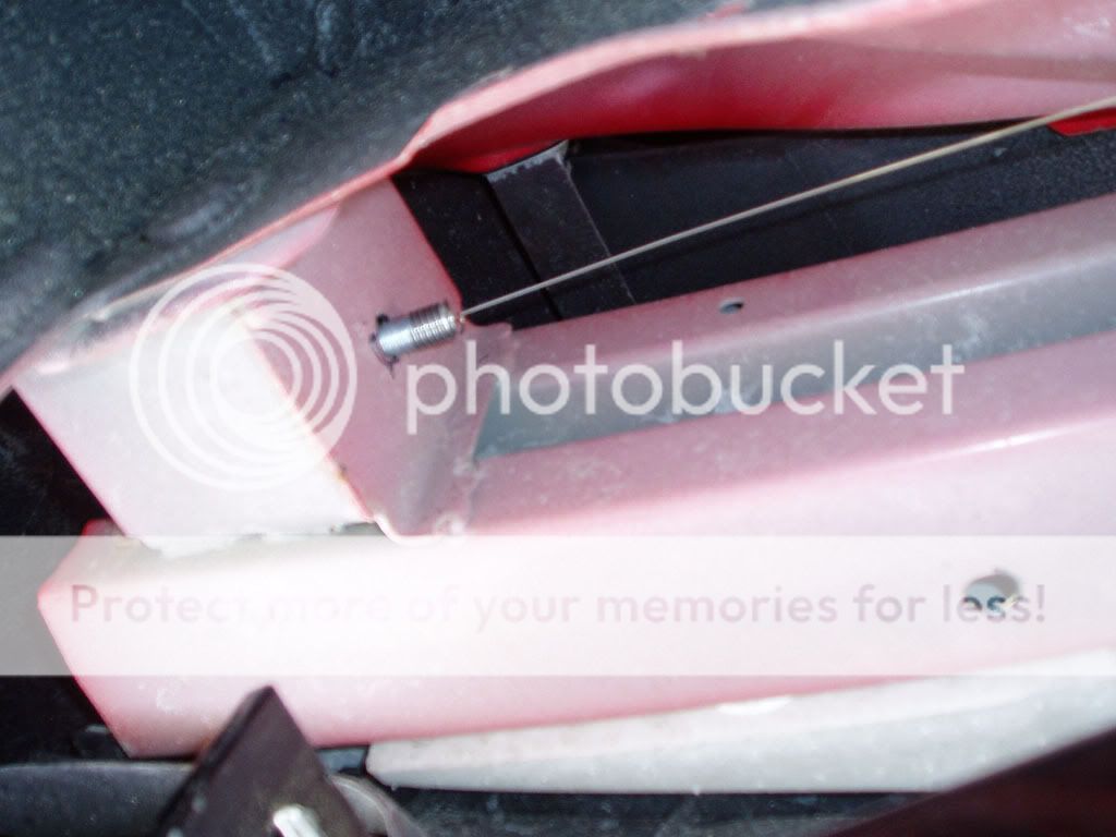

Pulling wire:

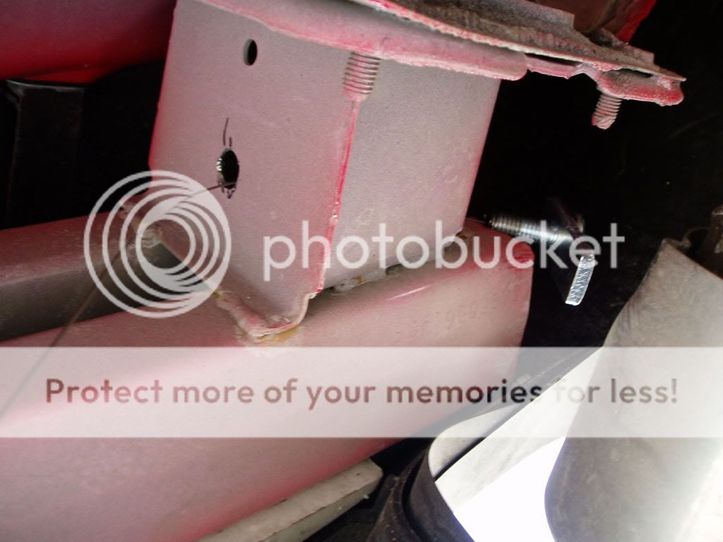

Bolt in:
Needed to add 3 washers on the 2 inner points to get proper level (this was a b****):
Final Product:
Very clean. I like it. Took about 90 minutes to install. About a 4/10 on the PITA scale.
Weather permitting I will try it out tomorrow and go bike 30 miles or so...
(headbang)

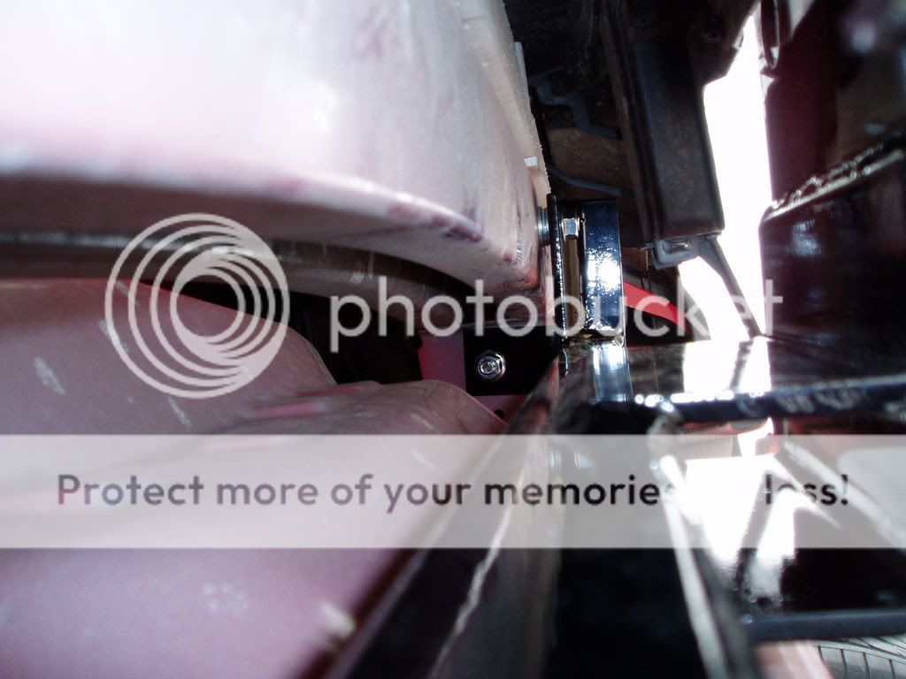

My receiver would have been slightly touching the rear plastic (under the license plate) if I didn't slightly adjust the angle.
Maybe it wasn't required, but it seemed like having the receiver coming out the back straight made sense.
It could have been slightly dimensional differences between our cars, the hitch, or how we drilled our holes.
Weird, I would have assumed all installed would be identical...
Makes me want to recheck my install now... I know mine did not fit 100% perfectly...once torqued, everything came together.

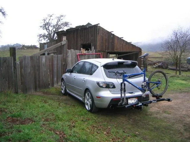

In case anyone is curious, the Thule 912 is an awesome bikerack. It is built like a tank and will last forever. I feel like I stole it for only $117. It is a s***-ton better than the Saris rack I had on my last car.
I just got back from my biking, and I am loving the utility of the MS3. (mj)
Here's my setup. I love the Curt hitch.
I did end up having to fish all of the bolts from the same side of the hitch, during the install. For some reason, there was a blockage that I could not see, when I tried to fish the passenger side bolts. This required lengthening the supplied tool with a coat hanger.
It is interesting that some of you felt that the material that you bolted the hitch to was soft. Mine was definitely steel, and very, very, hard. I burned through a few decent drill bits enlarging the holes.
I burned through one high speed steel bit before going with Titanium Carbide for the second. I was definitely drilling through tough stuff.
That must have been a b**** fishing in from the far side...
On the inner driver's side hole, I had to send through a couple of zip ties and duct tape that to the wire so I could pull the wire through the hole.
The other side just happened to pop right out through the hole (dumb luck after about 10 seconds). I gave up on the other side after about 10 min and used the zip ties and duct tape.
