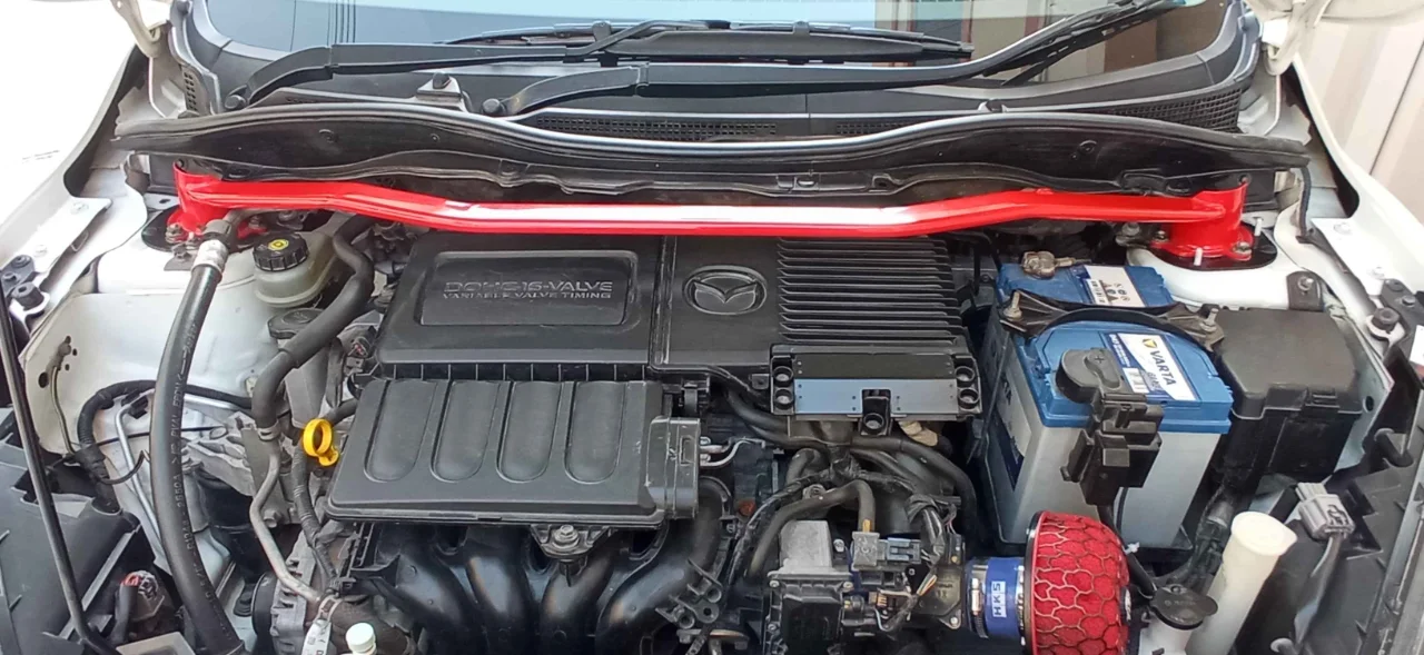

List of mods:
1. HKS induction kit (Racing Suction:DEMIO)
2. HKS Silent High Power (silent Hi-Power:DEMIO)
3. Autoexe front strut bar (Increased Body Rigidity | AutoExe Mazda Tuning & Customization)
4. Endless MX72 Plus break pads (ENDLESS OFFICIAL WEB SITE)
5. K-sport street coilover (STREET |)
6. Camber bolts
7. Exedy stage 1 organic clutch (MT Sports - Stage 1 Organic | EXEDY Clutch Europe)
Wheel: Mazda wheel design 144. Size is 16" by 6.5" PCD 4x100

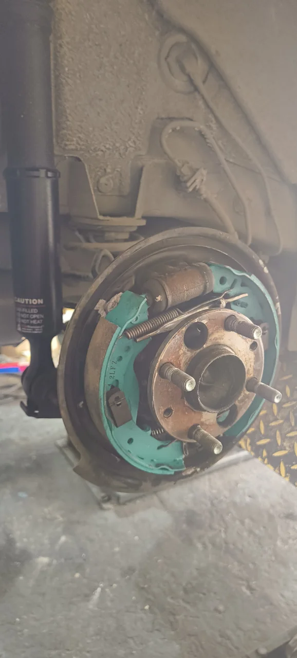

Regarding my break rotor size it is 258mm, where I am from most are 1.3 and come with 239mm rotors. I have just ordered project μ rear breaks shoes from japan because I needed to buy replacement pads for the front so I got those aswell. I have heard a lot of good things about adding a sway bar on the back but at this state I am trying not to spend more money on the car because I already drive it really hard and it doesn't make sense to try and make it faster. Currently saving up for an Mrs (it's the 3rd gen mr2 in the US).

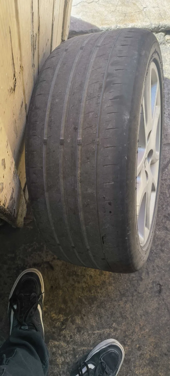

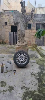

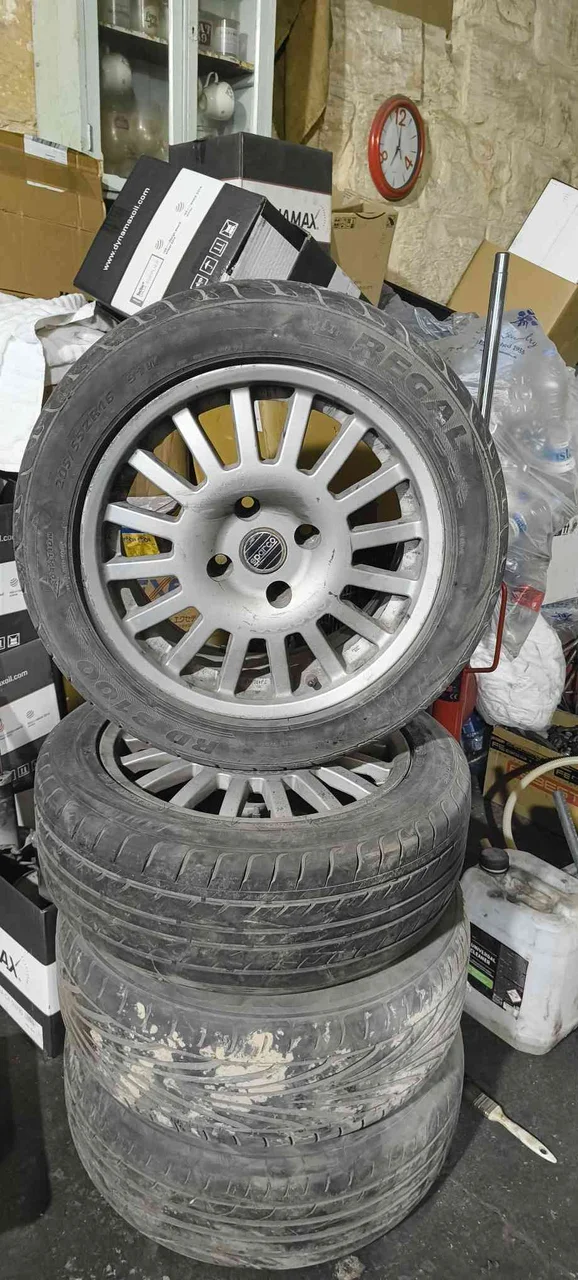

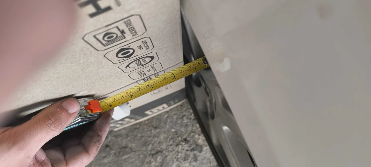

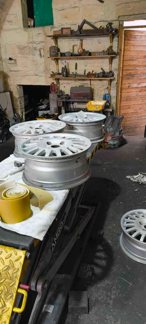

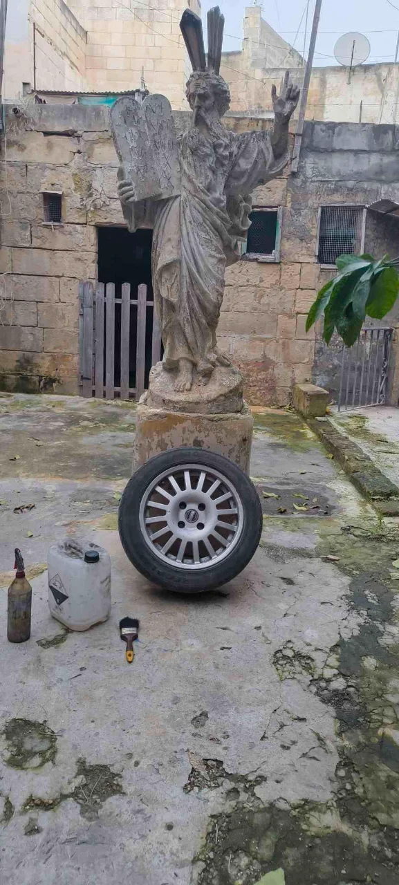

Bought these Sparco Cromodora wheels CD853 16 by 7j et40 for really cheap and now I am refurbishing them. I weighed a wheel which was 8.5kg, once I get the OEM wheels without a tire I will weight them as well. I am going to need to run a 4x100 to a 4x114.3 converter and see if i have issues with rubbing.

Small update, currently the wheels are sanded and ready for pain, they have been for a while but I been really busy working on my thesis and I'm looking at getting them painted by a professional. On another note I have been looking to buy bucket seats for the car, if anyone has any fitment tips. Also thinking of maybe buying front and rear autoexe subframe braces since I can get them for quite cheap used from Japan. Anyone have them?
WRT "I weighed a wheel which was 8.5kg, once I get the OEM wheels without a tire I will weight them as well."
15.3kg for 185/55 R15 Tyre on the OEM Standard Factory Steel Rims J15 x 6 J DOT 3 10 / 6 LR31
Tyre as Dunlop Sport at nominal 60% of residual tread.
