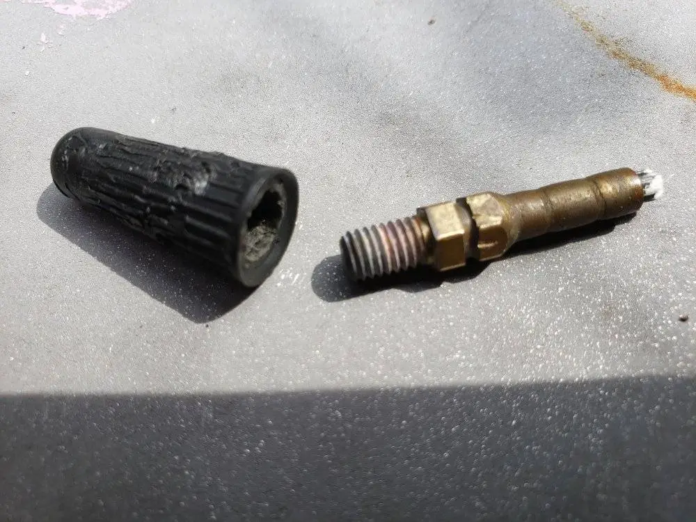

Pull back plastic base nut cover. Use 6mm combination wrench/pliers to remove and tighten new antenna. Slide base cover over nut.
