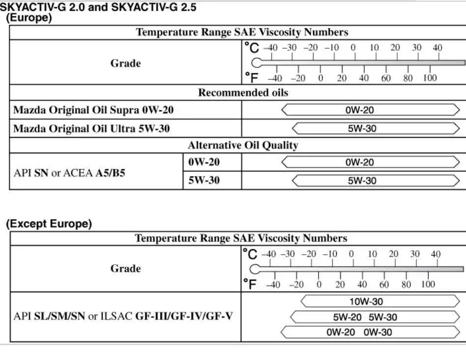

While going up from 0W-20 to a 5w-20 after the warranty period is over might be feasible, you have to wonder if a heavier 5w-30 weight will circulate thoughout the engine with all these tight tolerances on these new engines.

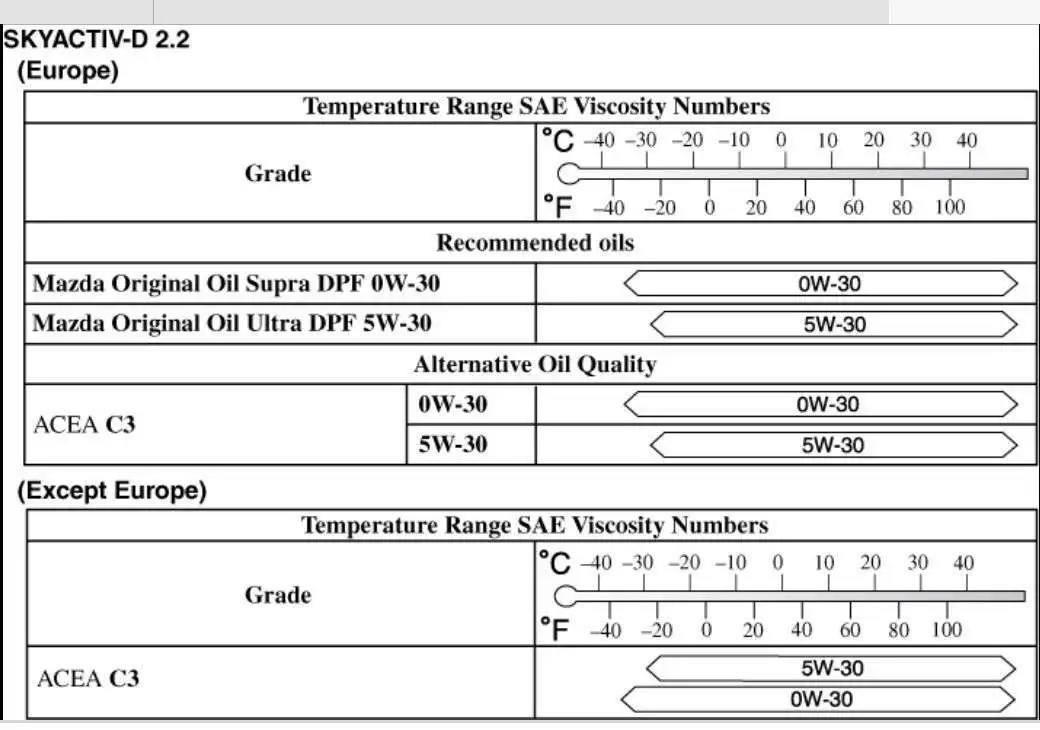

No need to wonder. Here are Mazda official engine oil viscosity charts for SkyActiv-G 2.0L / 2.5L and SkyActiv-D 2.2L used in Europe and worldwide, and 5W-30 oil is listed as recommended oil by Mazda:

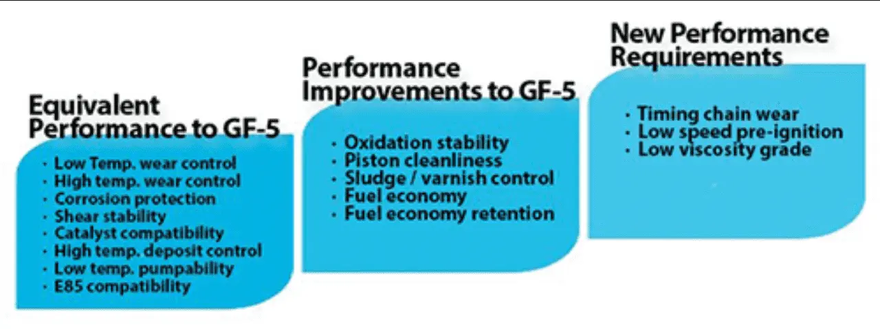

I'm not sure what to make of this:
"Sequence VIE – Requires 19-39 percent improvement in fuel economy, depending on oil viscosity."
This cannot possibly mean a 30.0 mpg vehicle will magically transform into 35.7 - 41.7 mpg vehicle.
I agree. Some marginal improvement on mpg is possible with GF-6 oil; but not 19 ~ 39% improvement!

From the article ...
Compared to older GF-5 motor oil, five tests in the center require performance improvements over GF-5, and the three tests on the right are brand new for GF-6 that were requested by the automakers.
so, that 19-39% (depending on viscosity) is an improvement over what GF-5 achieved.
So if GF-5 made a .1 mpg improvement on overall economy on a car (say 30 to 30.1 mpg) then GF-6 would be 1.39x.1 or .139 mpg improvement over all to the car.
So to your real world economy of your wallet, you would see your 30.1 mpg car now get 30.139 mpg (best case) because of the change of using GF-6 oil.
that's how I see it anyway.
