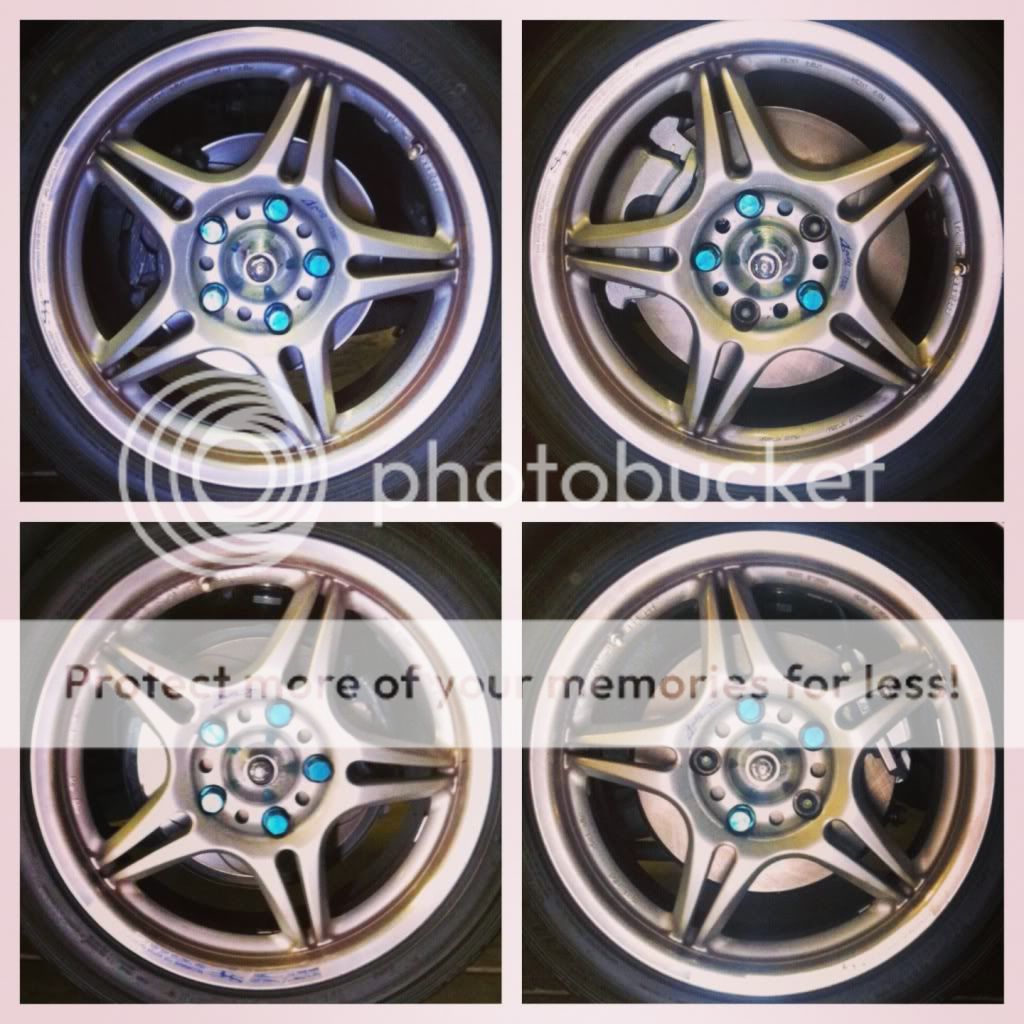

Stock on left, MZ6/626 on right

OK,... that sounds right,... I found some pics.
