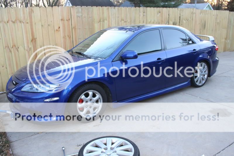

Glad to see this thread is still kicking. I moved my MZ6 fronts to my MSP a while back, going to move the rears today.
