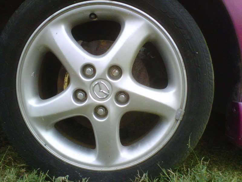

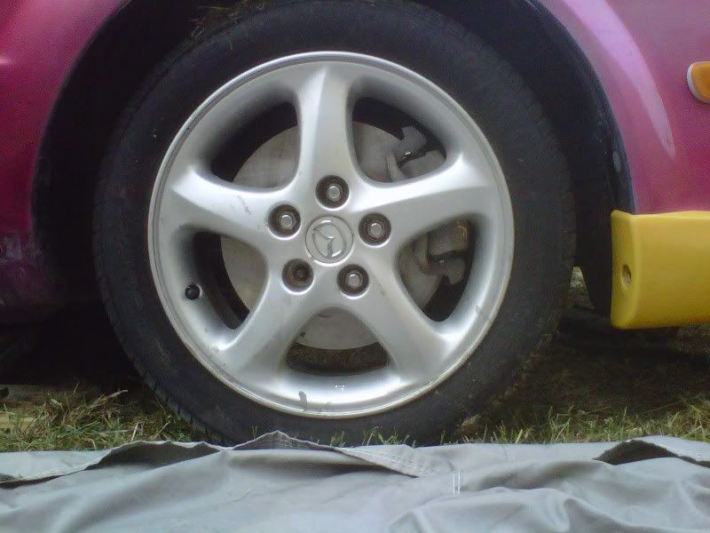

Picture comparison, please excuse the fact there is no caliper in the Before picture, my car didn't come with front calipers :(
Before:
After:
