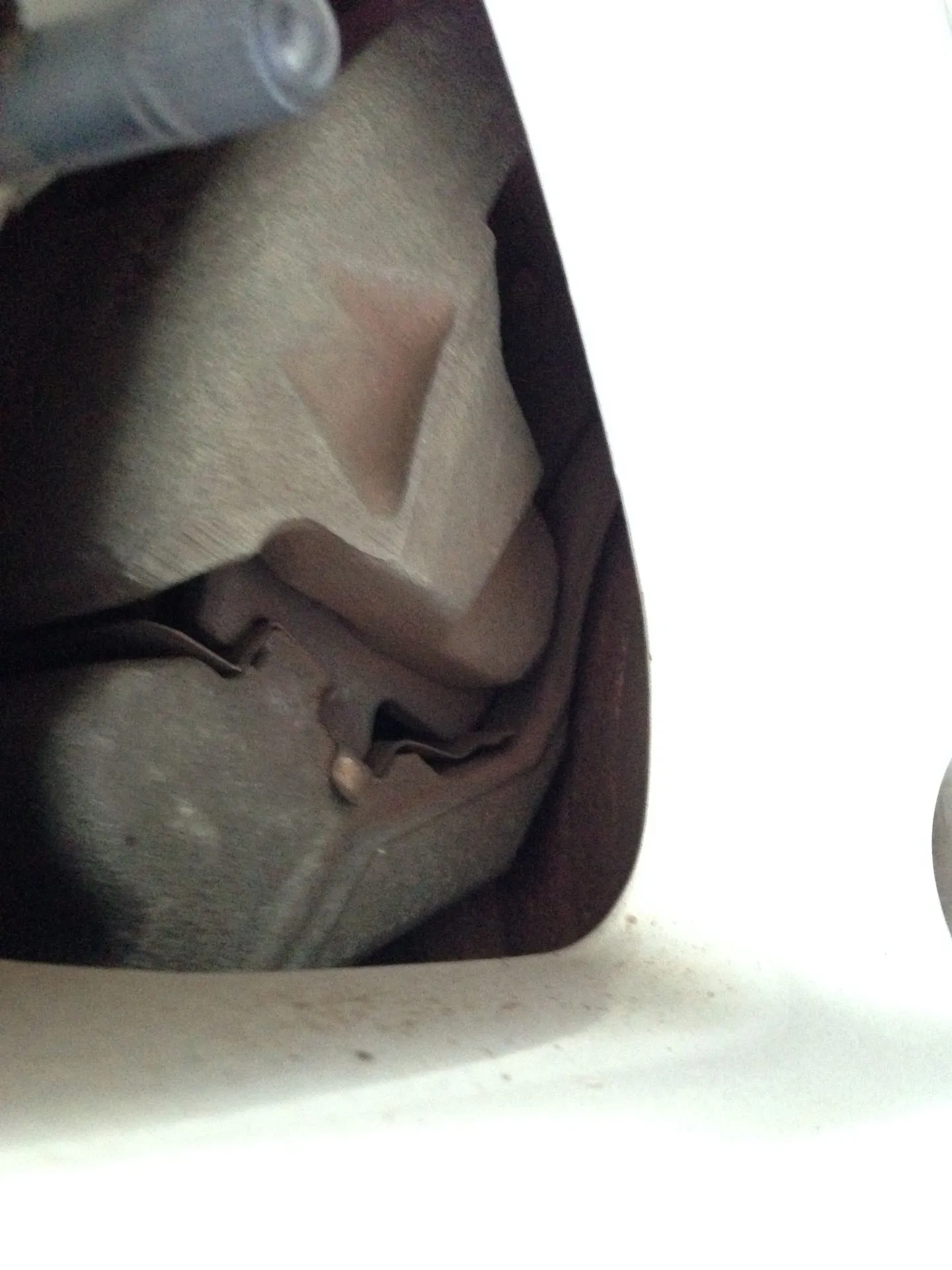

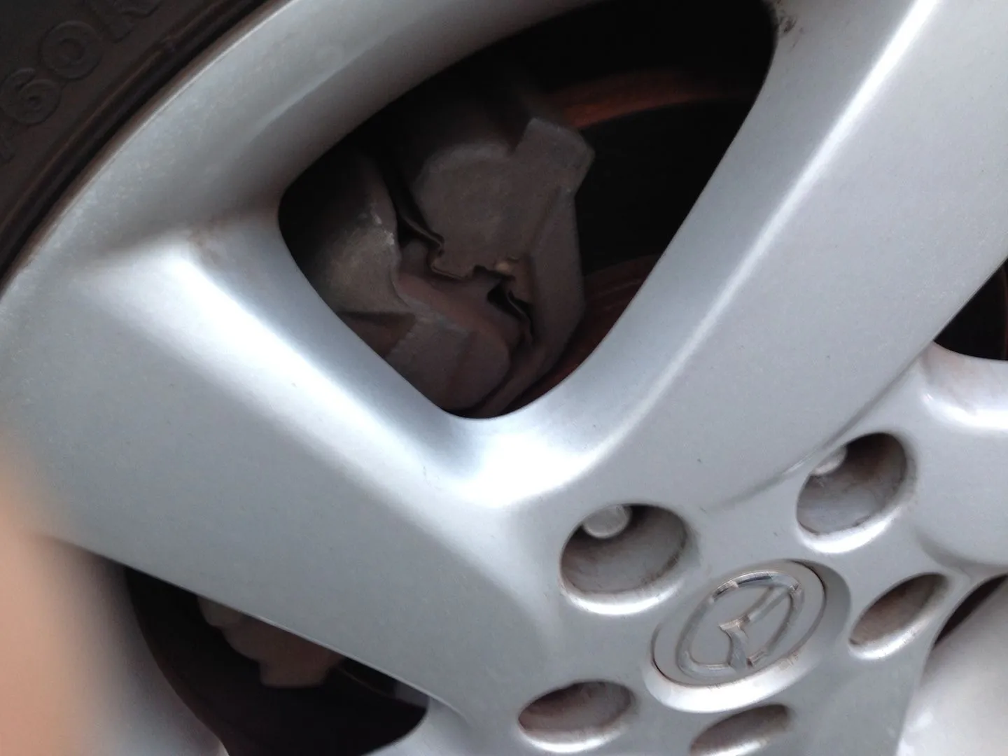

The question came up why don't the calipers cover the entire rotor? Seemed odd to me too.
I have taken some photos from a Mazda 6 but I don't know the year.
As you can see, the Caliper covers the rotor. Does anyone know what year Mazda 6 this is? ____________
For the Rear 2001 626, do we order the V4 or V6 engine config caliper/Brackets? ________________
Once I get all the parts I will post a MOD link for everyone link Circuit did with pics.
Thanks

UPDATE
Pictured is a 03-05 base model. Which would be the smallest of all Mazda6 brakes.
For the rear of the 626's, it would be the V6. As all the 4 cyl 626's had rear drum. ;)
