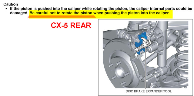

The purpose of the maintenance mode is to back off the EPB motor so you can compress the pistons easily (DO NOT TURN THE PISTON)
I can see how it is tempting for someone who doesn't know about these EPB to use the Lisle 28600 tool to try and turn them back in BUT IT WILL NOT WORK, the motor will not allow it, forcing it with a C-clamp will break the EPB motor. The motor must be backed off first with the procedure below.

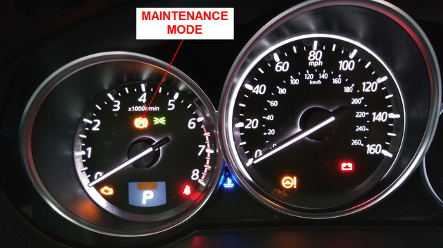

1. Switch the ignition ON (engine off). (you have to press the start button TWICE) pressing once only gives you ACC power, (do not press on brake otherwise engine will start, engine must be off)
2. Release the electric parking brake. (to release the parking brake, you have to have your foot on the brake pedal, then press down on EPB switch to release it, you will hear the motor releasing and the light on the EPB switch light goes off)
• (I'll simplify remaining steps here: after step 2, release foot from brake pedal, and move over and press accelerator pedal down fully and press down on the EPB switch at the same time and hold, then press the start button 3 times quickly, you will hear the motor moving and the yellow parking brake with exclamation point light up) you are now in maintenance mode.
Now go do whatever you need to do on the brakes, for the rear brake pistons DO NOT TURN THE PISTONS, compress them straight back like you would do the fronts. After they are compressed back make sure the grooves are lined up in perfect North South orientation per Mazda instructions use Lisle #28600 for minor adjustments only.
