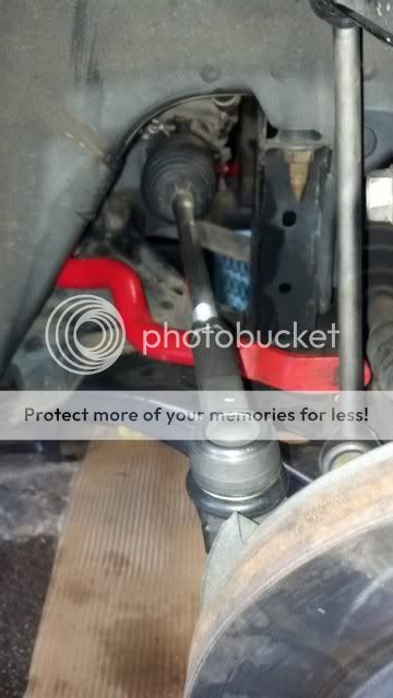

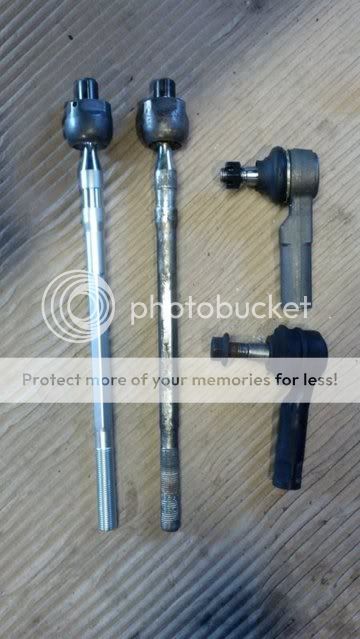

Got the inner and outer tie rods in. Mazda inners and Raybestos outers. Pretty simple job, would have been quicker if I didn't have to drive around looking for an inner tie rod tool.
Old/new. The old ones weren't even bad. I figured with 223k miles on them they would be shot.

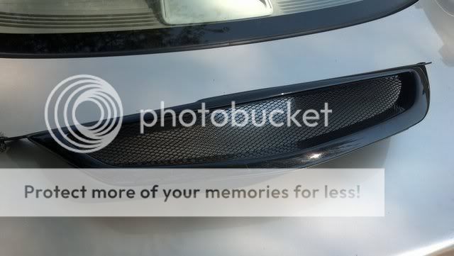

Also removed the Protege5 badge from teh grill and repainted the mesh.

^I really hope both of you bought new lock washers...
And I have to agree that >200K miles is pretty impressive for a set of tie rod ends. When I did mine one of the inners (left iirc) was pretty loose and the boots on the outers were finished.
Nick, were you talking about those locking square clips? What is the purpose of those?
Those locking square clips are supposed to get staked on the collar as a safety measure (just like axle nuts).
I tightened my inners and outers with my impact so they aren't going anywhere.
To quote my late grandfather: "Why are you working like a frenchman?".
There are torque specs for the inner tie rods in the service manual, why didn't you use those? You can easily connect a torque wrench to your fancy inner tie rod tool (that's what I did).
Honestly, sometimes it slips my mind to check torque specs. I'm so used to using my impact wrench on the second setting for suspension bits I just forget. I'll double check the workshop manual tomorrow. But I've got no worries about them.

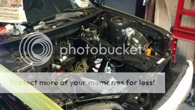

I got some work done on the PS cooler setup today. Didn't get as much as I would've liked to since it was so bloody muggy outside. I think the cooler setup will work well though. And Home Depot Racing had all the fittings I needed so I can mount it all up tomorrow. Then will work on the wiring harnesseseses and paint the bay. Progress is slow, but so is my work habit. heh-heh

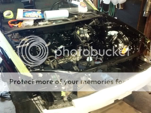

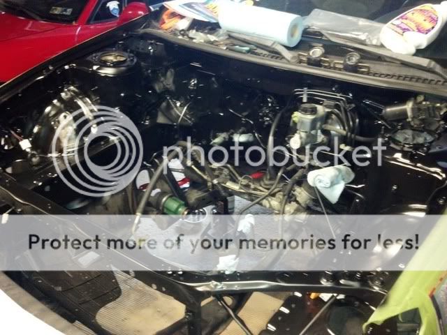

T'was a lazy day today and didn't get much done yesterday either. But le girlfriend and I painted the bay yesterday. 2 coats of semi-gloss black engine enamel.
Before:
After;
Looks good! The thought of a black engine bay still makes me shudder though. Between the old P5 and now the RX-7 I guess I'm too conditioned to look for leaks now.
How does the paint look up close? Maybe it's just because I suck at painting or I mostly use matte/flat colors because everything I paint ends up with a texture. I'm sort of tempted to respray my engine bay now (red or white) because it's gotten so scratched up.
I can try to get some close ups for you, Jon. But all I have is my cell phone so I'm not sure how well it will turn up. There is a little bit off texture, but just a little bit. I use that Rustoleum engine enamel spray paint for everything since it seems to hold up really well and goes on pretty smoothly. I love that stuff.
As far as I know, the paint is still holding up pretty well in my silver P5 when we put the FS back into it and it's now my friends DD. I'll have to ask and see. But this time around it was prepped better and sprayed on better. All I did was scrub the bay with Purple Power, then blast everything with 3 cans of brake cleaner and wipe it down again. I didn't prime or sand anything.
White in your red RX-7 would look awesome, IMHO. Especially with how clean and badass your motor looks. Even if you just paint it red again to cover the scratches and make the paint match in the bay. The paint in my bay was gray in some spots and black in some other and I needed to paint over the rust/Bondo/Por15 spot on my pass side strut tower anyway.
