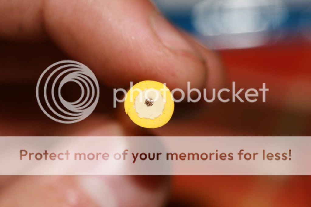

I remember one guy tried it, but got the wrong set of universal wires and there were no metal strands in the core of the wire. It was some weird black synthetic line that didn't look like it could transmit a spark. I was pretty full of wtf at that point.
Not sure about that one. Maybe it was a solid core wire with some kind of sheath around it?

This was the picture from the wires that I was talking about. I don't know what's up with these things, but after he followed my tutorial, his car was not running well, as there was a problem with the spark getting to the plugs. I have no idea how they're even designed to work.
[Quote from thread]
"Core is fiberglass + Kevlar which explains why I can't find wires, they're basically tiny green hairs.
Is Kevlar an electrical conductor? No, it's an insulator.
Is fiberglass an electrical conductor? No, it's an insulator.
"So having a spark plug wire with a fiberglass & Kevlar core does what?!?! Seriously it says it's a fiberglass and kevlar core right on the box. I'm obviously missing something here because it has to hold a spark somehow but from what I've seen of the innards it won't be much.
"On the box the last black plastic coating says "Conductive High Resistance Carbon Graphite Supression Material". OK so is it conductive or supressive... these are spark plug wires I bought right? Oh what a disaster.
"I really love the yellow wires just for the color scheme but starting to get the feeling these wires are absolute s***. I'd be better off using speaker wire."

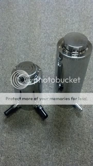

Mishimoto coolant and PS reservoirs are on their way, thank you once again CR3! Then I'll scuff them up and paint them wrinkle black like JT suggested. Looking forward to getting more done this weekend. I love this car.

Got my Mishimoto reservoirs today (Thanks again CR3). I am hesitant to paint them black now the finish is so nice on these. I am always surprised by the amazing quality of Mishimoto parts, especially for the price. Off to Summit Racing tomorrow for a PS cooler and hose.

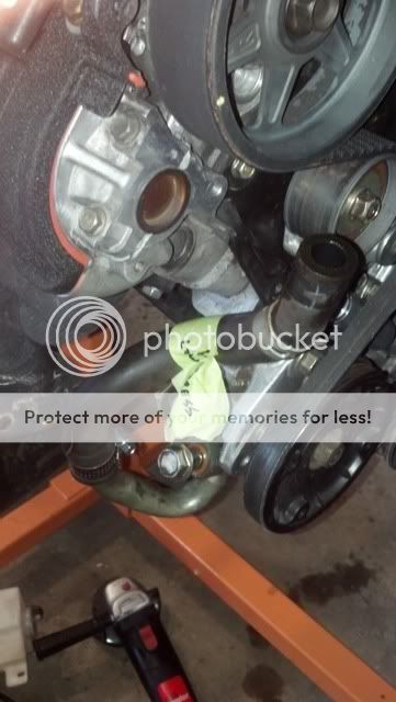

Well, made a nice little discover today. The power steering hose on the bottom of the P5 PS reservoir has a built in hose reducer that pits perfectly on the KL low pressure line on the steering pump. Now the rest of the power steering lines will be the same inside diameter. I just need a male to male coupler (from McMaster-Carr or HD Racing). My last swap didn't have a perfect PS hose adapter and it was slowly leaking I later found out. This should make things much easier. It even bends to match the KL motor.
Off to Summit for a PS cooler. Should fit nicely where the windshield fluid reservoir was.

And the PS cooler I picked up, the barbs are too little. Figures. Haha. I'll take it back tomorrow and try a different one and double check the inlet/outlet with my hose before I leave.
So I picked up a different PS cooler and the inlet/outlets were still too small. Gotta return that one too. Would I be able to just use an oil cooler? I don't see why not...
