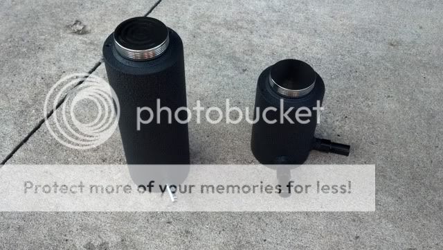

The wrinkle black came out pretty well on the reservoirs. I love that paint. I left the caps chrome to break up the color a bit.

Rico, here's the wrinkle paint I always use. The valve covers on my first KL still look great. You simply apply three thick coats in a cross-hatch pattern with 5 mins between each coat then throw them in the oven at 200degrees for an hour. Open all your windows because it stinks though.

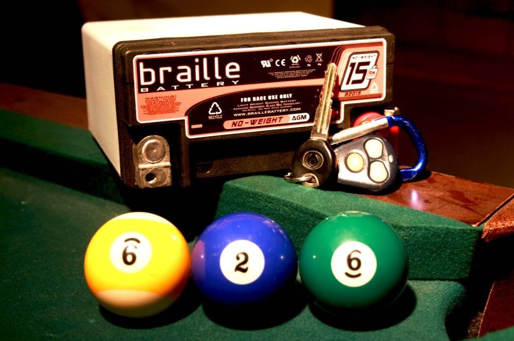

What's the weight/specs on that battery? Looks eerily similar to my no-name ETX18L. I guess if you got it for next to nothing it doesn't matter. Throw that bad boy on a trickle charger right away!
Thanks guys. My only worry is weight. I just removed 30lbs of sound dedening and if I replace it with something just as heavy its kinda pointless hahaha

Jon, Wes bought the battery brand new from Summit and never used it so he's selling it to me for $20 less than brand new, so it's certainly not "next to nothing". I remember you mentioned that site you got your battery from as well.

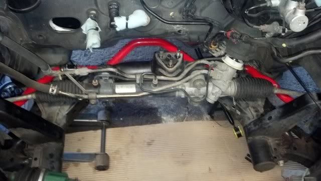

Well my bushings from Mazda came in today and I got the MSP bar all greased up and bolted in. But I can't lift the subframe into place to bolt it back in by myself. Haha. But yay progress! As little as it is, it still feels good to move forward.
