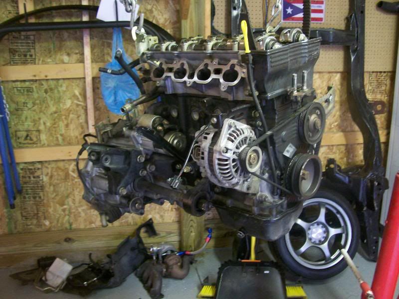

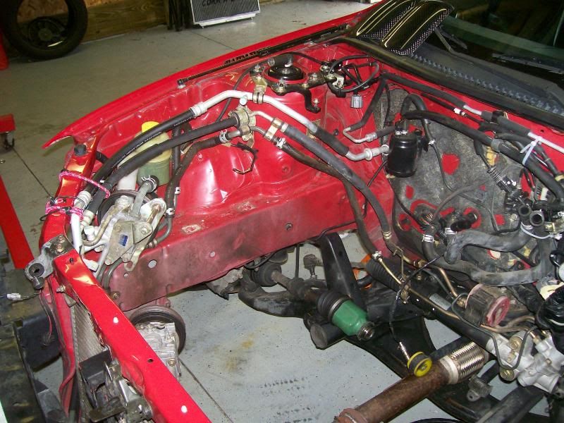

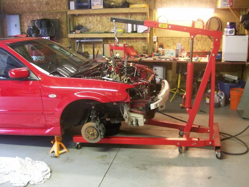

Motor's out! (nana)
I found a bolt out set at Sears that was cheaper than the ones I found online, $20, so that was a relief. Worked like a charm!!! It doesn't have Craftsman's lifetime warranty though, but again, this was probably the only time I'm going to use the set. lol They only had 1 set with the warranty, and it was $50.
Everything else went smooth as well. I only had to bust out my 1/2" impact on 1 motor mount bolt on the passanger side frame rail, everything else came out with my lil 3/8" impact no problem. Shifter linkage came right out, as well as the axles. I took the lower control arms loose to slide the knuckle out enough to get the axles free.

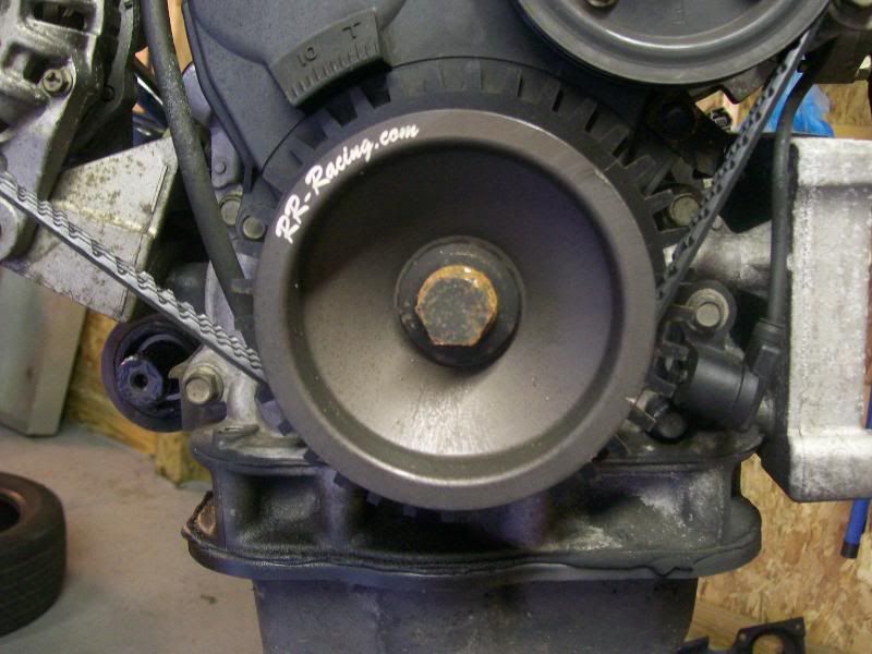

And lastly, what's the deal-e-o with this crank pulley? Looks aftermarket...
Nice work today, brotha! It's like we're in a race. haha
And yet another good snag on the crank pulley. Mo money, yO!
