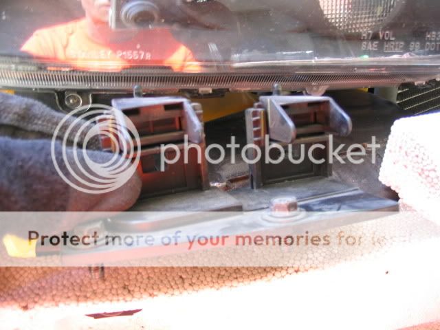

Borrowed a buddy's shop/lift Saturday. Added my front bumper foam, added the plastic bumper clips that install in front of the headlights. Readjusted my aac brackets and fixed my bumper sag! Then I popped off my rear wheels and added camber bolts. I maxed these bolts out (which isn't much) and might be running around -1* on the rear now. My wife snapped a pic of me in the process

are those the aac brackets? and where did you get those cuz mine are broken off. and did it close the gap at the headlights? maybe post some pics of the bumper and the headlights :D
yeah mine are gone too lol
IIRC, they don't touch the headlight housing. It's more for the bumper. But when I did the swap in the silver P5 I removed them to paint the bay and forgot to re-install them and my bumper still looked fine.
These are not the AAC brackets. the AAC brackets are metal and install on the sides of the bumper where it meets the fender. They are metal braces that support between the two bolts and align everything with properly placed threads.
AAC BRACKETS
The brackets I showed above are part 16 (Spacer, Bumper stay)
item number: R BN5V-50-CS1A
L BN5V-50-CS0A
I had to buy both the right and the left since I had neither. I got them from a local friend who sources dealer parts. I paid about $21 for each one.
Each piece is a flat plastic mount that mounts to the crash bar using two bolts. There are dimples on the bottom that fit in holes in the crash bar so you know where they mount. The bolt holes in the crash bar are threaded for mounting. The tabs them self are adjustable in height and have elongated nipples on the back. Raise the support up a few clicks until the nipple touches the underside of the headlight.
