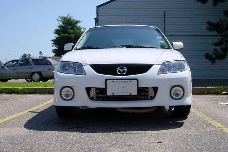

I got myself one of these...Overall dimensions 33"x5.8"x3" Hope it's good enough. Should fill the front cut out nicely. Thanks Andy
you 03.5 guys dont have to worry about fogs, so you can get away with a bigger IC.
actually 3.5's have to worry about the plastic that houses the fogs.that intercooler will be close. my core size is 25x6x3 but my endtanks are bigger.i think my overall is around 30ish.and my 90 degree elbows just hit the fog cups.

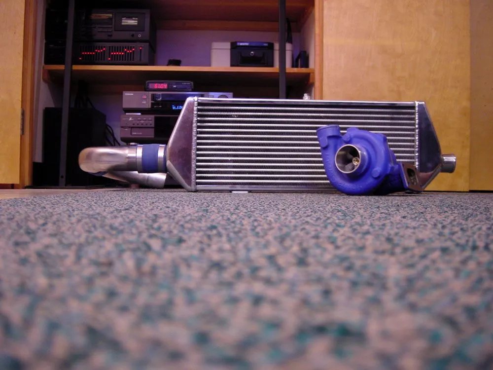

Let me get you a pic. One moment...
Reply...
Have a look at this...
Reply...

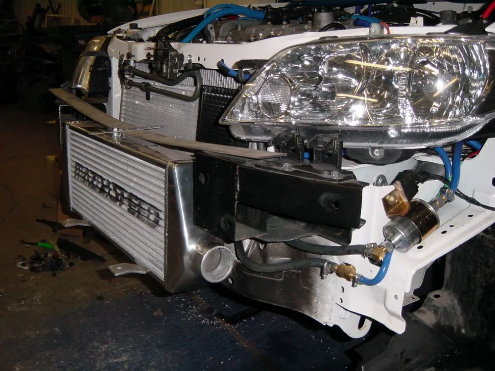

Here is an early picture. It will give you an idea on the thickness.
The Blue lines and metal can thing in the left fender are part of the electric cooling system for the T-25. It has a seperate cooling system from the engine.:cool:

Damn, you really cut that bumper out huh? How tall is that intercooler? Are you having any problems with cooling and a/c charging in the summer? Looks nice though. What did you use to write Mazdaspeed on it?

Over 14" in height. No problem with heat. The lettering was printed on thick paper. Then I cut it out with an exacto and spray painted it on like a stencil with hight temp flat balck.
I installed the IC with one and a half inches of clearance from the A/C condenser. The temp does not go above what it did before and the A/C still cools like crazy. ( I Love My P5 )
