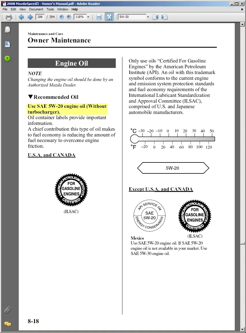

Screenshots of the 2008 User's Manual from the Mazda USA website... FTW. My printed manual in the car shows the same.
Without Turbocharger: 5W-20
With Turbocharger: 5W-30
