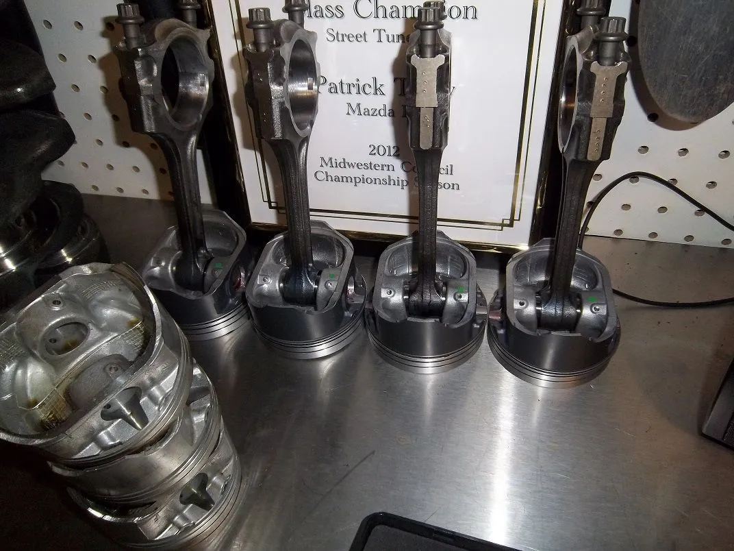

ok here are mine.
pressed in old pins (the ones mazda sent with the new HC OS pistons where too short) with the old rods. Then main ends blueprinted. crankshaft was mildly polished, and entire rotating assembly balanced after powder-coating.

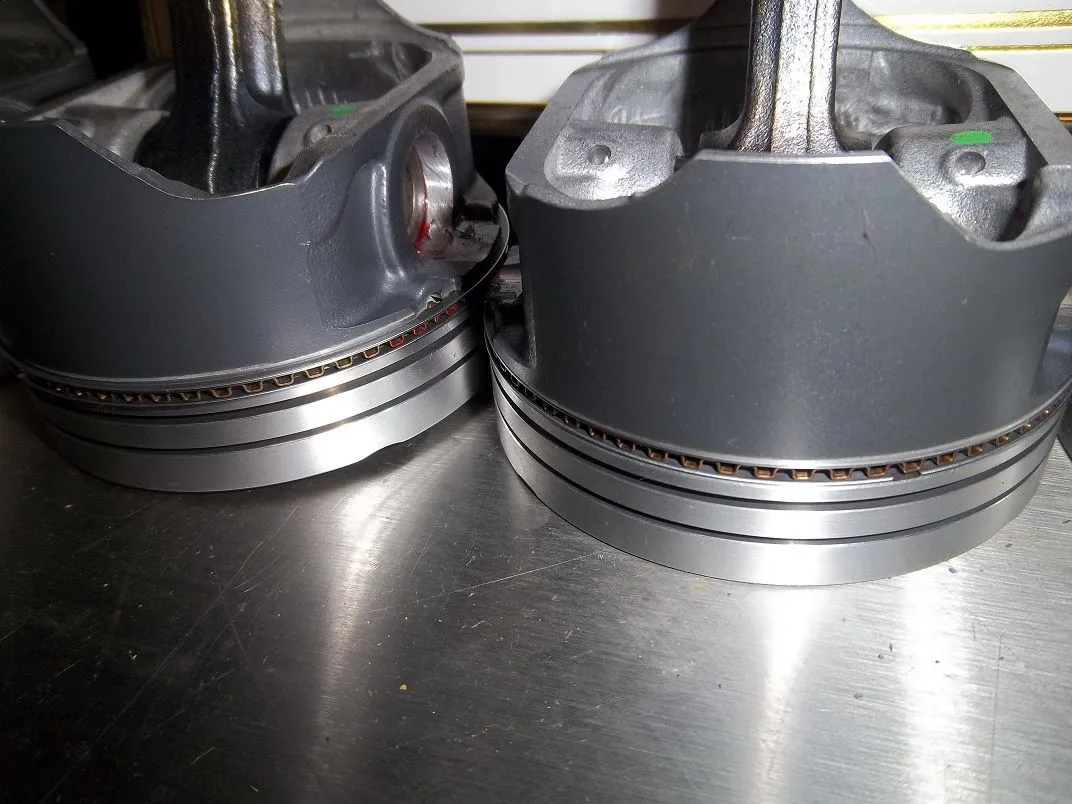

powder coated the skirts to free up some horses (again found that the engines bad design was slamming them up against the cylinder wall).
attachment.php

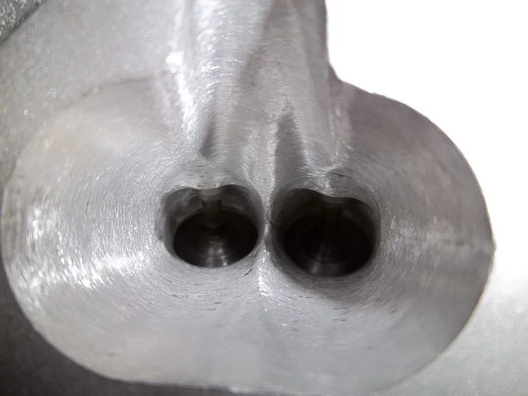

exhaust porting
attachment.php

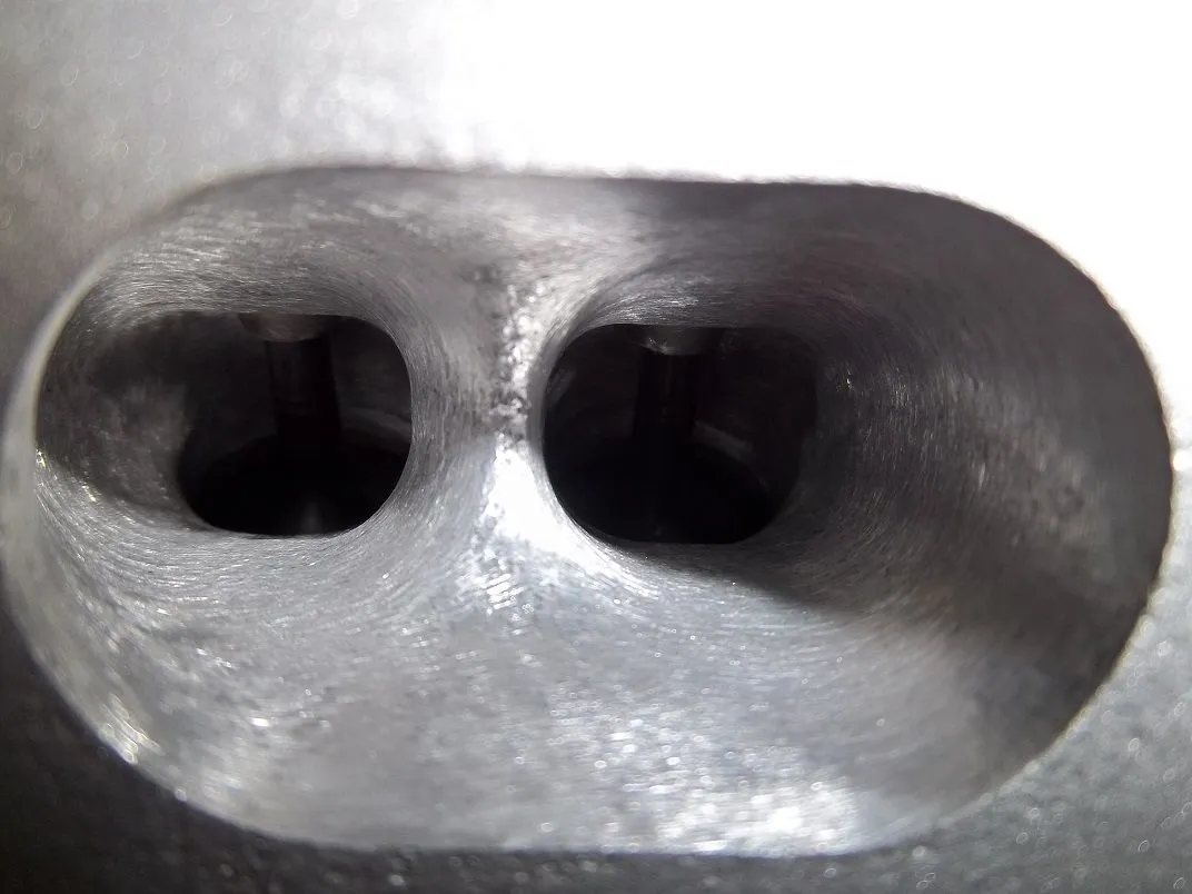

intake porting
attachment.php

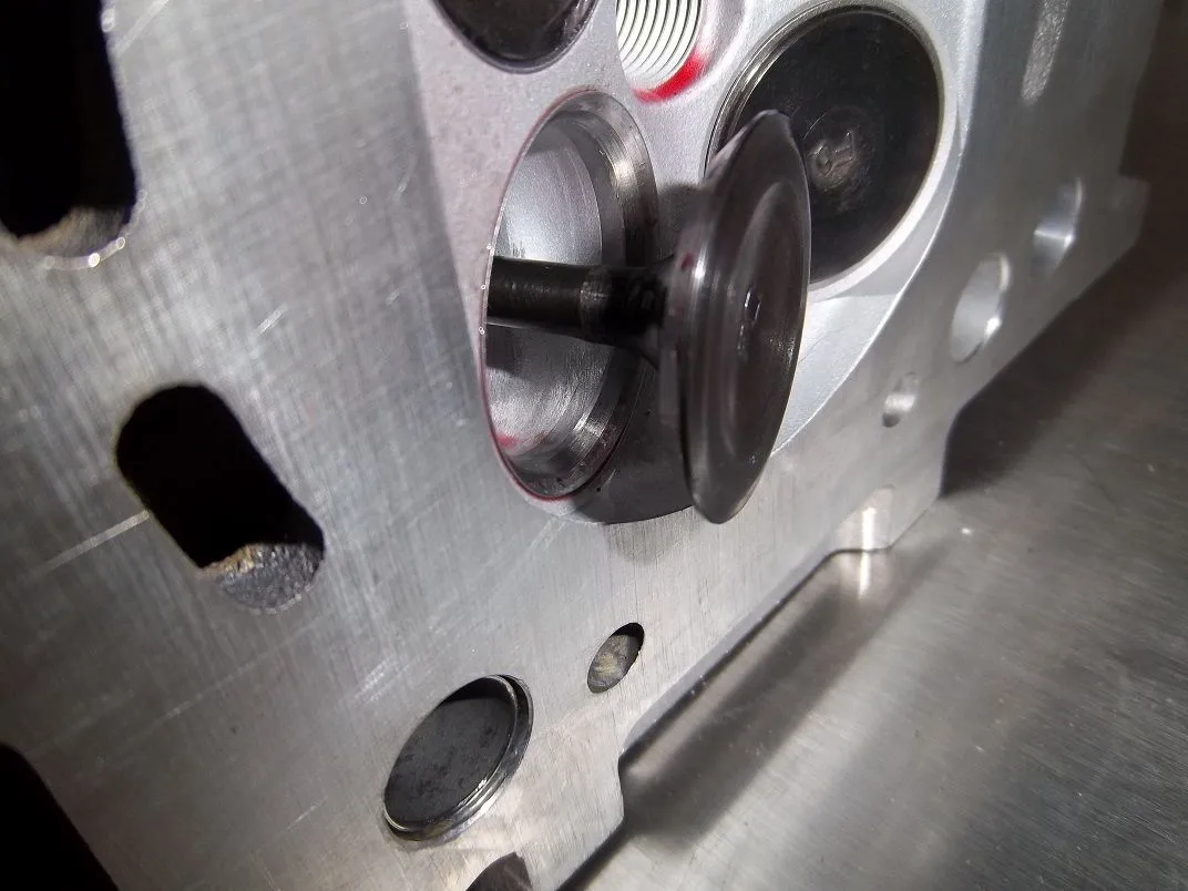

Three angle valve job
attachment.php

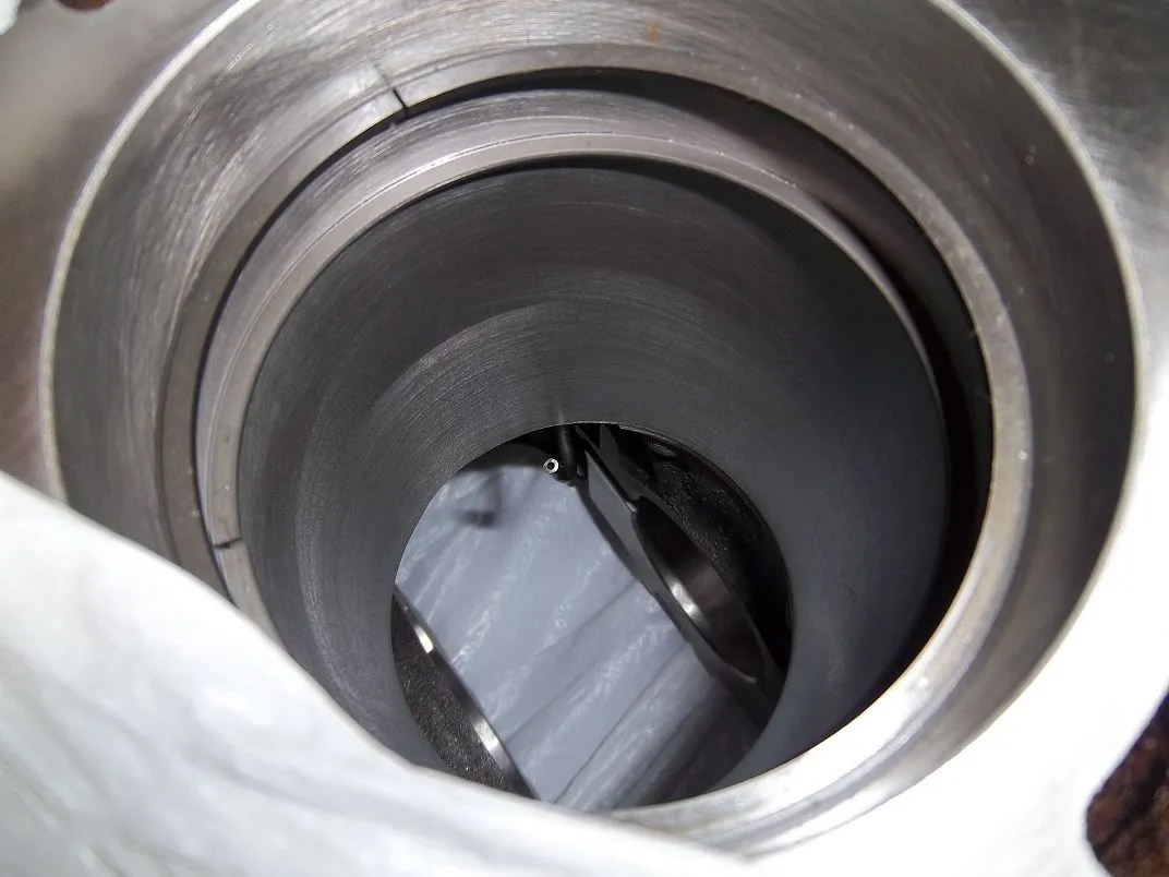

blueprinting (seen below) with stress plate, boaring with stress plate, honeing upper cylinder with stress plate, and ring fitting with stress plate, decked, and new squirters.
attachment.php

Oh god, these idiots gaped the rings up side down causing ring flutter. Should I gap the lowers even more to prevent that and have blow by or should I just keep it and pray for the best?
unfortunately they cannot fix them. They have already taken off too much material. If I where to run them (after I/they fixed the rings) they would be something like .021 top and .023 second. That might be fine if I was running boost or NO2. But again they had them right (a bit on the high side, but ok) just upside down. I mean our second ring is a napier style ring! They are supposedly super well know. If you are such a great engine shop how the hell do you put on a napier ring upside down on the top? s*** it does not even fit in the top groove of the piston. I hate when other people work on anything of mine.
SOOoooo I am thinking I will be making mild horsepower of 150whp and will be running n/a. I am thinking of .018 top and .020 second ring should be plenty for expansion. Especially when stock oem is .009 top and .011 second. And I have been running on that with no problems. Yes at lower horsepower but not much less.
