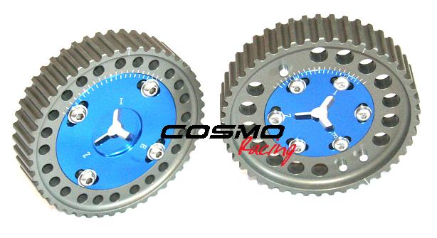

i'm not sure what cams you currently have...you could definitely look into some adjustable cam gears, and move your power band a little...which would give you a better idea of how aggressive you want to go with cam specs...but even proper cam gears will be hard to source, as to my knowledge only FocusMSP adjustable gears will work with stock triggering...you only need one for the exhaust cam, you can run any adjustable gear on the intake as there is no sensor...
look up Big Lou...I almost bought a gear from him, but then found my twiggys and the seller was including two new focusmsp gears with it...so i went that route...he may still be looking to sell it though, not sure...
OK getting much closer to being finished. Did pay for the focusmsp cam from Big Lou. Hope he can get that out soon. I will also call up SR to see if they will part out one adjustable exhaust gear.

cams have been sent out. And SR will not sell just the one cam gear. So I will see if I can't find anyone on here with just one or at least selling them cheap.

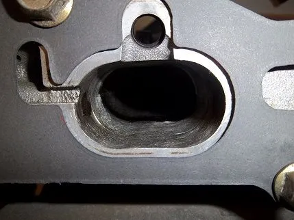

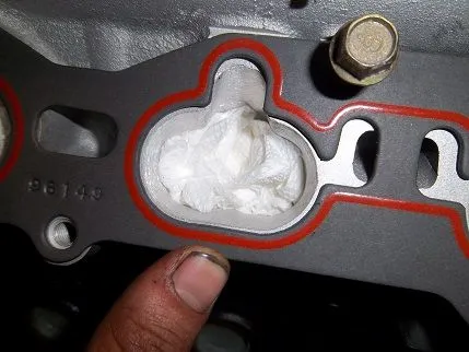

OK so anyone else think this is a problem????

OK paid for the microtech, and recived the focus gear from Big Lou. Thanks!
Now just the other cam gear and the waiting for the ECU and Cams..........

OK second cam gear coming from Australia. Microtech already here. I am looking into the install while I wait for my cams to get made, and I noticed that there is a spot to be wired into the stock O2 sensor. Will I still need a wideband?
