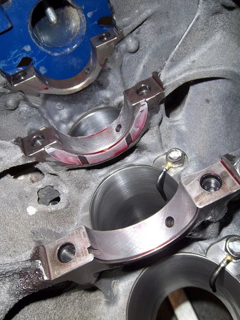

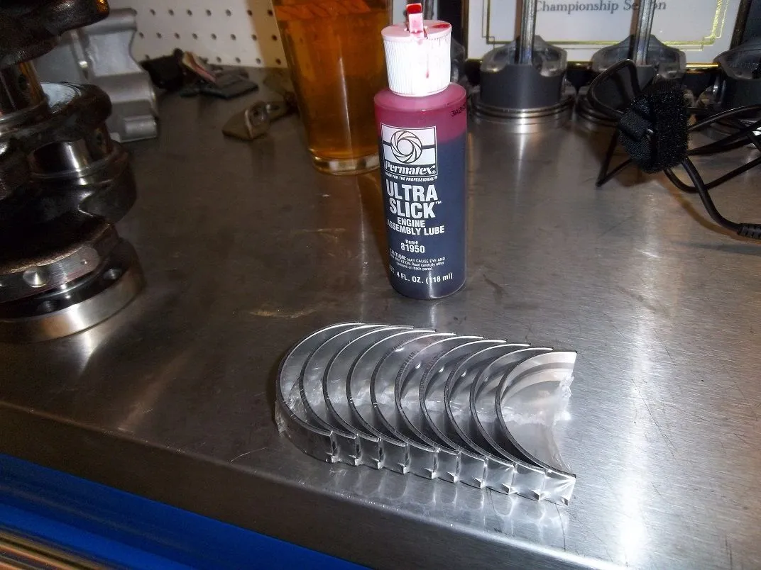

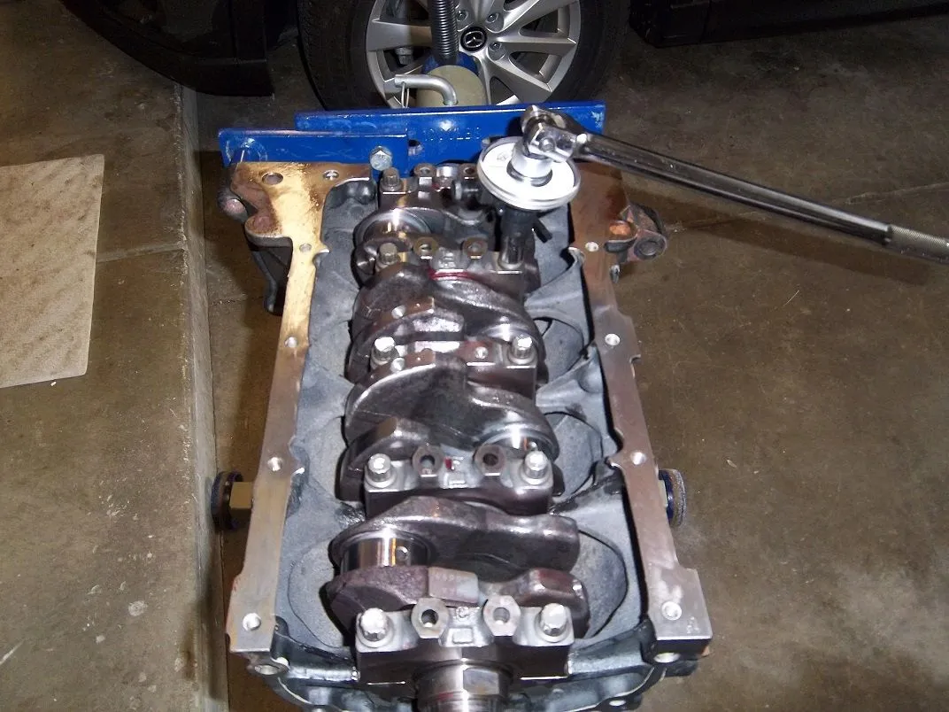

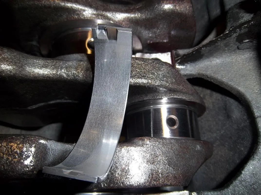

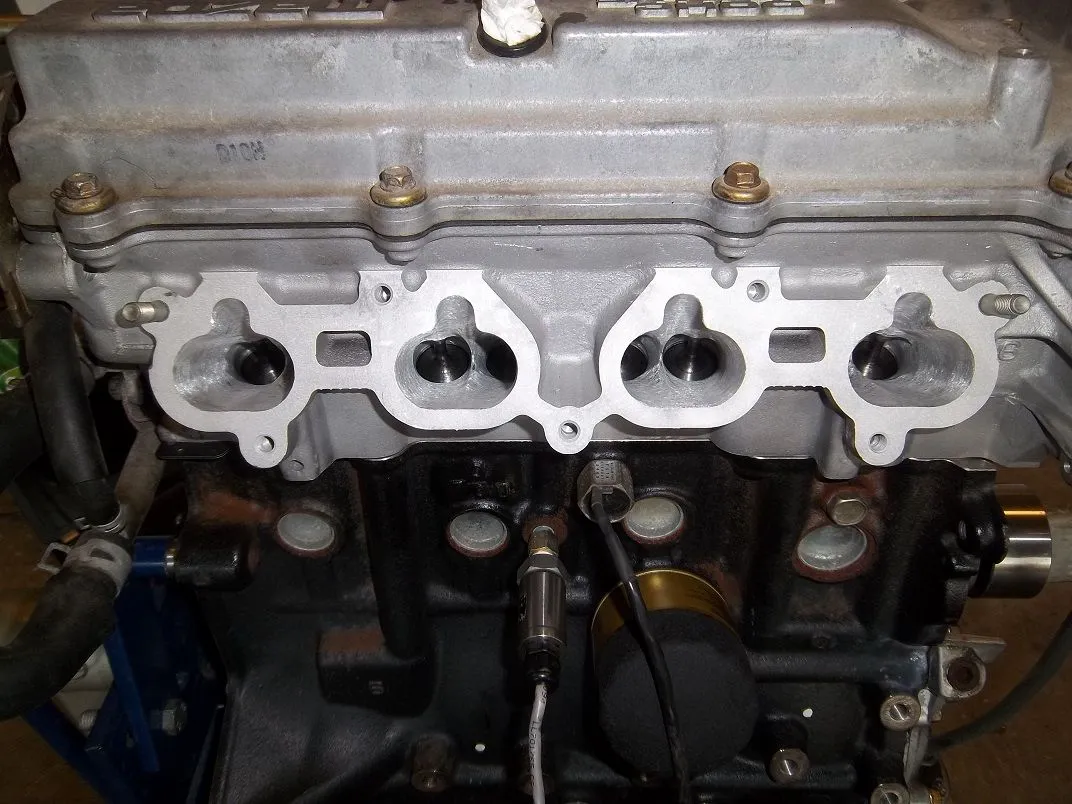

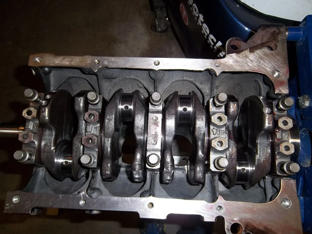

Finally the diss and assembly of the fsde. http://mazda626.net/topic/39391-fs-de-torque-specs/ post #5. Down load it up quick!
attachment.php
attachment.php
attachment.php
attachment.php
attachment.php
attachment.php
attachment.php
attachment.php

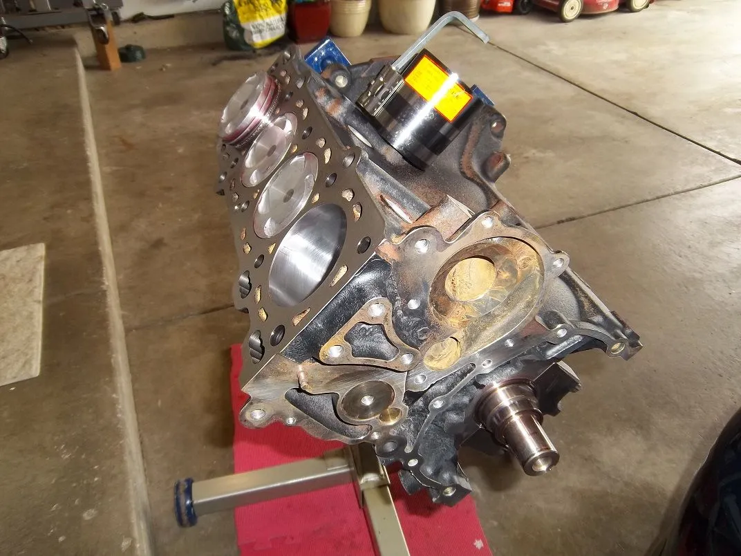

thats it till I get the head finished.

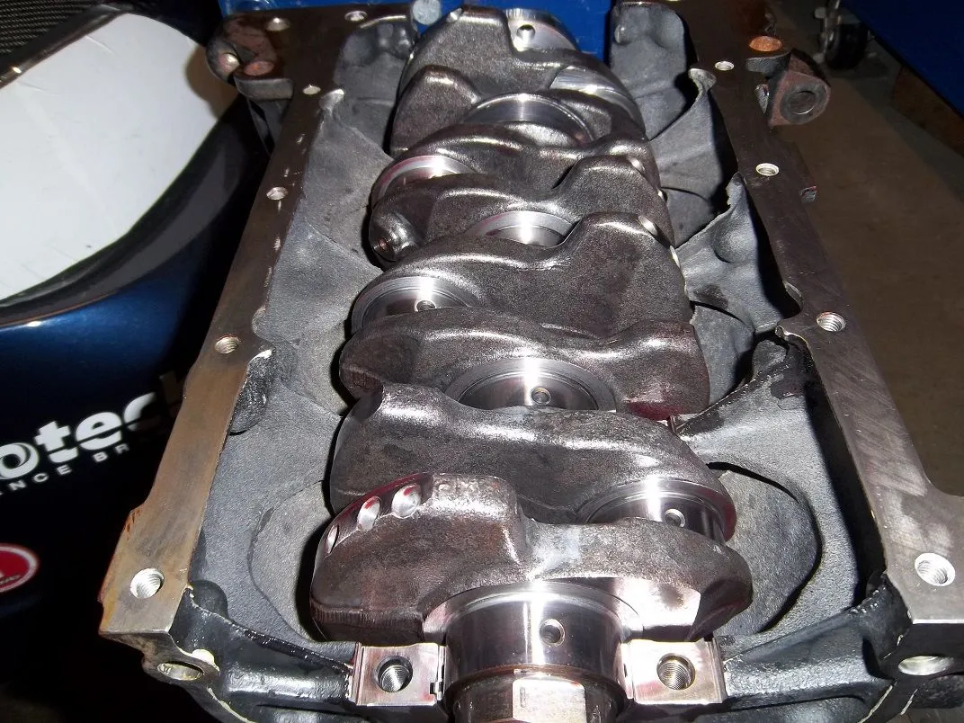

So it looks like integral is out of biss too. I will have to call up Mega Cycle Cams and see whats up. Looking to do the stage 3 which is like the twiggys.

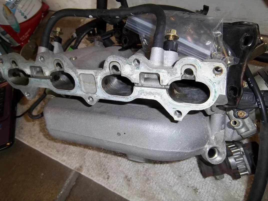

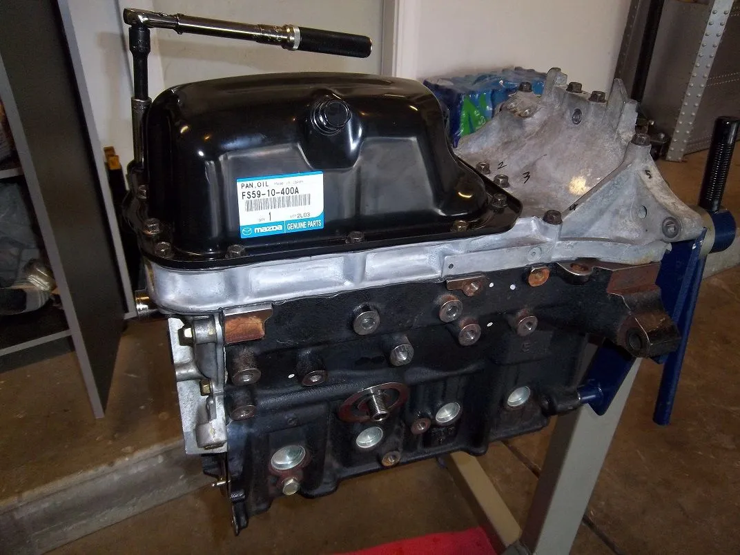

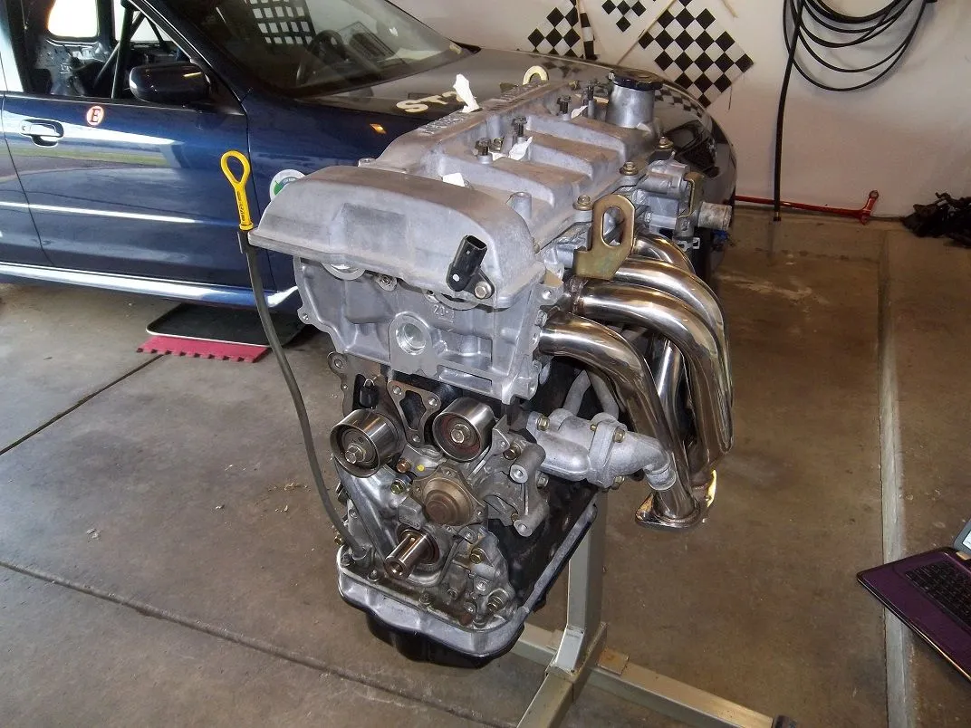

Now I am stuck at getting the cams. NEEDS CAMS NOW!!!
attachment.php
attachment.php
attachment.php
Stock or you can use the X4 box with bosch coils. The Bosch coils are a bit over kill. (Should note that this is IMO)
