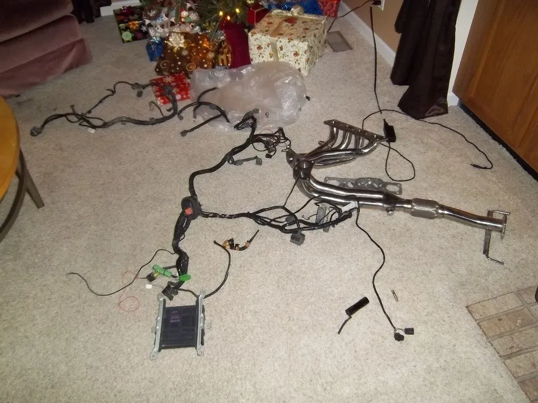

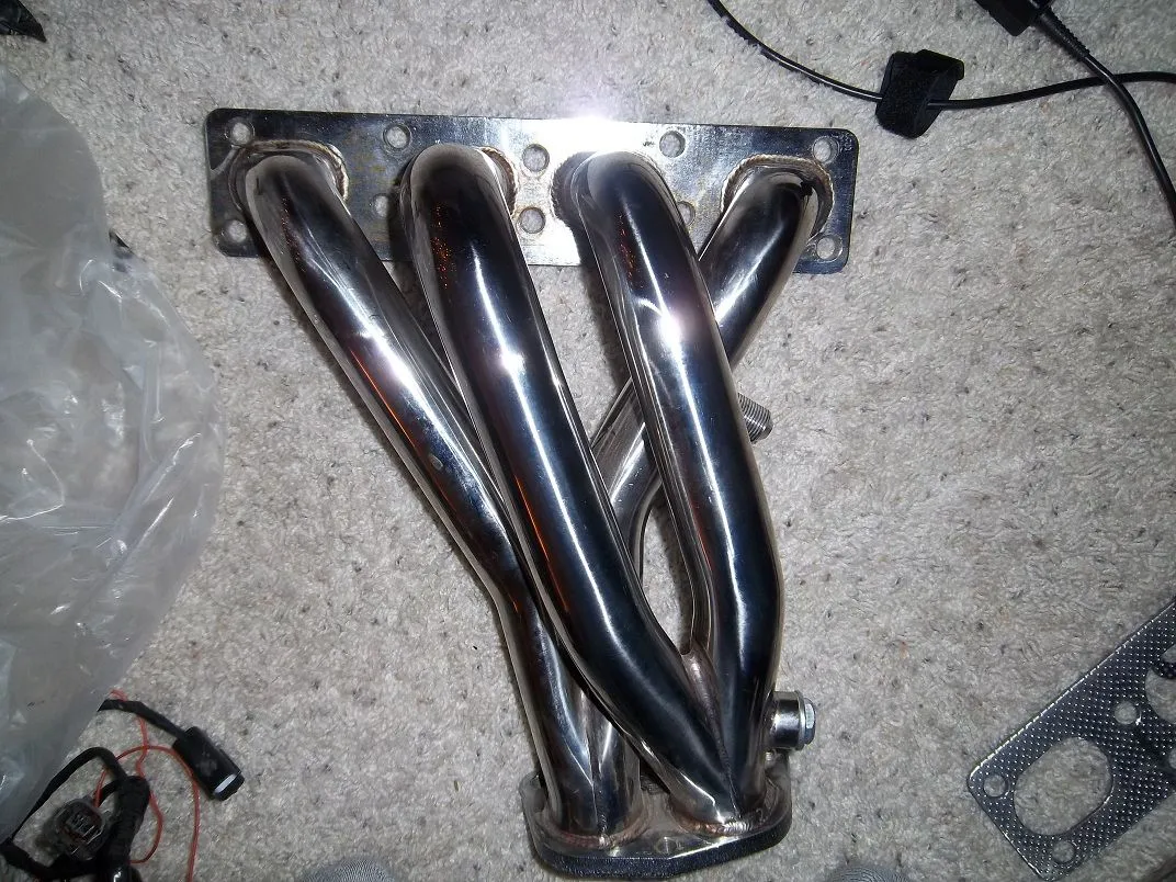

Got the ecu, harness, and header from repthemazdas today! (super fast shipping and killer price!!!!!) Gave myself a nice new present. (hehe) Here is a couple of pics of the stuff. The header is still new, and the welds are amazing!!

Now I need a trigger, egr tube, and a wiring diagram to help me get this thing in. Was thinking of ditching the dashboard and running just spa gauges. But still would want to know when a cel comes on. (how the hell do I do that?) Well I guess I got something to do while I wait for the motor to get finished.
