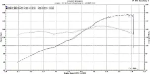

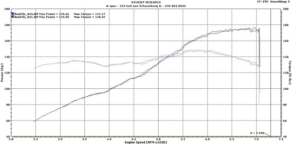

wow about a 30whp increase. looks good in there too. can't wait to see race footage.

not quite 179.
attachment.php
the run from the 626 mani was too old and deleted. But still as of yet the highest usable PROVEN fsde to date?

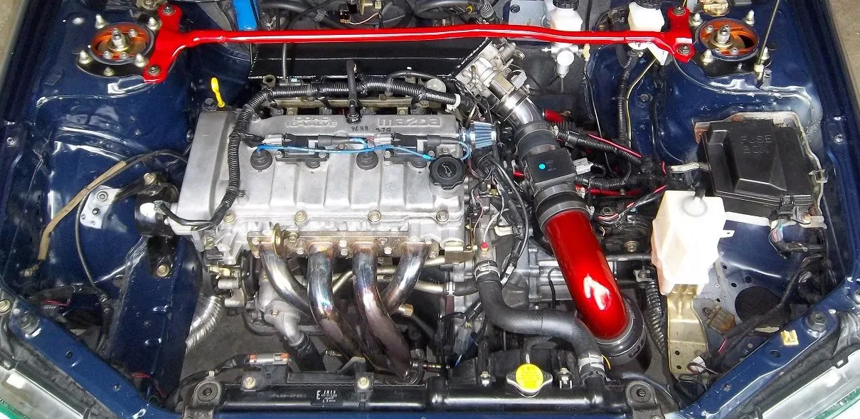

OK on with the facts.
Exterior:
Fiber images C/F hood
wrong color blue rear hatch
rear lower bumper cut out
msp front bumper w/ grill support cut and smoothed out
fender turn signal delete
covered head lights per competition rules
1/4th protege dx unibody (front drivers side)
front and rear wiper delete
flying logo mod
strap style front tow ring
black sun block vinyl on windshield
Jump battery quick connect
Interior:
all but top part of dash interior delete
dom fully tigged in custom 4-point roll bar with two sided tiged in bases per SCCA rules
All random brackets removed
all but driver doors gutted including crash bars, window motors, and locks
rear wiper motor delete
front pass and drivers window delete
front wiper motor and assembly delete
spa oil pressure and water temp split gauge with recall, warning light and remote output for larger warning lights
Wideband by innovative gauge
J&S knock gauge
Ultra Shield Circle Track vs Halo aluminum Powder coated black seat
Ultra Shield Platinum colored cam lock 6 point harness
heater core removal per competition rules
steering lock removal per competition rules
window net per competition rules
gopro hero3
Engine:
Full a/c removal
power steering rack removal and manual rack installed
power steering system delete
4-2-1 header a 2 piece no name brand (needed slight work to make fit)
Megacycle stage 3 cams
505zoom turbo intake manifold V2
battery relocation to old evap location
oddesy pc680 battery
cruse delete
sri
fidenza flywheel
quaife
b&m shifter
mp3 ecu (flashed) used for the IAC and other house keeping dutys
Immediate exhaust dump with the rest removed
pass and driver mount epoxy filled, front and rear awr mounts
weisco 11.1 forged full float pistons
Stock rods modded to take floater wrists
Full rotating assembly balanced twice
.020" over bore
Head ported and polished
block blueprinted
crank micro polished
Microtech LT-10
EGR delete
Adjustable K gear on intake side
Adjustable Focus gear on exhaust side
Suspension:
K-sport pro coilovers with 800 front springs, 600 rear and custom welded rear sway bar mounts.
msp front sway bar
awr rear 21mm sway bar
k-sport rear adjsutable end links
brembo front plain rotors
stock rear brakes w/autozone pads
Stock front brakes w/front pads differ depending on the track
rota slipstreams 15X7
bfgoodrich g-force r compound 225's
fog light holes turned into brake cooling inlets
corvette wheel studs in the front
Power Master Cylinder and stock proportional valve removed
1" mechanical Wilwoood tandem reservoir with only 2 outlets Master Cylinder installed
Wilwood 7.1 ratio single brake pedal installed
remote clutch reservoir installed
Wilwood adjustable proportional valve installed in cockpit
SS brake lines in all 4 corners
179whp/146wtrq
Full MC log book
16K odo
2170lbs empty and getting lower every mod I make. (not including driver, Im getter heaver every year past 30)
always for sale! Please make a offer.
nice list really though my motors pretty much the same maybe a little bit lower compression but I have a bored out throttle body you have stage 3 integrals I have stage two and a halfand you have a higher flow intake manifold and you're pulling 25 horsepower more than mevery interesting!
looks like that 626 protege garage manifold on running is one hell of a choker.but I'll be taking care of that soon enough have you thought about running a bigger throttle body
