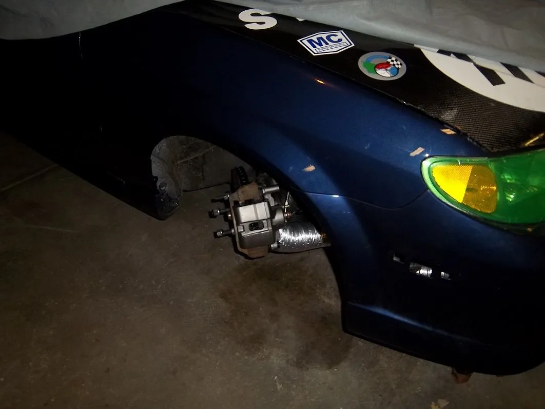

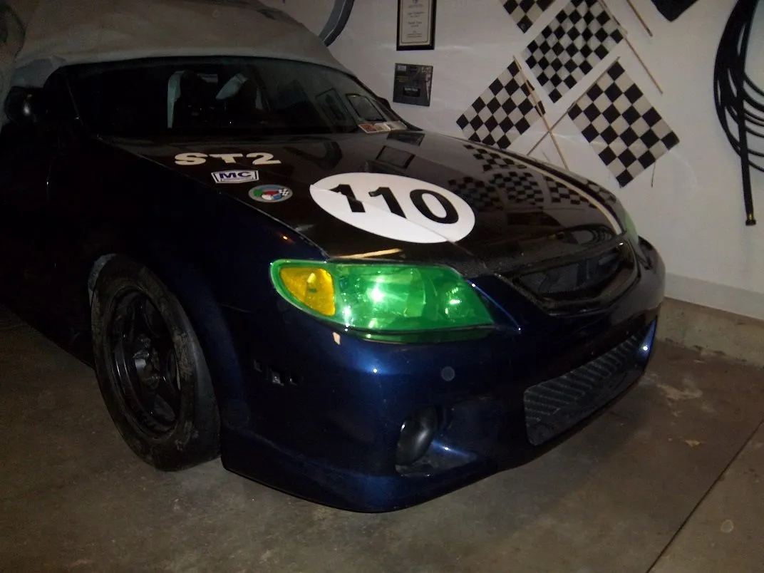

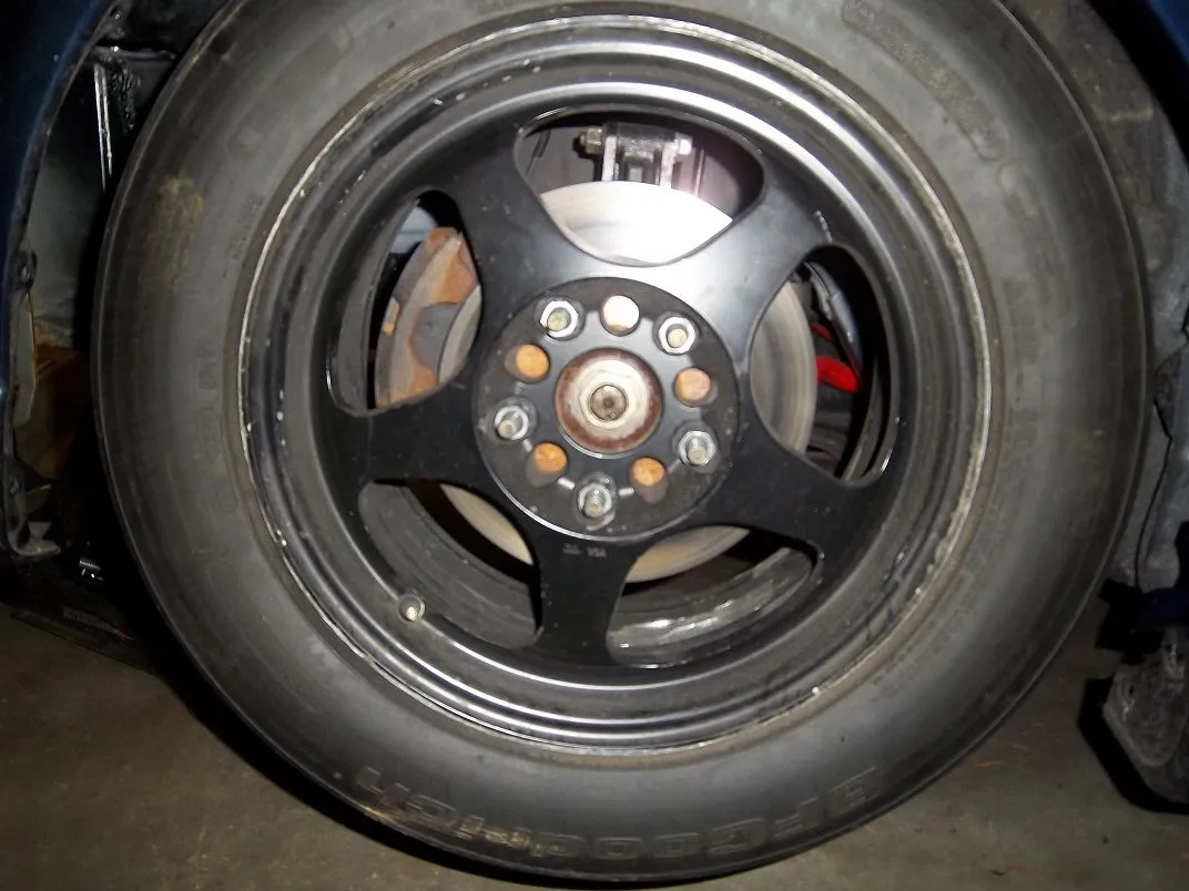

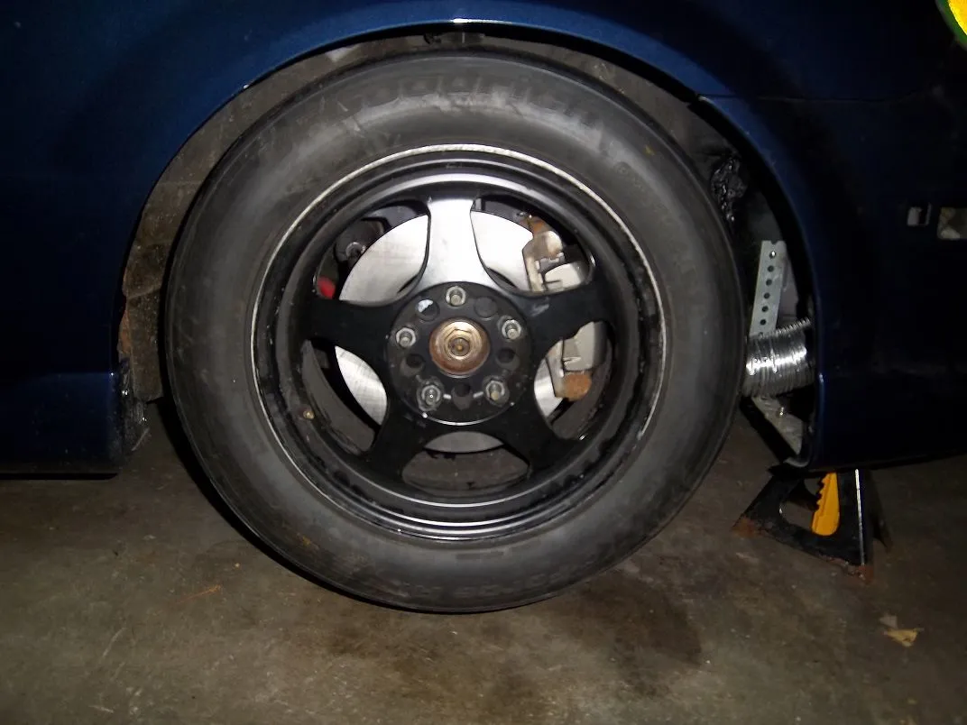

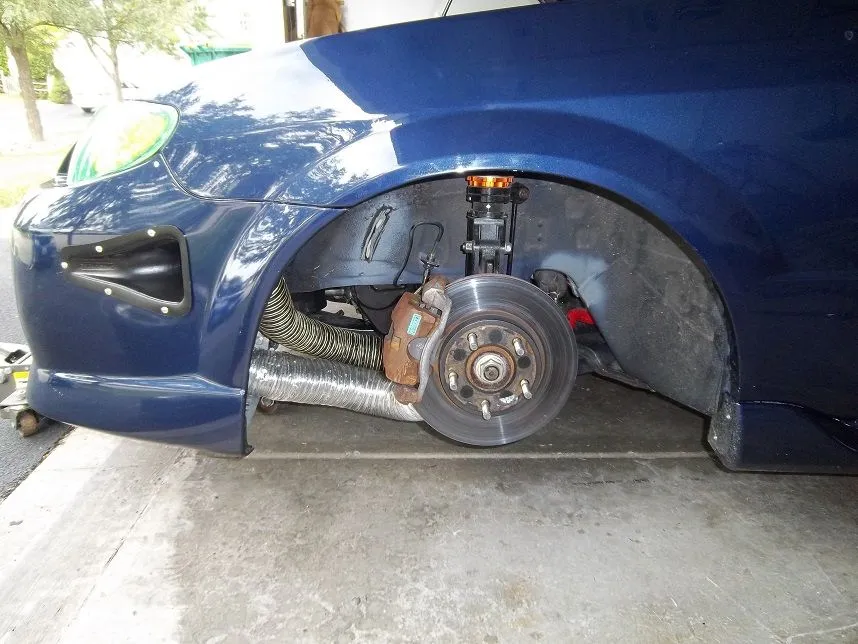

Almost completely done. All that is left with the body work is a couple of stickers to cover the turn signal holes, and to wet/color sand the fenders (when it gets warmer outside). And with the mechanics all that is left is to mount new tires (again when its warmer outside), and bleed the brakes with new fluid closer to my first race.
Used new MazdaSpeed brake calipers and their 11" rotors (plain centric cyro treated) to help my brake fade problems. Dabbed some clear on the cracks on the hood to tone down the fryad carbon and placed a new number sticker over the big crack and that is as much as I care too do. Also The hood closed a but too tight on the stock grill I nabbed from the junk yard so I switch it out with the crappy carbon one I had on my daily P5 and it worked. A couple coats of clear and wala.
New Brakes
attachment.php
New rotor fitting in the 15" Slipstreams
attachment.php
Old rotor (just cant keep up with the increased speeds from the new power)
attachment.php
And a quick pic of the new front end
attachment.php

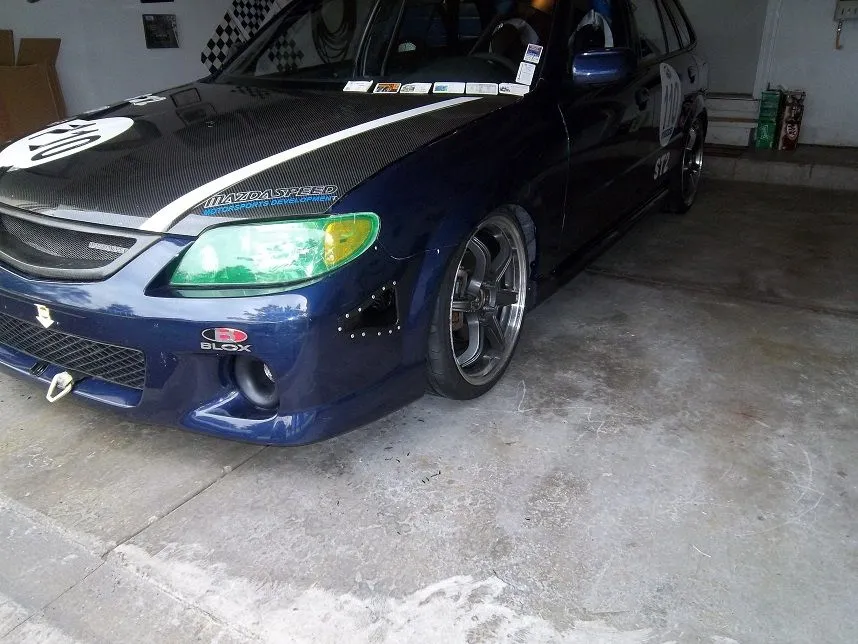

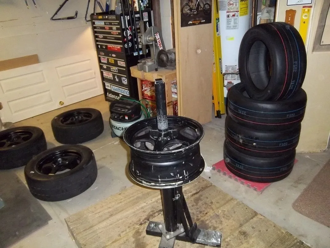

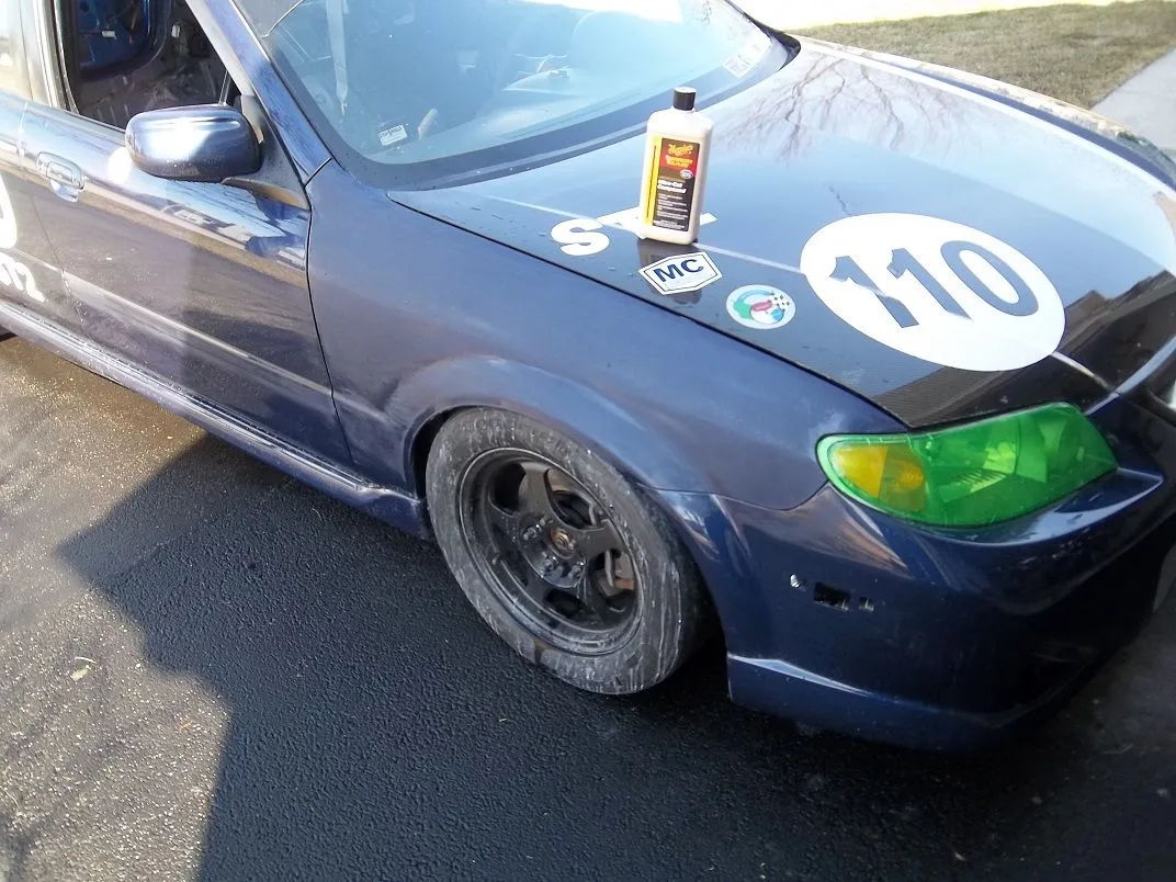

Now that is not frigid outside I was able to color sand the fenders. And also mounted on the new rubber from toyo. Even though there was a ton of rubber left on the bfg's I think they where just a bit to hard. Maybe I will save them for a hot race day and see if they are any good.
First race of the year is in two weeks. I will hope to have a new video of the 505 in action and also the MSP brakes working or not. I really hope so....
attachment.php
attachment.php

I hope it does not rain this weekend. Its race #3 for my club and I need to step up and get going even in the rain. Now that I know I can stop my car with the Mazdaspeed rotors and calipers I can and did order the Correct Mazdaspeed pads (a bit larger than the P5's). This set up fits inside the/my 15" Slipstreem Rota wheels. So I need to buy a set of Hooshier rain tires and scrape that sand out my crotch.

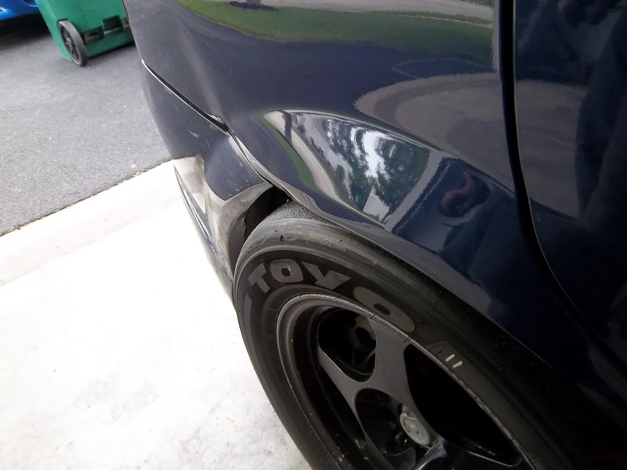

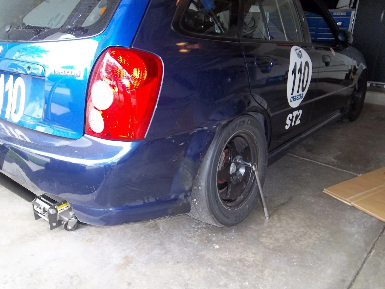

Got hit for the first time.
attachment.php
attachment.php
super unnecessary. Pinata mentality. No respect for cars, just about being first. I think/hope they are trying to get their own group so they can just bounce of each other and not other cars that are not even in their class.
If you go to the end I slowed the vid down to see me getting hit and reacting to keep the car on the track. I was trying to get around the RX7 on the outside (so yes going a bit slower (controlled)) and I guess that does not favor lesser hp miatas so the better thing to do is to hit the other slower cars...

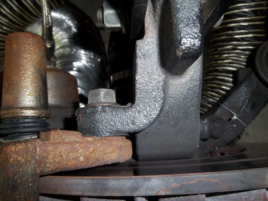

I will be posting up some pics from the brake stuff here in a few days. I have been upgrading my race trailer quite a bit, but I do not think any Mazda guys would care about that.

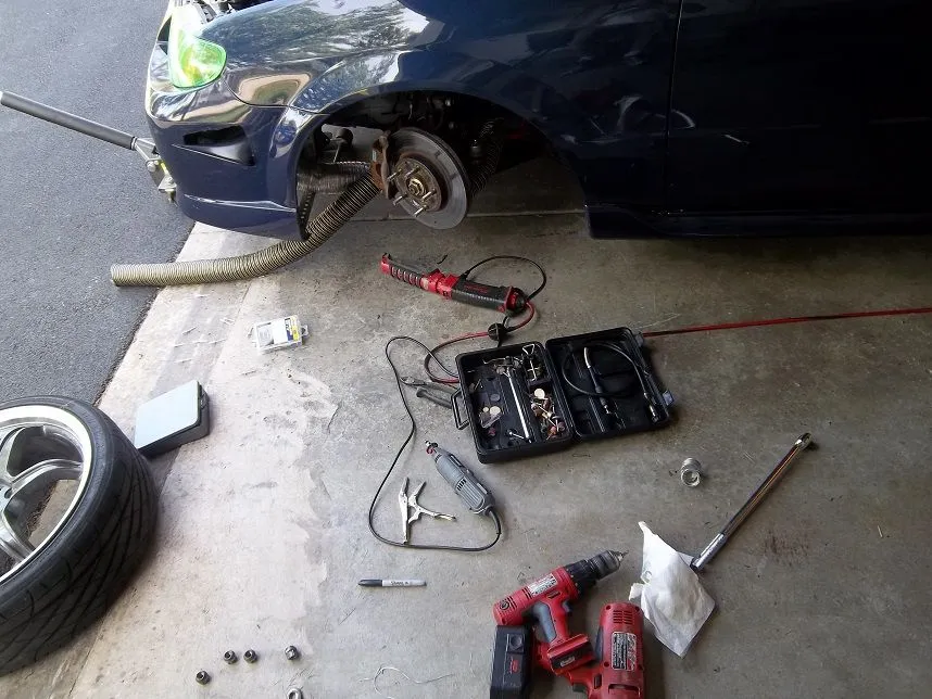

Can't get any more air to these things I think. I know there are air duct coolers/misters, but I don't think I want the hassle of cracking rotors.
attachment.php
attachment.php
attachment.php
attachment.php
