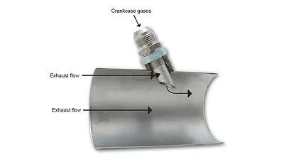

Pcv runs through intake looks like. Still running a maf? That K&N is a narrow tube I had one
attachment.php
If you are looking to change the PCV then look at ProVent products - I'm thinking of using the 200 model.

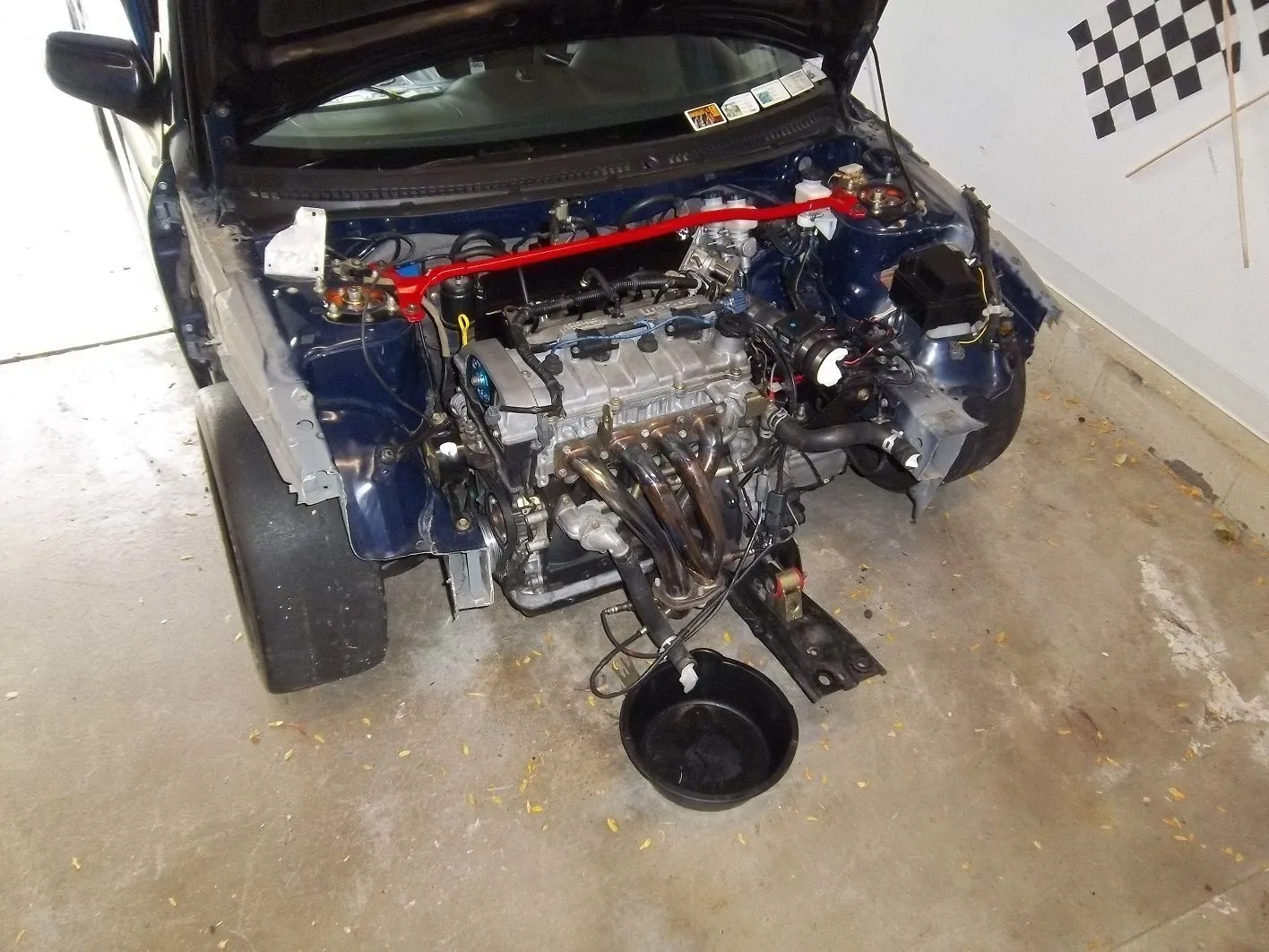

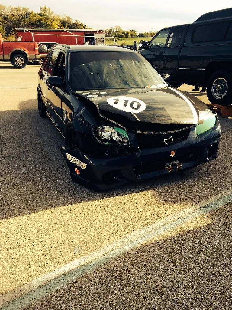

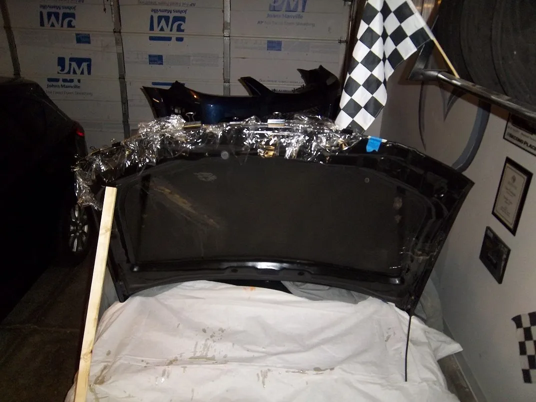

got a back up bumper, will try and save the hood, and got my eye on two fenders from Milwaukee. After that shes good as new.
Was going to tear off all the broken stuff and keep running for the day untill I found the little puddle under the radiator.

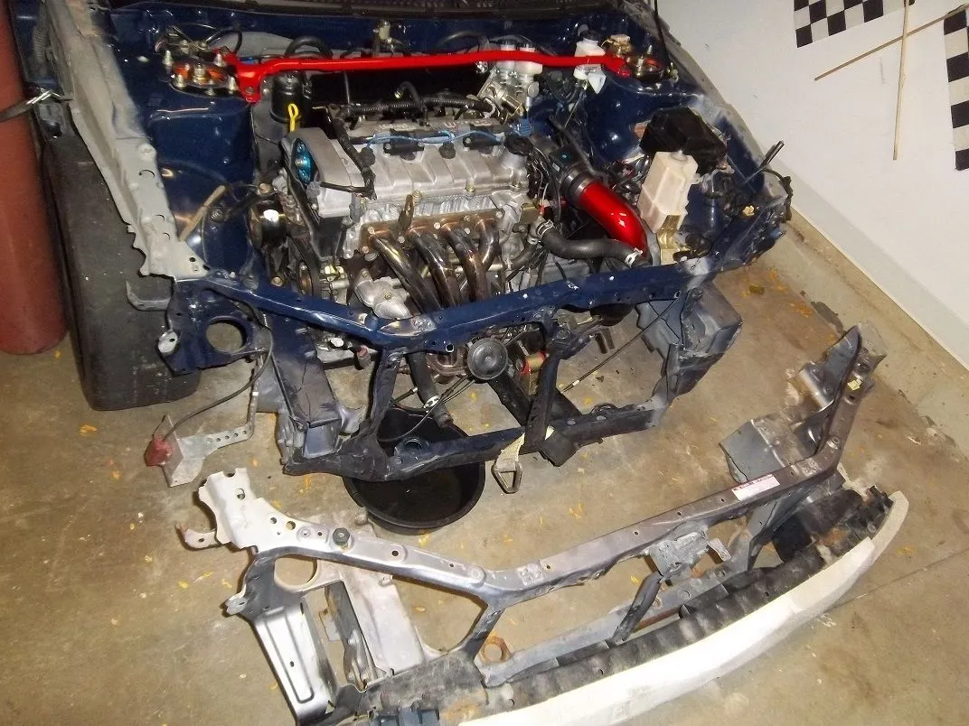

Out with the old!!!
attachment.php

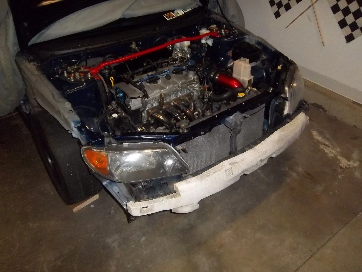

In with the new (now I am 1/24 Mazdaspeed)! Love the speed headlights, but they will most likely be getting covered. Matched the paint with duplicolor. AND this time I am leaving in the bumper support to not have to deal with this again, again. Yes.... again. If you look at the driver side frame rail in the first pic) you can see I have done this before.
