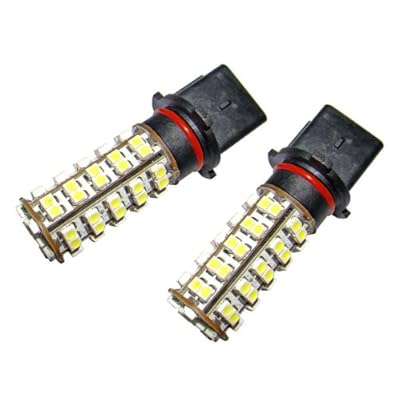

yeah just went back and found it, the one someone posted a lil bit ago from amazon had like more than twice as many emitters on it so i might pick those up hopefully be even more light coming out

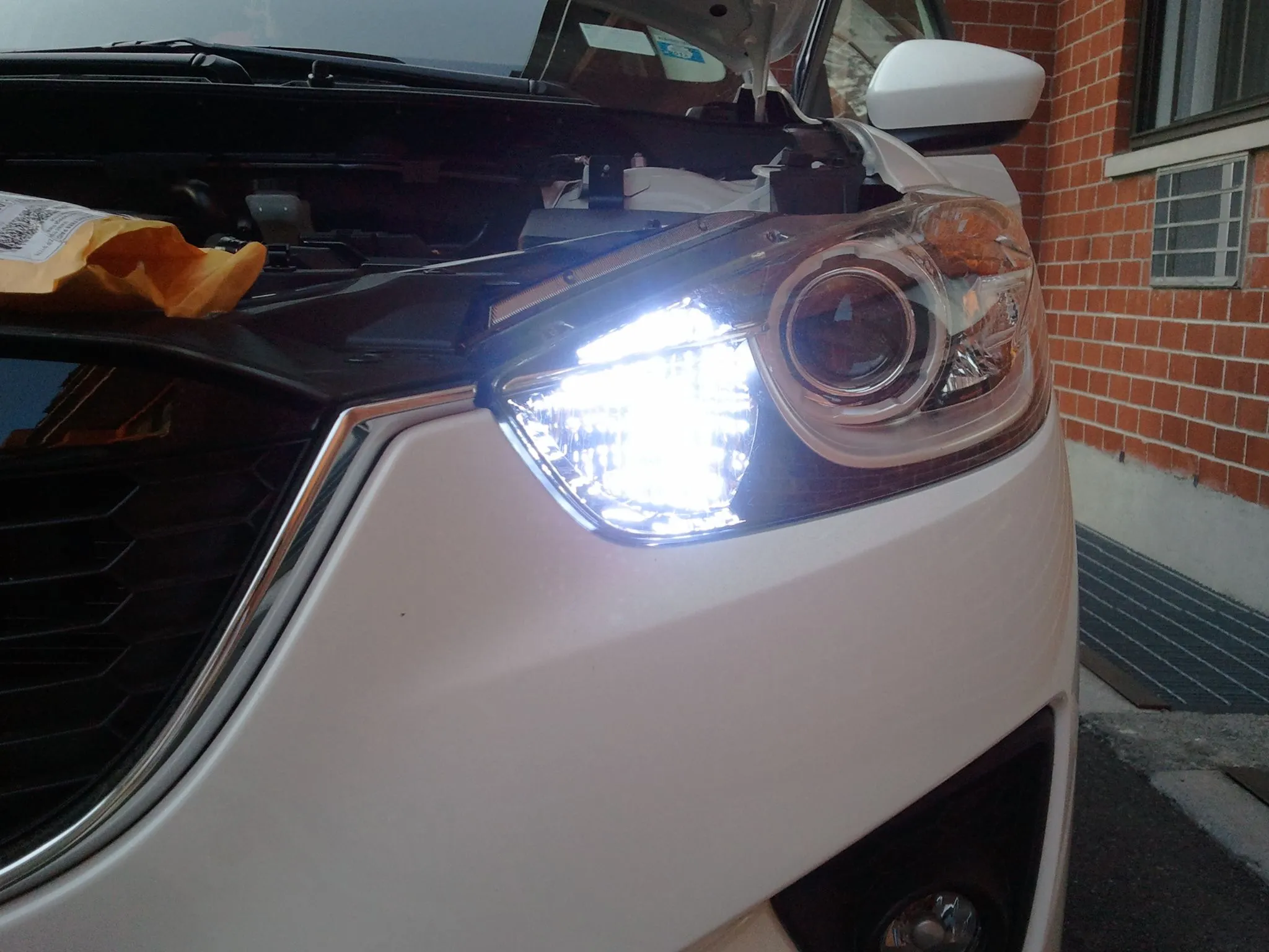

Just a quick question, do these bulbs need a resistor or it's just a simple switch? Is any modification needed?
nope just simple replacement of bulbs. there are two screws that holds the light bulb which is covered by a metal bracket. not too difficult since there is a lot room inside the engine bay.

you had to take screws off? mine just rotated out of position then pulled free of socket...

no i have the xenons, and i remeber a plate with screws on it but that was to attach the light socket to the twisting socket plate, you dont have to unscrew it, just twist the whole assembly and it pops out, then you pull and swap the bulb, reinsert and twist lock it back into place, you made extra work for yourself it sounds like lol

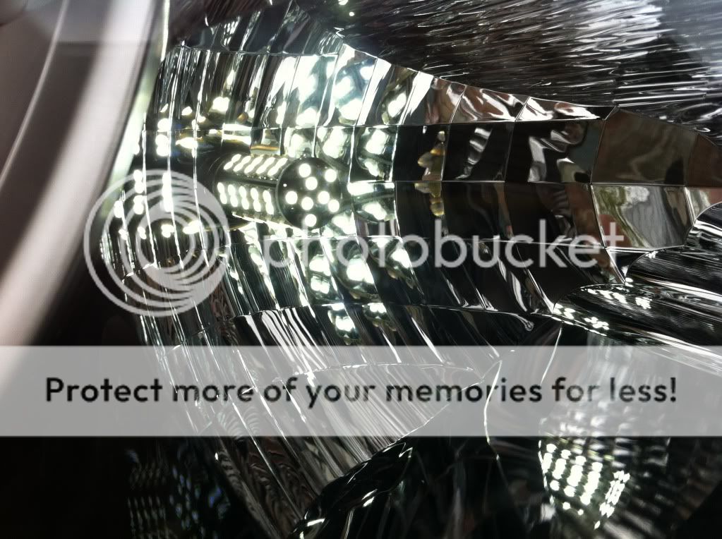

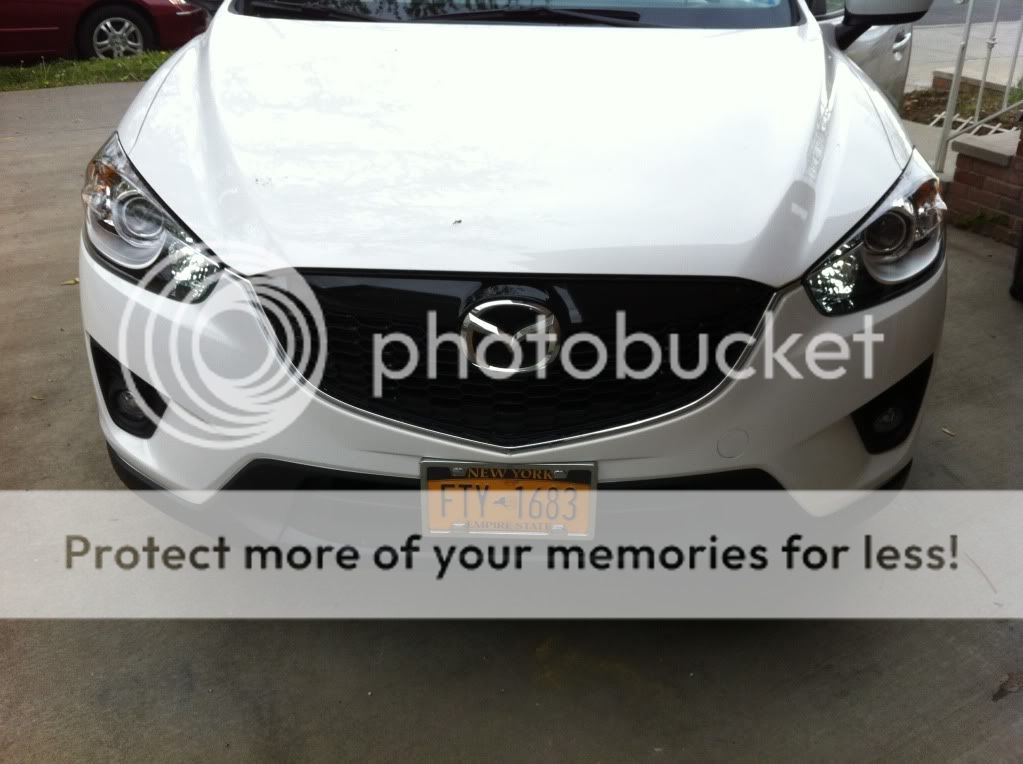

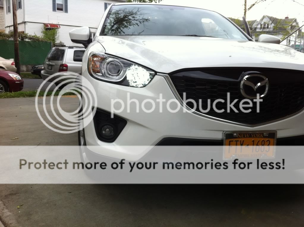

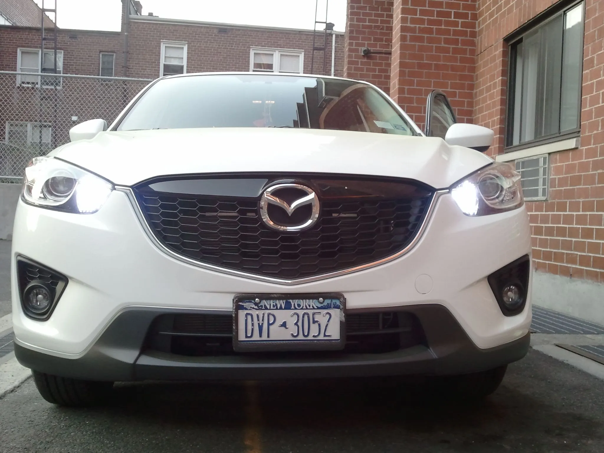

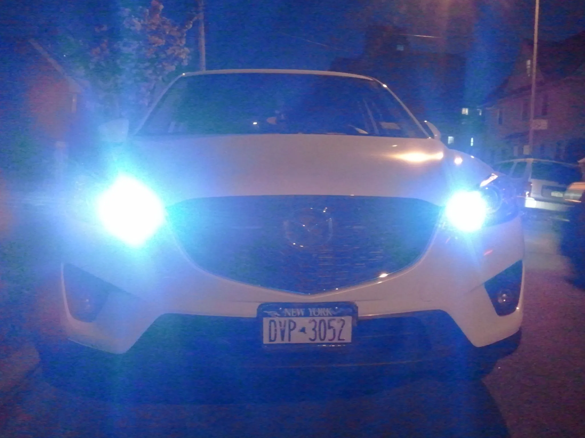

i just got my p13w's today..i installed them... it looks sooo much better then those halogen bulbs... going to get the white fog lights next!
where in ny are you ben? if you're down in the city you should find kimchei and park side by side to see who's leds are brighter lol then i'll know which to buy, the amazon or the jdms (whistle)
i live in queens..i think kimchei lives down the block from me lol... i saw a white cx-5 near my house the other day.. might be his lol... the one i bought from amazon has more emitters but not sure if that makes it brighter...
yeah thats what i was thinking that more smds might put out more light but it almost looks like kimcheis drls are significantly brighter, but unfortunately with the wide variety in camera settings and exposure compensations theres no way to tell for sure without putting them side by side and taking pic of both at same time with one camera
