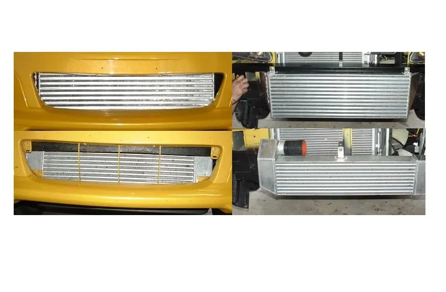

Count the number of fins exposed in the perrin vs how many it has.
I counted 7 out of 12....close to 50%
the begi under it exposes 7 of 10 70%
the gigantic bars on the perrin appear to consume another 50% of what is shown.
both seem to have the same amount of fins that any direct airflow will pass across

daedalus said:
Are you serious
two things.
(1). Have you actually seen how the core is positioned in the bumper? Its not covered by the bumper AT ALL, it simply fits perfect around the opening. The endtanks are covered, thats it.
(2). Have you seen the stock bumper support? Its styrofoam and a big piece of s***. The replacement was much more sturdy than the stocker by far... but what do i know... its not like I OWN ONE OR ANYTHING.
