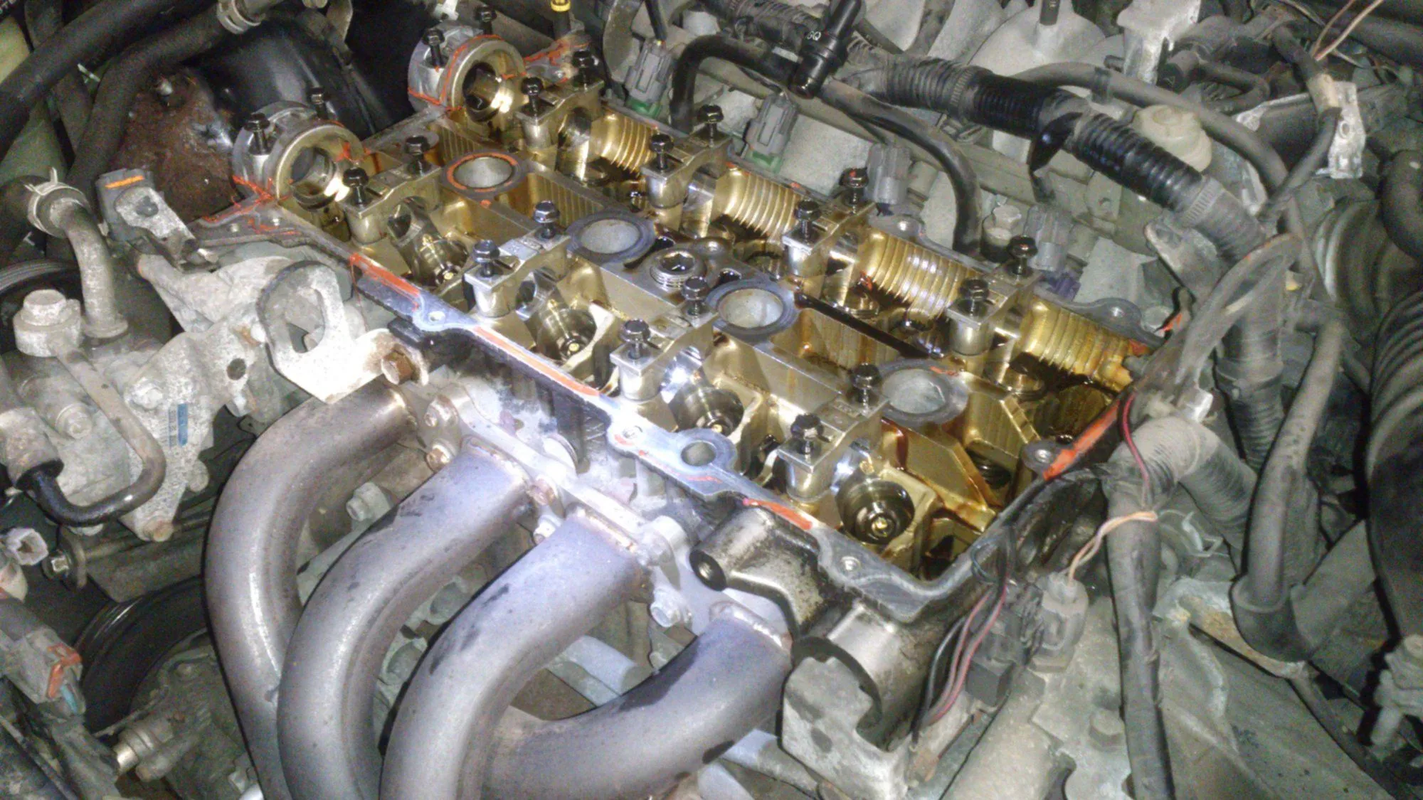

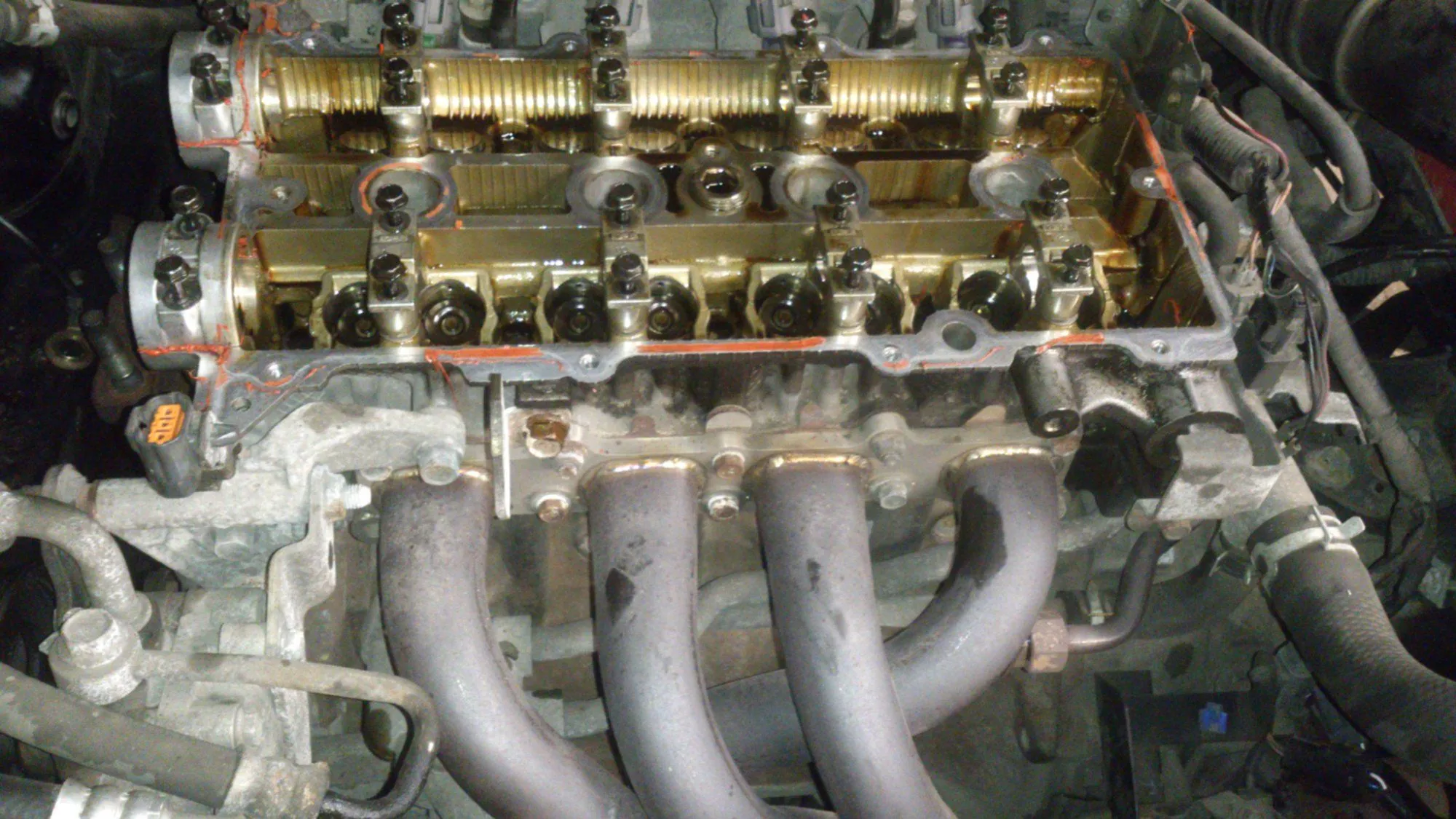

A few more pics of whats up right now.
the cam'less head. I'll get it cleaned up soon, pulling the entire engine for the clutch and flywheel installation
and 1 more

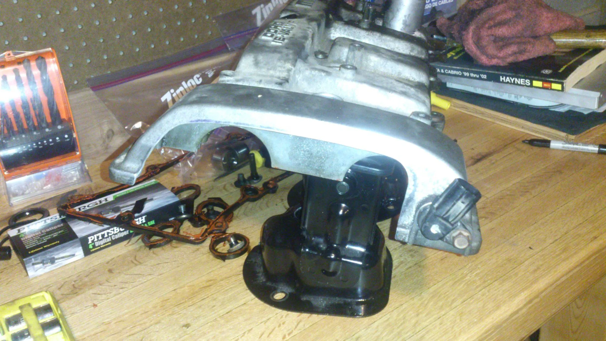

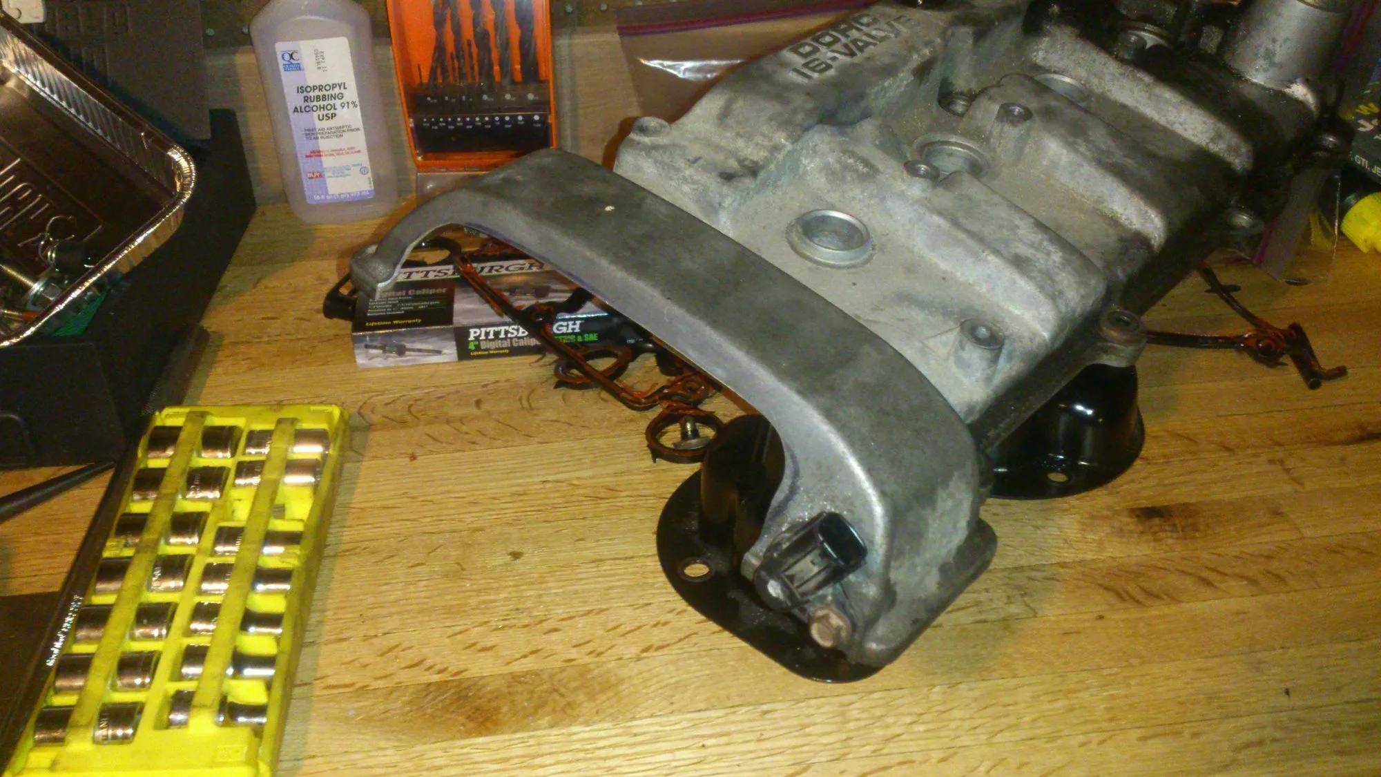

i've pulled that valve cover 4 times in just 10 days haha...the valve cover gasket had NEVER been replaced, and is pretty much dust at this point...surprised it took this long to leak, and even then...it barely let anything out other than a very thin film of oil on the front side...kit includes a water pump too, so i'll get that over with while im in these areas anyway...
2 pics of the valve cover 'window'...you can see the old gasket...in a bunch of pieces that it shouldn't be in...underneath haha...
the cover is standing on my seat belt 'hats' that go on top of the rear strut towers, inside the car...i drilled a 2.5" hole out of those as well, to give access to the damper adjustments for my coil overs...I only need to pop the plastic trim off to access them now...

yeah, kind of sucks that the valve cover is one peice like that...the oil seal doesn't go out to the sprockets, its goes up and over both thrust bearing caps where the cam seals are in place...its just a 'hat' for the sprockets, serves no other purpose other than protecting the top of the sprockets and belt when working around the top of the engine bay...I didn't remove that hat entirely, as you can see from the pics...as i wasn't doing this to make a timing belt change easier (i'll always check valve clearance when replacing the belt, so the cover is coming off anyway), but it will be very easy to adjust the gears with very little effort now...
i've been running the car for over 100,000 miles without that passenger side splash shield in place, too...crank pulley (which i just replaced with a udp late last year) was in perfect shape, and everything inside that cover looks brand new...so i'm not too worried about anything other than debris (misc bolts, nuts, etc) falling in the belt area...i'll have to be very careful about that when doing any work in that location...
I'm probably just going to leave the window opened...i'm in there regularly, and that location seems to get very little moisture or anything...even when driving in down pours...
